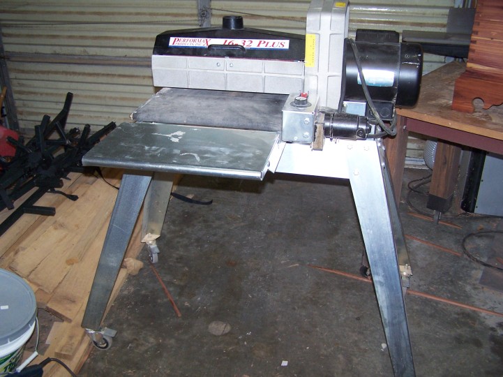

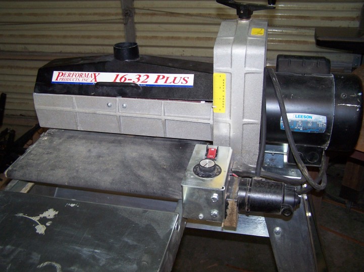

October 3, 201016 yr comment_52818 Made a road trip today over to Chickamauga, GA to pick up a 16-32 Drum sander I found on Craig's list.It is an older model Performax but is in very good shape. Looking forward to putting this to work in the shop. The footprint was a little bigger than I was expecting and this 24x32 shop is getting full fast.Any ideas on where to get the best deal on sandpaper for the drum? Where do any of you get yours? Got to do a little cleanup on the infeed and outfeed tables. Other than that it looks like it has been taken pretty good care of. Report
