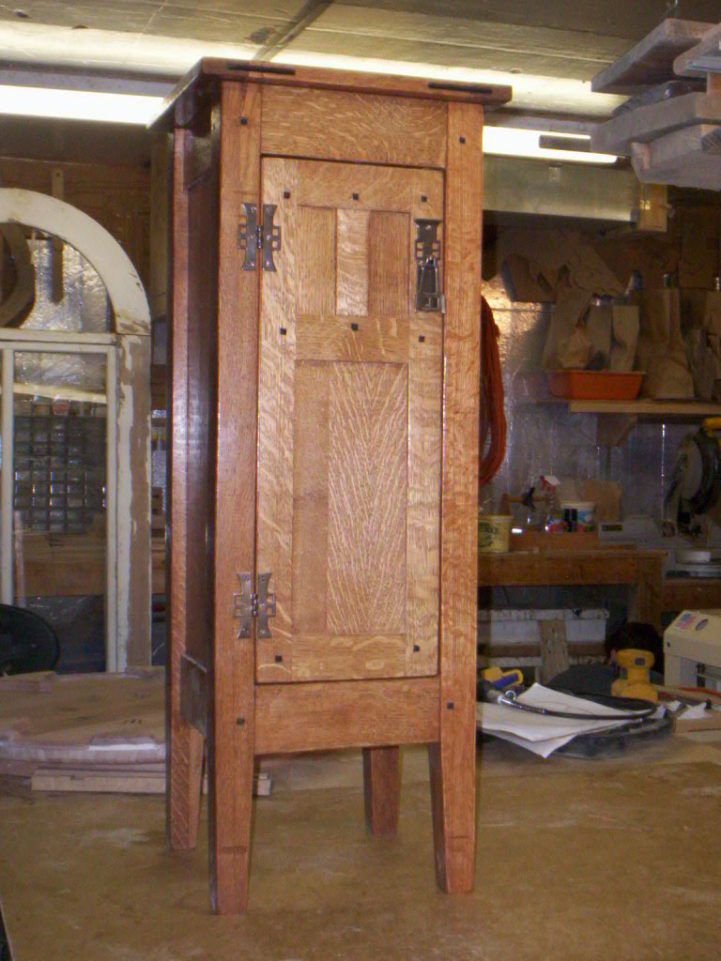

December 11, 201015 yr comment_51277 Hello John, Here is the solution for you. Simply take some walnut and soak them in black liquid shoe polish and then let them dry a few days and you will have a poor man's Ebony as seen in the two pictures I am about to post. Report

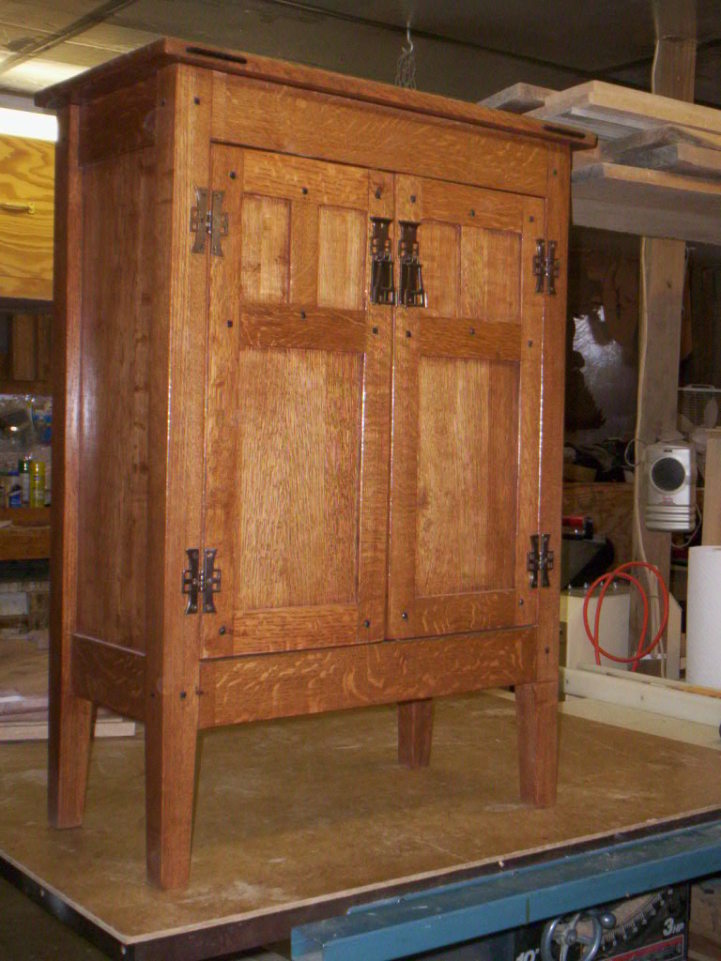

December 11, 201015 yr comment_51276 Now here is the second one; Ralph Allen Jones said: Hello John, Here is the solution for you. Simply take some walnut and soak them in black liquid shoe polish and then let them dry a few days and you will have a poor man's Ebony as seen in the two pictures I am about to post. Report
December 11, 201015 yr comment_51275 How deep will the black color go into the wood? Ralph Allen Jones said: Now here is the second one; Ralph Allen Jones said: Report
December 11, 201015 yr comment_51274   Hi Richard, It penetrates all the way through if you are usine 1/4" stock.  Ralph   Ralph Allen Jones said: Now here is the second one; Ralph Allen Jones said: Report
December 11, 201015 yr Author comment_51273 Thanks guys, those dyeing procedures are very interesting, that could have been a cool topic for our finishing forum! Those are some great ideas and I wish I could use them in this project but I can't see soaking strips of 2" wide by 50" long pieces of wood, then inserting them in between layers of lams and then after all is said is done, I take the power carver and grinders and take off in some case an inch of material and then expect a nice even tone or color to show up underneath. That is a really big gamble for this project. It takes a lot of work to get those rockers glued up and bent, then the rockers are assembled on the almost finished chair before the rockers are shaped to final curves. Man, that would be a lot of work to do just to find out the colored dye didn't soak all the way through. I could definitely see doing this in projects like Ralphs where the dyed wood is used in plugs and smaller accent pieces, those are wonderful suggestions. But my gut is telling me this is a bad idea for my application. If I am completely wrong, I hope for some more enlightenment. I am here to learn as well! Report
December 11, 201015 yr comment_51272  John,Before you apply the wood to your piece take a sample of the same wood you are using and drop in into the dye or shoe polish over night and then let it dry. Then find out for sure it has completely penetrated cut one in half. Ralph   The American Woodworker said:Thanks guys, those dyeing procedures are very interesting, that could have been a cool topic for our finishing forum! Those are some great ideas and I wish I could use them in this project but I can't see soaking strips of 2" wide by 50" long pieces of wood, then inserting them in between layers of lams and then after all is said is done, I take the power carver and grinders and take off in some case an inch of material and then expect a nice even tone or color to show up underneath. That is a really big gamble for this project. It takes a lot of work to get those rockers glued up and bent, then the rockers are assembled on the almost finished chair before the rockers are shaped to final curves. Man, that would be a lot of work to do just to find out the colored dye didn't soak all the way through. I could definitely see doing this in projects like Ralphs where the dyed wood is used in plugs and smaller accent pieces, those are wonderful suggestions. But my gut is telling me this is a bad idea for my application. If I am completely wrong, I hope for some more enlightenment. I am here to learn as well! Report

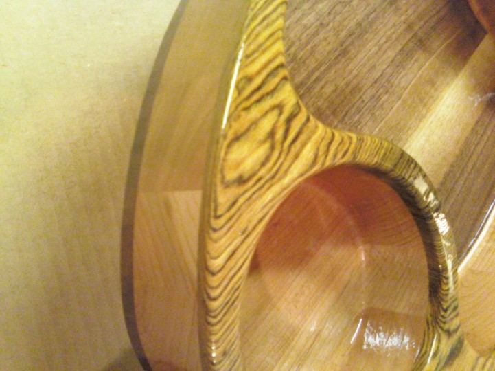

December 12, 201015 yr comment_51270 how about a different wood then?maybe mohogany, or even some other exotic like Bacote' Report
December 12, 201015 yr Author comment_51269 That's what I was looking for John! Some great ideas on a darker accent wood too! So Bacote? I'll have to do a search and see how that looks. Thanks man.John Hechel said:how about a different wood then?maybe mohogany, or even some other exotic like Bacote' Report
December 12, 201015 yr comment_51268 the top piece here is Bacote, it's black and gold colored. Report
