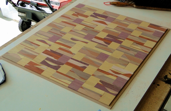

March 3, 201115 yr Author comment_49014 Here it is, composed of Yellow Hart, Purple Hart, Bloodwood, Cherry, Oak, and so on. All scrap material, all glued together over a long period. It was going to be a table, but my daughter wanted me to make a wall hanger out of it. I will put a Purple Hart border on it with a slot to allow for expansion. It has no finish on it now, but I am sure the colors will pop when I do apply some. Report
March 3, 201115 yr comment_49013 First thing that comes to mind is...hold on...WOWA! You have various woods with different characteristics. I don't work with the exotics, but I have read possibly some of those woods color can bleed into the others depending on the type of finish used. I'm not sure of the approach to take here. Hope others can jump in, maybe you have figured your finish schedule out already? Very beautiful work, perhaps a close-up of the issues that are of a concern? Report
