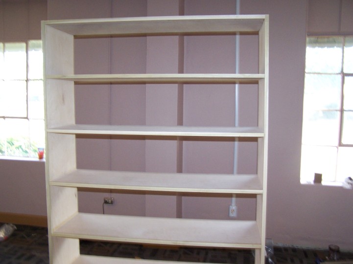

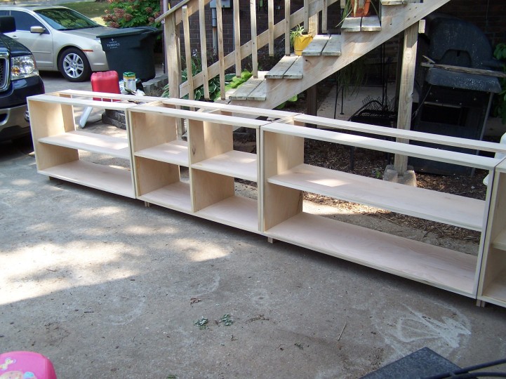

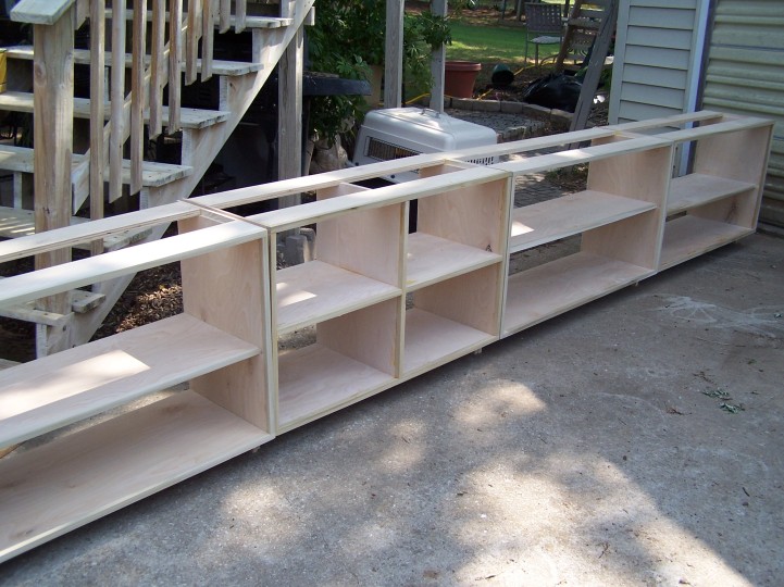

Well we did finally get some decent ply and I have been working on this along with my son for several weeks between so many other projects. I thought I would give you a peek at where we are. I am really under the gun as they are to be delivered either Wednesday or Thursday of next week. Today we have been getting all of the poplar edge banding sanded and going over the ply just lightly to knock off the fuzz. I don't have the backs in them as I am going to finish them and then install. Makes it easier to to the sides and shelves without bumping into the back.
So I just sat them outside my shop for a picture. No room to sit them side by side in the shop.
ning-100-3908-47000-35.jpg?width=721ning-100-3909-47000-18.jpg?width=721
ning-100-3920-47000-18.jpg?width=721
They are 16' from end to end. The drive is not flat and level so there are some gaps showing. This was just to sit them out and post an update.

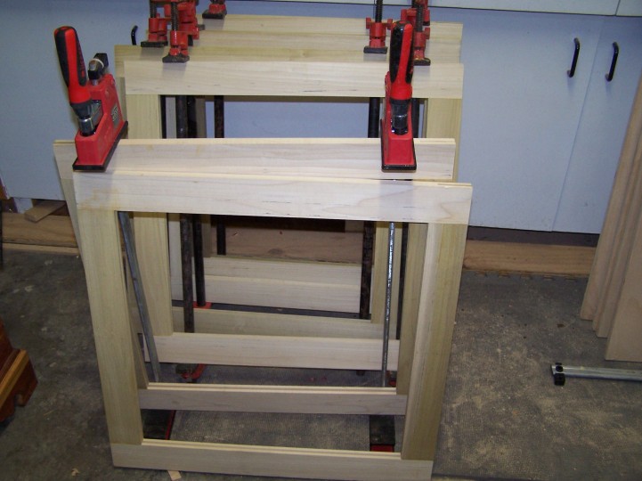

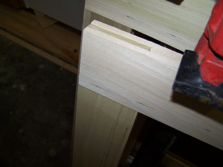

Got all of the door parts planed, cut to size and the rabbit for the glass cut. Started working on the bridle joints tonight. Got to finish them and get them glued up tomorrow. Got stain on part of the cabinets. Going to be a marathon to get finished.
John Moody
John Moody Woodworks

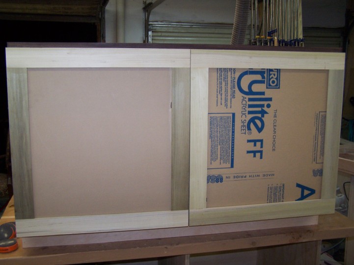

Doors are all glued and in the clamps. The glass is suppose to be in tomorrow so I can get it mounted.
ning-100-3910-46994-87.jpg?width=721
ning-100-3911-46994-99.jpg?width=721I did a bridle joint on the corners to help hold them as square as possible and not sag. Each door is about 25"x 25" and will have a 1/4" white frosted plexi-glass. They didn't make the finial decision on the glass until yesterday so hopefully it will be in today so I can finish those tonight. They actually wanted delivery today, but that didn't work out.

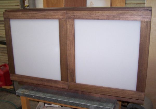

Okay this afternoon has been really busy. I got all of the doors made, rabbited for the glass, hinges all installed and the backs in the all of the cabinets.
Just need to sand the doors and get them stained and the toe kick piece stained.
Everything is done except the bookcase for the end cabinet and the counter tops. Looks like I am going to miss the deadline. Part of it was their problem. Didn't get the plexi till today. Didn't get the hinge selection till yesterday. So I have a little more work and it will be done and hopefully delivered by the weekend.

They went with a white of frosted plexi. I left the paper on until I get it all sanded and stained then I will take it off and mount it in the doors.

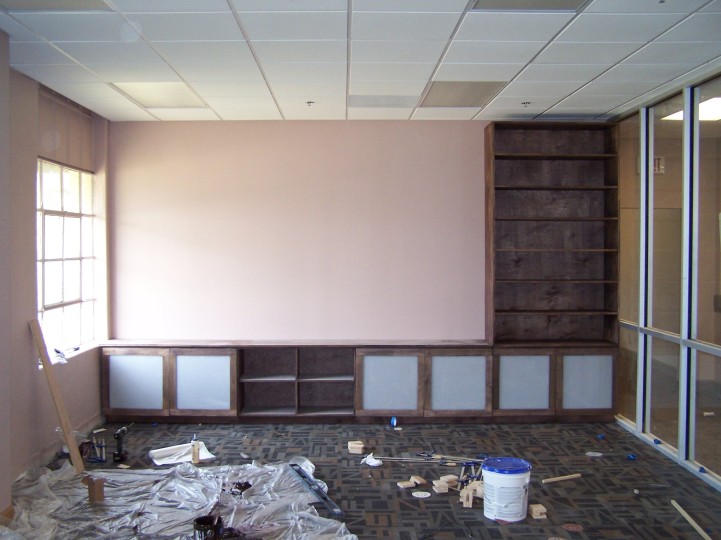

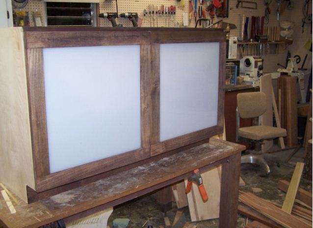

Okay so I got the plexi installed in the doors and we are about to wrap this up and get them shipped out.
ning-maxellcabinetsintheshop-46990-36.jp
ning-maxellcabinetsintheshop2-46990-9.jp
As you saw in an earlier post there is an open lower book case and I didn't take a picture before they left with them but there is also an upper book case.
Will post a picture as soon as they send me some of them installed in the place they were going. I sure hope they fit since someone else took all of the measurements and I have never been where they are going.

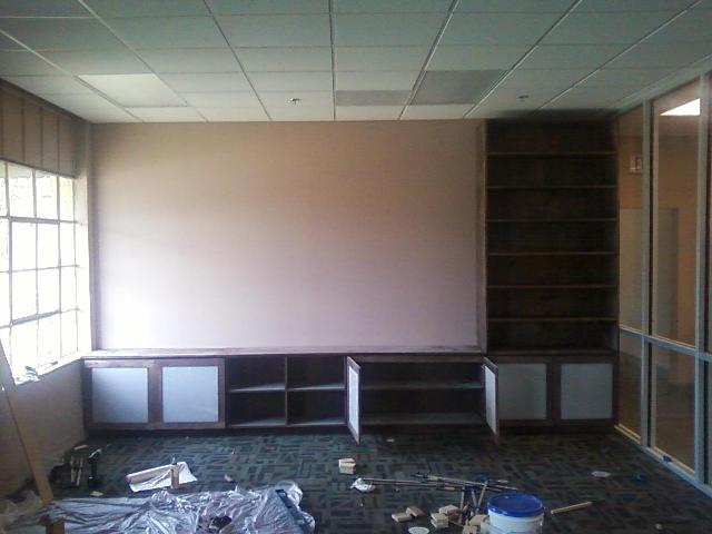

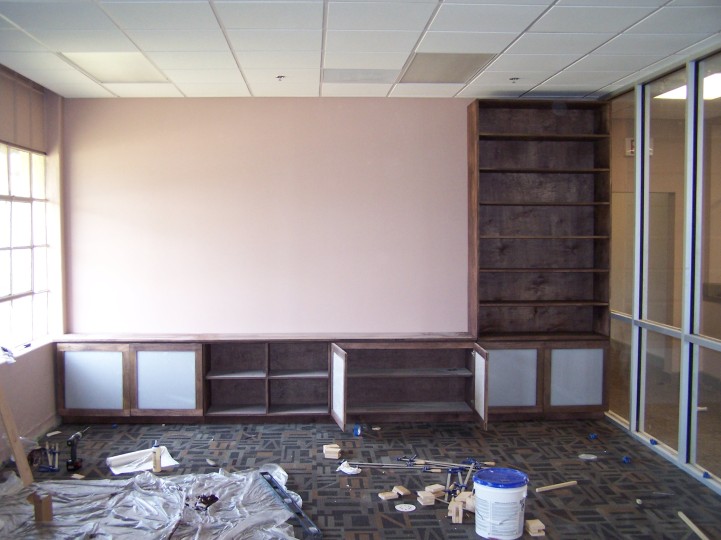

Well I got one picture today of the cabinets installed. I understand all they like is putting the poly on them. There were going to do that on site after installation in case anything had to be touched up in transporting them.
ning-100-3922-46989-59.jpg?width=721ning-100-3924-46989-6.jpg?width=721
The contractor is going to install the hardware on the doors. It is something they are using in some other areas so they already had them.
They will get polyed and have a new home.
