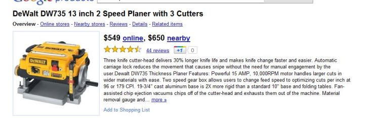

Dan this is one that gets really good reviews.
ning-dewalt-44421-79.jpg?width=721I am looking at a 15" planer, but if I have to back up and not get it this is one I will give a good look at.
