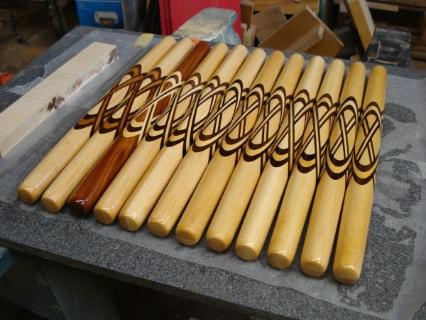

Just applied the third coating of mineral oil to this batch of rolling pins. 9 of these are Maple and Walnut. 2 are Maple, Walnut and Cherry. 1 is Sapele, Walnut and Maple.ning-dsc01791600x450-43482-37.jpg?width=

I'm with Brian.  Just send me the three on the left.  BTW, what diameter are they Lew?

About 1 9/16" in the center and about 1 1/4" at the ends

Looks like a classic french-style tapered. Great for pastry dough.
Is the finish entirely mineral oil, or is there some wax too?
Just mineral oil, about 3 applications at first then as needed when the surface feels a little "dry". Mimi says that dough doesn't stick at all.

I made a practice one out of a pine dowel. The biggest trouble I had was keeping the taper smooth along the length, especially since I only have a 6" tool rest.
I had posted a blog here at one time on making these including how to make a jig to get the taper correct.  think it must have gotten deleted, as I have been unable to pull it up. Anyway, you can make a template, from a piece on plywood/Masonite, that has the taper you want. I used a thin (1/8")  x 1" wide and about 24" long straight grained cutoff to create/trace the arc on a piece of  1/4" plywood. Then cut/sanded the arc to create the template. Then it was just a matter of turning the diameters at the center and both ends. Then slowly turning away the material between the diameter cuts checking the progress with the template. Later I made a duplicating jig/assembly so I could produce them quicker.

A template. That thought hadn't occurred to me I guess (mostly because there's not much need on pens).
If you make a template, mark the center (thickest pin section) and the overall pin length at each end. The center mark aligns the template with the knot crossing center and the length helps determine the layout length.

Heh, I thought my lathe would determine the lengthGrin.gif.
Thanks for the tip though. I'll definitely make one when I try again.
