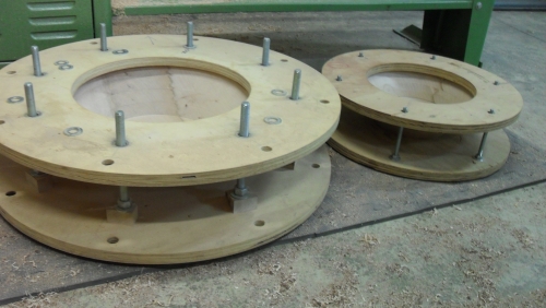

August 22, 201115 yr comment_41798 I checked out your link to the segmented bowl construction. One thing you and your husband may want to design and build is some sort of a glue press. In the link, there were several methods for clamping/pressing.  A single, dedicated press would really simplify things. LewSQ said:Thanks for the link to the plans.  Really appreciate it.  I was wondering if I needed those washers.  I have seen them advertised.  I will get some tomorrow.  I don't want to have any removal issues. Thank you so much for suggesting it. Really appreciate all your help. SQ   Lewis Kauffman said: Report
August 23, 201115 yr Author comment_41797  I will have to check out that link again and check out what he was using for a bowl press.  I was so mesmerized by the bowl, I can't remember anything about his press.  lol  I agree, a bowl press is essential for segmented bowl making.  I built these bowl presses when I first started making the scroll saw bowls. The smaller press will  hold up to a 13 inch bowl.  The larger bowl press will hold a 17" bowl when bolts are placed in the inside holes, and will hold a 21 1/2 inch bowl when the bolts are placed on the outside. ( I made one bowl that was 19 inches in diameter. ) It would be very difficult to glue the bowls without gaps if I wasn't using these presses.  I cut a circle in the tops so I could see if there was any unwanted movement when pressing.  I use nuts on the bigger press, and wing nuts on the smaller press to compress the top.  This bowl press idea came from Carole Rothman's book on scroll saw bowls.  I just super-sized them and added a viewing window.   SQ   Lewis Kauffman said: I checked out your link to the segmented bowl construction. One thing you and your husband may want to design and build is some sort of a glue press. In the link, there were several methods for clamping/pressing.  A single, dedicated press would really simplify things. LewSQ said: Report
