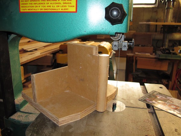

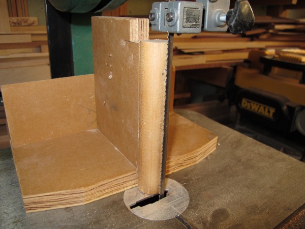

August 20, 201115 yr comment_41676 Charles, No need to buy a new fence. I was just using that as an example because I was having difficulty describing what the thing looks like. It is very easy to make your own single point fence. It doesn't have to be elaborate or fancy. Here are 2 pix of mine: I made mine as tall as possible to be able to resaw up to about 6"- the max my saw could handle. If you are cutting pen blanks, the fence would not have to be nearly this tall. I split a 3/4" dowel to create the pivot point. That can be done with a triangular piece of wood glued onto the vertical portion of the fence. I just clamp it to the band saw table with a couple of C-clamps and adjust it with a hammer. I agree with other posts- the blade probably needs replaced because it is dull. I've seen videos on how to re-sharpen band saw blades but honestly, I think you'd be better off with a new one. Looks like these are about $10. at Sears. Hope this helps. LewCharles Nicholls said: That's exactly whats going on Lew. Basically the first thing I need to do is see if I can find a fence for that model of saw, so that then I can find a piece like this here to attach to it. But for now, with the adjustments made last night, at least it's usable. Whereas before, you had almost a 45* turn within the first three inches. I did notice one thing last night when making the final cut of the evening, the blade was actually tilted during the cut at nearly 45* Report

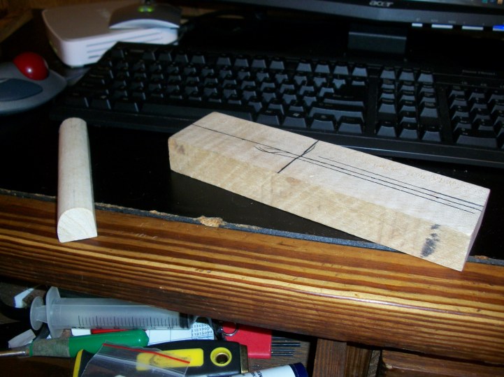

August 21, 201115 yr comment_41674 If you some Tightbond II or III, that would be best. If not, then super glue would be my next choice. Screws, from the back will also work- you don't want the heads of the screws on the front - they would cause unnecessary friction.Charles Nicholls said: One more question Lew, What glue did you use to attach the dowel to the fence? I have some pen glue here or I could use screws I guess to attach it. Â I forgot that I had some rounded Ash stock that I got from a pen blank supplier, heres what I had in mind. The marked piece is what I originally was using as a fence. Â Report
August 21, 201115 yr comment_41673 Maybe super glue and a couple of screws. I have been thru several versions of this jig before finally getting one I like. Maybe a quick build just to see if it is going to solve the problem. If you find it works, then a more elaborate, permanent build.Charles Nicholls said:Ok thanks Lew. I'm hoping that the super glue (CA glue) I have will work, otherwise i'll either have to get a smaller piece of wood for the fence or about 5" screws to hold it all together. Report
