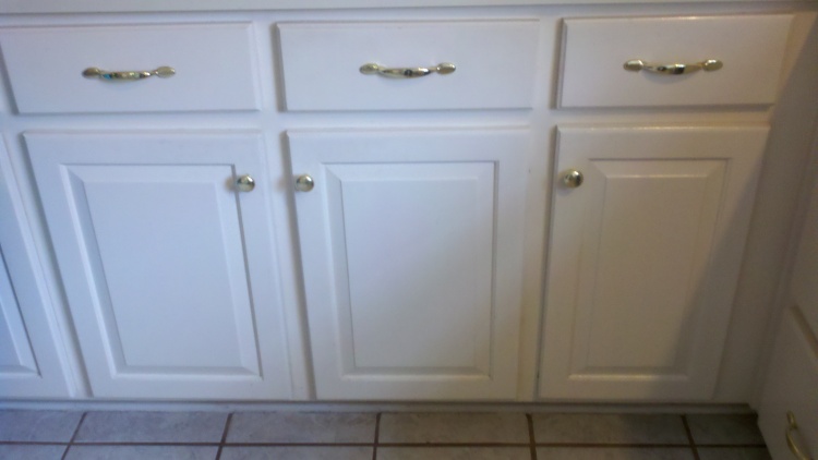

September 27, 201115 yr comment_40269 I need to make two doors to match these in the picture. They are obviously raised panel. The distance from the rail to the inside edge of the panel is 1 1/4". Would these be easier to cut with the table saw or with a router bit? Â They are not cove but straight with a small lip at the top. Â John MoodyJohn Moody Woodworkshttp://www.johnmoodywoodworks.com Report

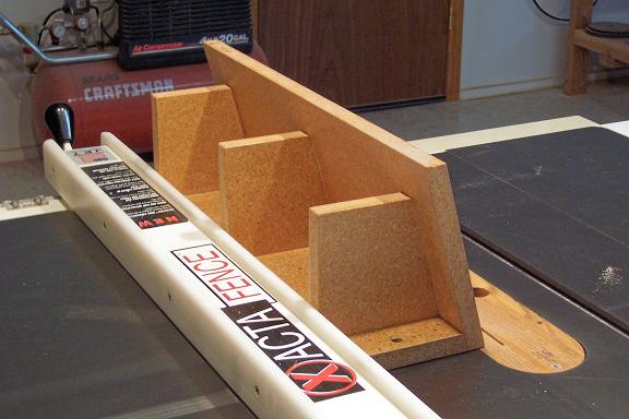

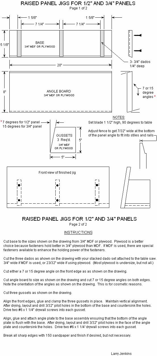

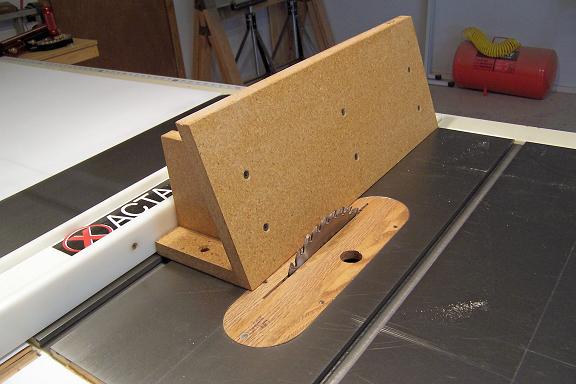

September 28, 201115 yr comment_40281 John2 and others.. Here's the images for the panel jig and design drawing per your request. WOOD featured it a couple months ago. Larry        Report
September 28, 201115 yr comment_40280 LarryNice job. Like the way you laid it out. Quite different from the one I built, mine saddled the fence and held the panel locked in. It depended on the tilt of the saw blade. Wayne MahlerGod bless and protect our troops that serve so we can be free. Report
