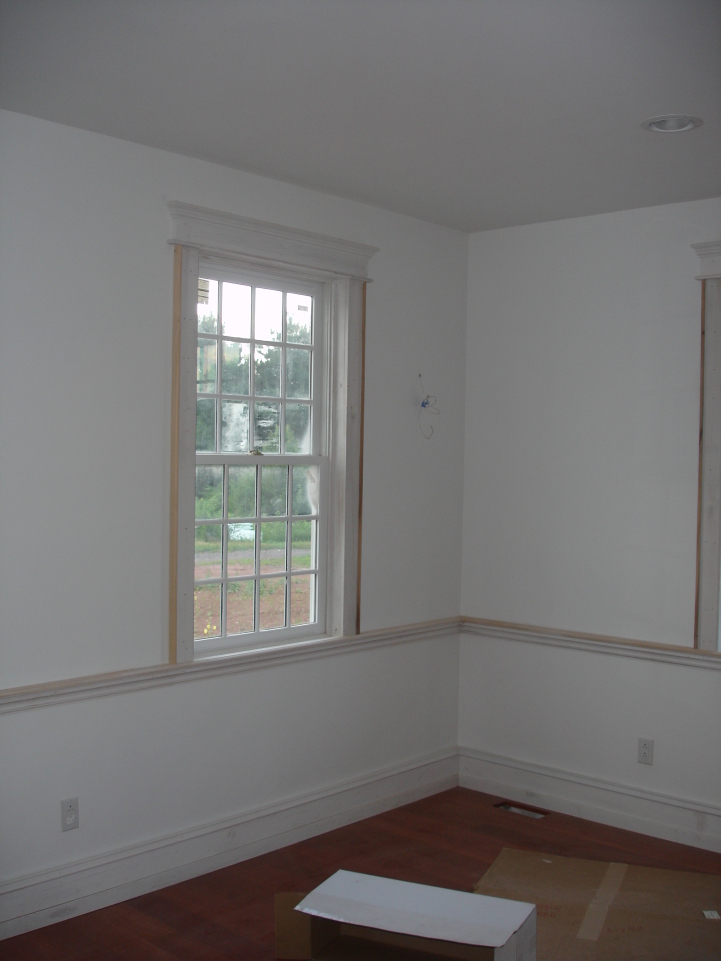

November 8, 201115 yr comment_38815 Darcy, Â Â Â Â Â Â Â Â Â Â Â The 4" moulder has a lot of capabilities. You just need to be creative. I used a Wadkin FD 4x4 moulder to run all of the trim for my house. I have 12" baseboard mouldings which I made in three parts. Here's a photo of the trim work as it was being installed. All of the window heads, casing, char rail were made on the 4" moulder. Â -Arthur Report
November 10, 201115 yr comment_38814 nice work . How many lbs this year Arthur? and could you divide by oceans  the tonnage.  jack English machines Report
