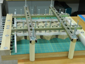

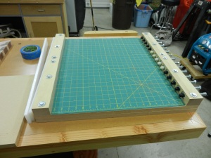

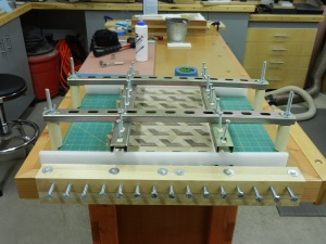

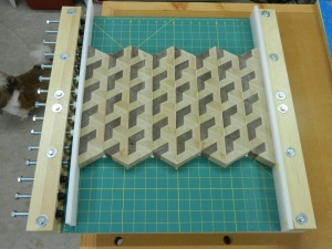

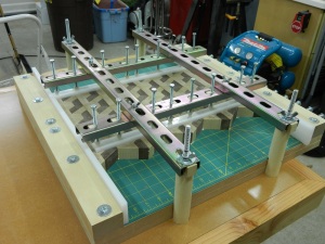

January 13, 201214 yr Author comment_36089   I've been a bit delayed in the final stages of the board. I had 4 days of medical appointments so I wasn't able to glue up the final assembly. I built a clamping board using the same principle as the triangle jig I showed earlier. It's 24" X 24" made of MDF with 2 pieces laminated for the base and the straight edge and bolt cawl made from material salvaged from an old piano. All wood surfaces that may come in contact with glue are covered in packing tape. I also used 2 pieces of 3/8" thick plastic cutting board and a fabrick cutting mat donated by the wife. The mat and plastic material are great because glue wont stick to their surfaces. I also built a vertical clamping system to keep the glue up flat. I used UNI-STRUT cut into sections with small wood blocks and "T" nuts with 1/4" bolts and nylon acorn nuts. This rig is attached to my work bench through the dog holes on the bench. It works pretty well. I welcome all comments, questions and ideas. Thanks for viewing. I hope to run it through the drum sander tomorrow morning.   Report

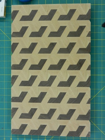

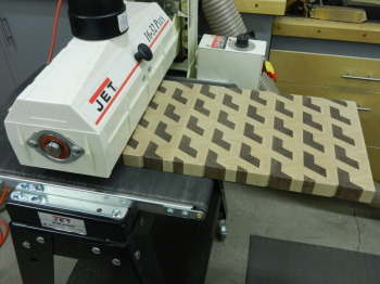

January 14, 201214 yr Author comment_36086 Down the home stretch. I've trimmed the board close to the final dimension, run it through the drum sander 80 and then 100 grit then sanded 120, 150 grit with RO sander. I'll route the edges to 30 deg and apply the first coat of oil tomorrow.  http://thepatriotwoodworker.com/forums/uploads/ning-dscn0061-36086-75.jpg Report
January 15, 201214 yr comment_36085 Awesome looking Mike. Very fine job on all aspects of this project.John MoodyJohn Moody Woodworkshttp://www.johnmoodywoodworks.com Report
