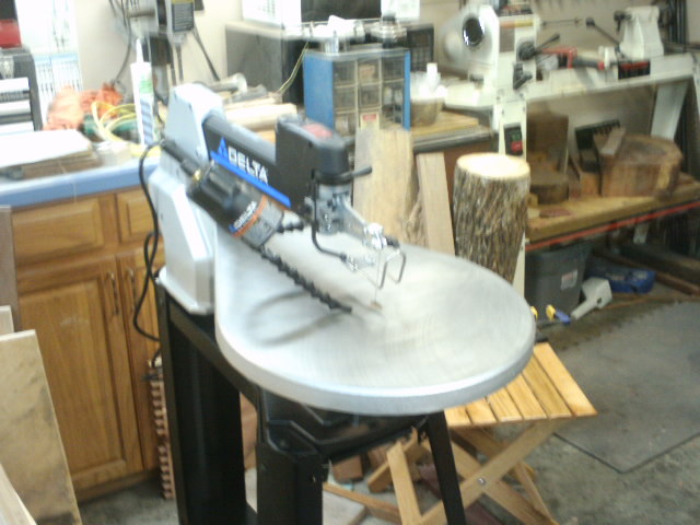

Using all of the new resources at hand, I was able to keep up with my new Delta Scroll Saw and saw it delivered at the house at 11:00 am yesterday. Got it moved from the outside to the shop quickly and then had to wait until I got home last night to dig into the box.
ning-imag0023-34451-37.jpgNow I just have to figure out what to do.

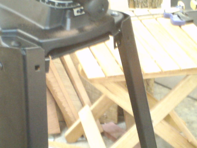

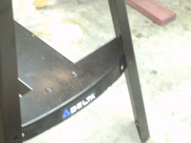

I was not at all impressed with the stand that comes with it. It seems very flimsy. Two of the bolts at the top and two at the bottom on the frame don't line up at all. Almost like they sent the wrong legs.
ning-imag0026-34451-8.jpgI know the picture is not that good, but those holes are not even close. The whole leg would have to be bent further around.
ning-imag0027-34451-2.jpgAnd the top is the same way. It might not be so flimsy if you could put the bolts in those.
I will probably look at either mounting it when I use it to the work bench or come up with a better stand. This one is also tall enough that you would have stand or be on a taller stool.

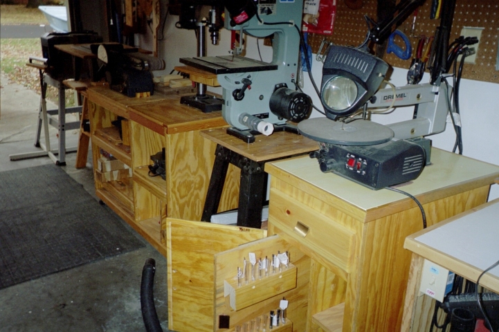

Congratulation John on your new toy.  From the picture you have a lamp but I did not see a magnifier glass.  Your eyes maybe better than mine.  I'm with John Morris on a rolling cabinet not only for the saw but also in storing all the different blades you'll end up with.  You could build the cabinet to any height that you would be comfortable in working.  I'll sit in shop stool most of the time I'm sawing on mine.  Here a picture of mine.  Not too good picture but maybe it would give you some ideas.

I think I tried it in both sides, but before I do that Mike I am going to take it apart and try them on the other side. I believe I try it that way just as a dry fit and it didn't match either but I am going to make sure I do that. It is possible I have them wrong. The picture shows the legs with two creases in them and these only have one.

John did you try putting the tops of the legs into the inside corners instead of the outside?

Okay I am a little red faced. I changed the legs out and with a little persuasion they fit now. It did tighten the stand up a bit, but to me it still has a little too much movement in it. They recommend younto mount it to the floor, but I have no idea where I am going to keep it somi can't do that at least right now.
