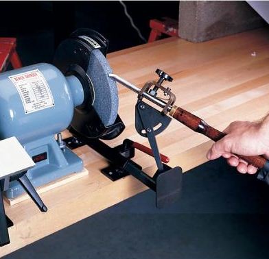

February 14, 201214 yr comment_34057 Charles, you might want to look at adding this jig to your grinder as soon as you can. It will certainly help to maintain the angles on the gouges. It is not necessary to have this to sharpen, but it sure helps. Then you can add this attachment to make the fingernail and side grind consistent.John MoodyJohn Moody Woodworkshttp://www.johnmoodywoodworks.com Report
February 14, 201214 yr comment_34056 No they are really the same thing Charles. The Vari-Grind 2 has a base that goes with it. The other one I was showing you will sit in the base that comes with the jig. The Wolverine jig has the piece that is under the grinder wheel. The piece that is holding the gouge is the extra piece. It sits in the jig and you can rotate it around to get the fingernail grind or the side grind. John MoodyJohn Moody Woodworkshttp://www.johnmoodywoodworks.com Report

February 16, 201214 yr comment_34042 Charles, one thing I did when I first started sharping my chisels to make sure I kept the angle the same was I took a permanent marker and colored in the entire bevel. I put the tool in the jig, and the bevel against the wheel and adjusted the jig until the bevel looked to be touching the wheel from top to bottom. I would then jog the switch to get the wheel to turn and touch the bevel against it. It would remove the black marker and I could see if I was consistent from top to bottom of the bevel. If it wasn't then I moved in or out to the it correct and repeated the above process. Once I had the entire bevel against the wheel I would then turn on the grinder and sharpen the chisel keeping it moving and not pressing against the wheel. You don't want to leave it in one spot and get the tool hot and discolor the metal. Since you don't have the jig you can do pretty much the same thing using the rest that is in front of the wheel. Lay the chisel on the rest with the bevel against the wheel and adjust the tilt until the entire bevel is against the wheel. Use the permanent marker, it really helps to see what you are doing. Also run the grinder on the slowest speed which is probably around 1750 rpms.I hope that helps.John MoodyJohn Moody Woodworkshttp://www.johnmoodywoodworks.com Report
