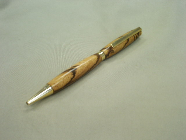

March 6, 201214 yr comment_32847 Charles, how much glue are you putting on the paper towel? This is a Zebra Wood pen I turned last week and was finished with blo/ca. It has six coats of blo/ca. I put a drop of BLO on the paper towel and then several drops of CA. I put the paper towel under the pen and slide it down the pen until the CA is off the towel and on the pen. I then fold the paper towel around the pen and move it back and forth up the blank holding it fairly tight so I so I can feel the heat. The heat is what sets the CA. I posted a video in Lew's Wednesday Turning post last week that William Young did on the BLO/CA finish. It is an excellent video to watch and it the exact way I finish my pens. It looks like you may have had two much glue on the pen, but I am only guessing by looking at the photo. Not seeing you do the finish is hard to tell exactly. Also before I put any CA on the pen, I put a few drops of BLO on the towel and rub it up and down the pen blank. John MoodySite AdministratorJohn Moody Woodworkshttp://www.johnmoodywoodworks.com Report

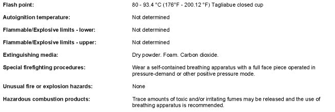

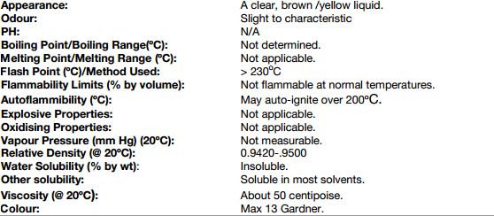

March 6, 201214 yr comment_32843 Charles, if you will check the MSDS sheet on CA glue it is a flammable as BLO. The flash point on both of them is extremely high. BLO should be fine as long as you store it properly and as safe as any other chemical you are using. It might make the results for this type finish work better.Just my thoughts.John MoodySite AdministratorJohn Moody Woodworkshttp://www.johnmoodywoodworks.com Report
March 6, 201214 yr comment_32842 Charles, Found this info about BLO and CA BLO CA Hope this helps Lew Kauffman-Wood Turners Forum HostTime traveler. Purveyor of the world's finest custom rolling pins! Report
March 6, 201214 yr comment_32841 Again, I'm no expert here but my opinion is that I doubt that there would be enough oil transferred to the turning.Charles Nicholls said: Thanks Lew, I don't know why other people are so afraid of it then, except that htere have been cases as I said of supposedly spontaneous combustion. It is said that combining the 2 on a rag then throwing it in the trash allows heat to build up which is supposedly great enough to cause combustion. I have never seen it personally other than in a Youtube video, but it was enough to get me to not use it together with CA. Would natural oils from my hands cause a problem such as we see in my picture? I ask because I did rub it a bit looking for low spots before treating with CA. Thanks Charles NichollsSite Hostnicholls61@att.nethttp://www.nichollswoodworks.comThis website is new so it doesn't have much to it yet but you are welcome to take a look Report
