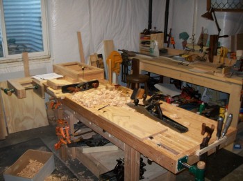

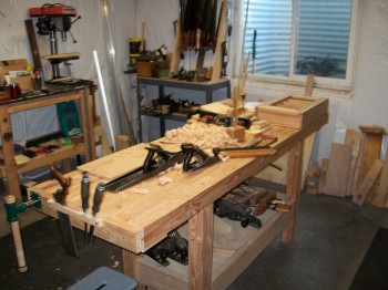

Here is a couple shots from today. I just cleaned things up a bit this morning.ning-bench070412001-27457-7.jpg?width=35ning-bench070412002-27457-22.jpg?width=3

Nice Scandinavian bench how thick is the top, did you make the bench your self or did you have it made for you if you made it how many hours went into it ?

The top is about 3 1/8" thick and 24" wide. I don't know how long it took to build. A few hours during the week and on the week end eventually it was done. Took about three hours sorting the select lumber at the lumber yard to find enough 2 x 4 and 2 x 6s to make it. I figured this was my starter bench and eventually I would make one out of better wood.
So far one change would be having two sets of dog holes in the end vice. When your a 1/4" from being able to clamp a board and you have to back it up 6 " to get to the next dog hole it just seems like a waste of time. I may try and rework it.
Mostly though it's working very well.
The bench in the background on pic 2 is made from 10 2 x 6s and took about 5 hours including buying the wood.

That's a nice bench Mark, great job. So, what would you do with the Dogholes in the future to alleviate that issue?
Just add one to the pusher on the end vice. That way you have two that are 3" apart so you have half the travel distance.

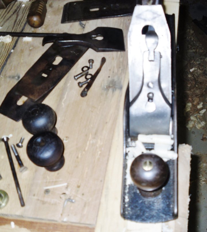

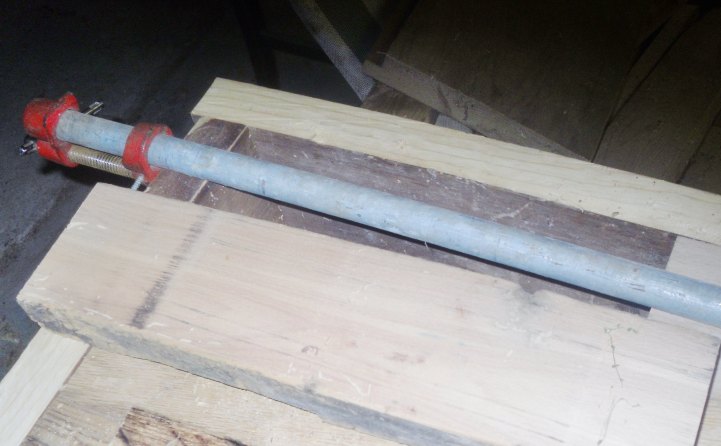

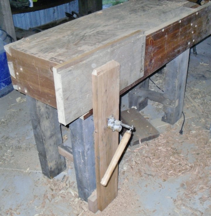

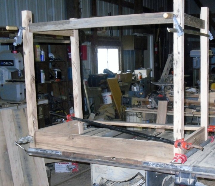

 Went from using the top of my tablesaw to a Nickleson "English"  Planning bench. ning-sdc12302-27444-84.jpg?width=721Tablesaw "bench"ning-sdc12554-27444-10.jpg?width=721Old Barn beams to build a bench.   A "leg vise" from scratch.    Top is a simple four board glue-up.   Nowadays, it is also my "work center" for when i re-hab a plane or two:ning-sdc12783-27444-61.jpg?width=721Hey, it IS in use.Grin.gifGrin.gif    Still working on a "Wagon" vise on the end.     Have some of the parts, thoughning-sdc12558-27444-35.jpg?width=721IF I can get the planes to move out of the way long enough, I  MIGHT just get this old bench finished.     Grin.gif
looks sturdy Steve, those barn beams look good.
