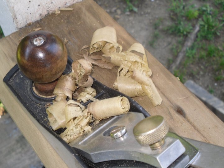

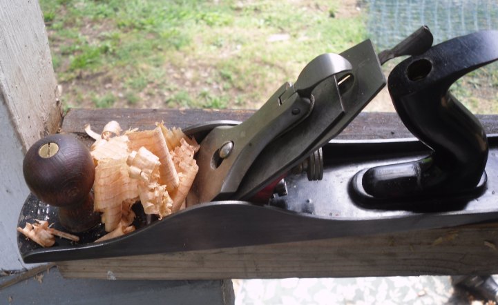

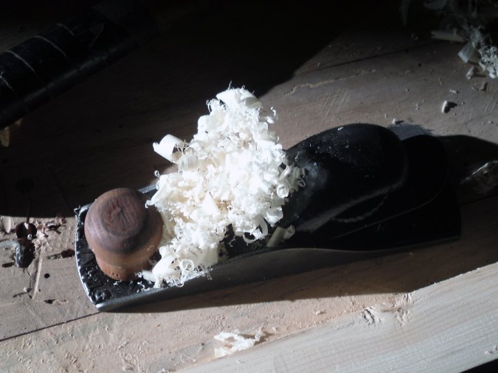

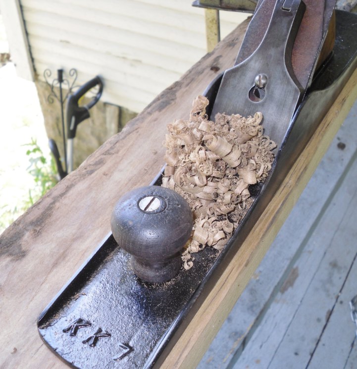

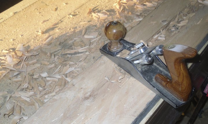

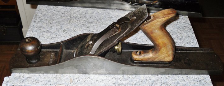

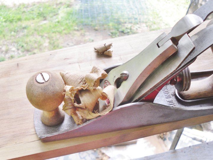

July 31, 201214 yr comment_26380 Block plane, doing it's thing.    Joint clean ups.   The bevel goes UP on these..A number 3 sized SMOOTH plane. Used instead of sand paper, to smooth a surface, prior to finishing...A number 7 Jointer plane.  Takes the place of an electric Jointer.  Used to "Joint" an edge straight and square.   Can be used to surface large surface areas, like a panel. A number 5 Jack plane.  A good all-around plane.  Can surface a rough sawn board as well as a Electric planer, can joint short edges, can smooth small panels.   This is the everyday user plane.  This is my #33 Scrub plane, and this is the way it is used.   It will take down a rough, even surface, VERY fast, as long as you go across the grain.  Stanley call theirs a #40.   One more plane?This is a Number 6 Fore plane.   A small jointer plane, or a large jack plane.   Kind of in-between the jack planes, and the BIG jointers.   Easier to move around than the Big #7, or #8s, but can cover the same amout of surface when needed. All of the above, except the Block plane are Bevel down planes. 'and may the road raise up to meet ye' Report

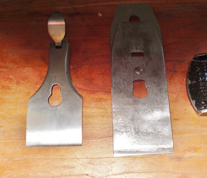

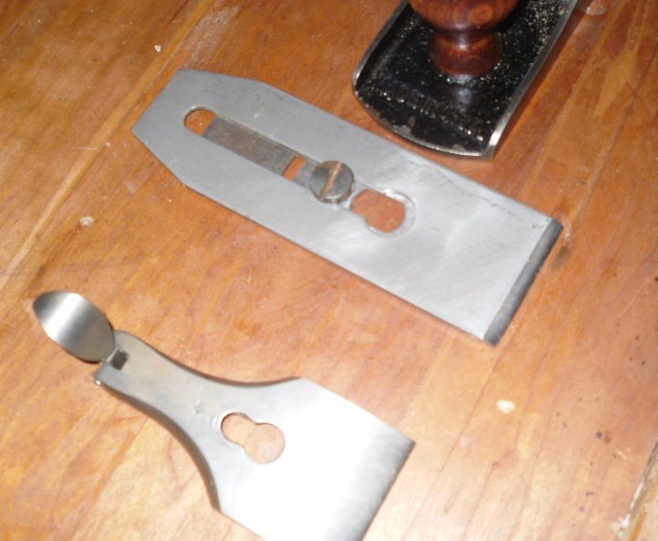

July 31, 201214 yr comment_26379 Beautiful! Perfect start for a REAL discussion road to comprehension! 1. What do you mean when you say "bevel up" and "bevel down"? 2. What defines the difference between "jointer" and "jack"? (structurally, they all look alike to me) 3. The plane I'm looking at here is a #4 jack plane. We bought it as a set with a "mini" plane. It's made by "Central Forge". 4. There are several obvious "layers" to the cutting edge. I can lift the little top lever which loosens the tension and then I can remove what appears to be 3 knife blades. The bottom piece seems to come apart but I couldn't quite figure out how. 5. There is a knob underneath the stack of knives that seems to "adjust" the angle of blades, how would you use that? 6. Perhaps there is a good "first timers" tutorial for this tool hanging around? That's it! No more PLAIN questions! (well, not for RIGHT now at least ;o) Jo Report

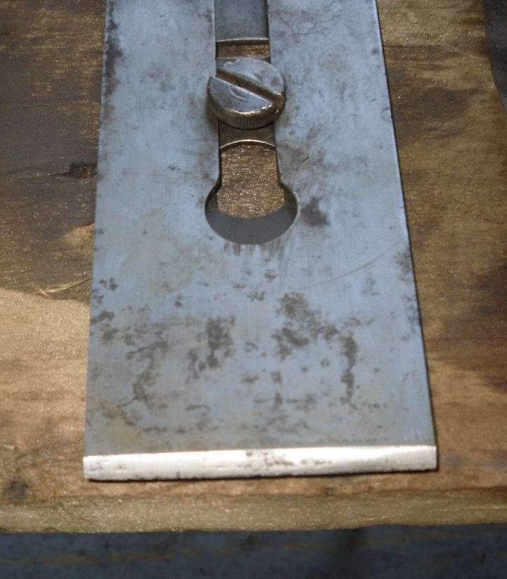

August 1, 201214 yr comment_26378 1) The BEVEL is the part of the blade that does the cutting.    With a bevel down, the bevel is under the rest of the "layers'Here is those three layers.   The Lever cap: locks the other two items to the plane.    The iron (cutter) and a "Chipbreaker" as one piece, held by a bolt.   The chip breaker does just that, it is to "break" chips that the iron throws up, making them curl away.  A look at the "Bevel" side2) the main difference is in the length of each plane. Most Jack planes are about 14" long.   My Number 8 Jointer plane is 24" long ( and weighs in it 10 pounds).    The longer the bed, the more it will skip over dips and valleys, just hitting the high spots,  Once it has them all the same height as the low spots, wood should be flat.    A long Jointer will also straighten the edges of a crooked board, again, due to the long bed. Most #4 planes are about 9-10" long, with a blade width of 2".   That #3 in the pictures is about 10" long, but the blade is a #3 in width @ 1-3/4" wide.   The "mini plane" is just a little Block plane. The "knob" under the stack of knives does set how shallow or deep the cut is, there is also a lever under there to adjust whether the blade tilts to the left or right, or no tilt. Try for as shallow a cut as you can.   Easier to push along that way.  The two "bottom knives" will come apart, just be careful of the sharp edges.    There is a bolt, loosen it just a bit, don't remove it ( they tend to get lost) and swing the piece on top ( it should have a "hump" down by the edge) until it will slide along freely.   There is a slot in the "main" iron, with a larger hole at one end.   Slide the Breaker along until the bolts slips through the hole.  To re-install, just reverse the sequence. One more look at a plane in action?and a look at some blades?This shows the bolt that holds these two together. 'and may the road raise up to meet ye' Report

August 2, 201214 yr comment_26376 Question: How much of a reveal should there be on "iron" and the "chipbreaker"? Ours were flush, Mike has just loosened the bolt and slipped the "chip breaker" (the one with the hump, right?) up 1/16". Do you think that was the problem?We are trying it on a piece of cherry and it just isn't cutting anything off. We must be doing something very wrong.Jo Report
August 2, 201214 yr comment_26375  For most smoothers, maybe a MM or two, as in 1mm.    Between the edge of the chipbreaher and the edge of the iron (cutter).   Allow just enough of this assembly to stick down past the sole of the plane, that you can feel it try to cut.    Once you have the two parts of the iron back together, and on the plane, try this: Hold the plane so that you are looking down along the sole.  Have a light shining on it helps.   Advance the cutter assembly until you see just the edge of the cutter starting to show up.    Make sure it is straight across the opening.  If not, use the lever to lean the cutter left or right.    Once it is "square" and just a hair of cutter is sticking out into view, try a cut.  You can then adjust the thinness of the cut from there.  I cheat on the settings, I use my thumb as a gauge for depth of cut.   I want it so i can just barely feel an edge poking through.    I also add a little candle wax, or even bees wax to the sole, to help things slide along better. kind of a trail & error way of setting the iron.'and may the road raise up to meet ye' Report
August 2, 201214 yr comment_26374 Excellent! Thanks! We also found this website:WoodTreksThere are several videos including a how to use, how to tune up, and a common mistakes. We watched those and with all the information you've provided, Mike figured out that the blade needed to be sharpened. He did that, and now he's going to town on a rough board we had hanging around and our 10 year old is taking turns with him as well. Awesome!Thank you guys SO MUCH!Jo Report
