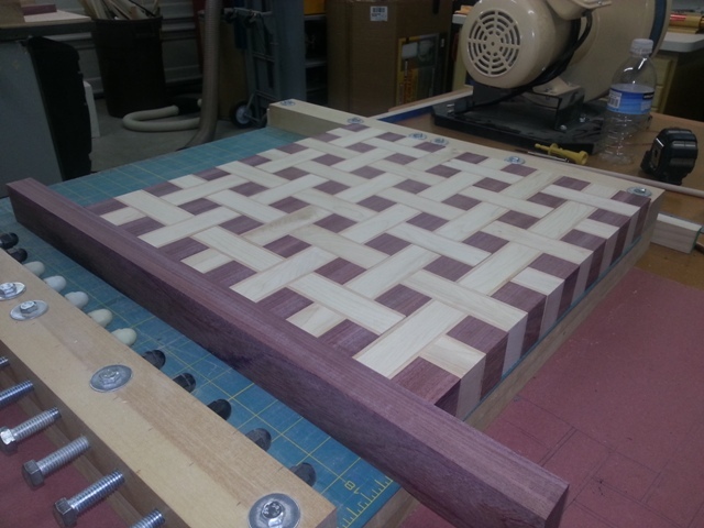

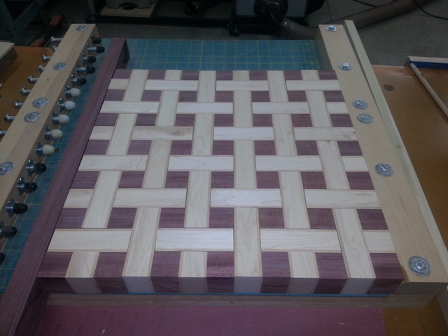

Sneak peek at the weave cutting board
The weave is made from hard maple with cheery bands on each side and the background is purple heart. The dimensions are 16 1/2" X 16 1/2" X 1 5/8" thick. at present it's dry fit. I need to trim a few of the background pieces and then the glue up. I believe this board is more difficult than the 3D cutting board and unless I can devise a better process I doubt I'll build another. The cheery bands are hard to see but should stand out after the finish is applied. I'll post the finished product in a few days with dimensions of the individual pieces If anyone is nuts enough to undertake this project.
Now that is sweet Mike!!!! I love the weave, and i love the bands outside the weaves. SOmeday I'll be nuts enough Mike, please post dimensions! Great job buddy!
Thanks John! I'll post dimensions when I post the finished board for all of us nuts. I hope the glue up is easier than cutting and laminating the pieces but I doubt it. I was able to glue up the 3D boards in sub assemblies but not with this one. Once I start I'll have do it without stopping so it will be challenging. At the moment I'm out of Tightbond II Extend so I'll have to get some tomorrow and do the glue up. I'm back to work on Tuesday so It may have to wait until the weekend for the glue up.

Thanks Lewis! You were the one that pointed me in the right direction.
Thanks Joe! That's a clamping board I built for 3D cutting boards I built. Here's the link:http://www.thepatriotwoodworker.com/forum/topics/3d-cutting-board?id=5228218%3ATopic%3A178825&page=1#comments
The clamping board is on the 2nd page I believe. The cutting mat is on top of the clamping board and the pieces are on top of the mat. Glue doesn't stick to the mat, it works great.

Looking forward to final product. Simply amazing looking now. Great job Mike.

Nice.  I like the clamping frame too.

Thanks Greg & Larry. I'll post a "How Done It" sometime this weekend with more info on the steps I used. My process is a little different than Lazy Larry's. Larry has a better set up than I so I had to adjust accordingly. I like his sled and the Magswitches that he uses for stop guides. I found the link for this pattern that he blogged on LJs awhile back. Very interesting  http://lumberjocks.com/degoose/blog/series/4167  check it out, videos and tips.
