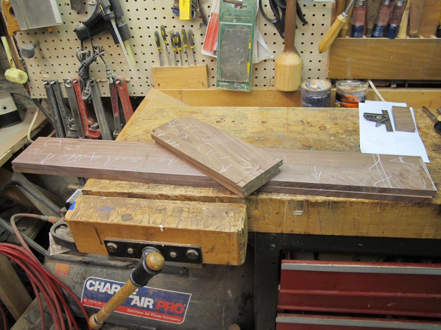

While he hadn't decided on the hardware, I now had enough information to begin working. The box is solid walnut with inside dimensions of 10" x 32" x 3 1/8". All stock is 1/2" thick. The top has a raised panel. The interior will be filled with FastCap Kiazen Liner.
There was enough walnut left from the humidor to make all the necessary pieces, with the exception of the bottom. The bottom is actually two thinner panels glued together. The design of the bottom installation hides the seam.
Top_and_Bottom.thumb.JPG.eadfdf335103543
sides_and_ends.thumb.JPG.3c86ea09ad580e5
My friend wanted the sides/ends joined with dovetails. The bottom and top will set in dadoes.
