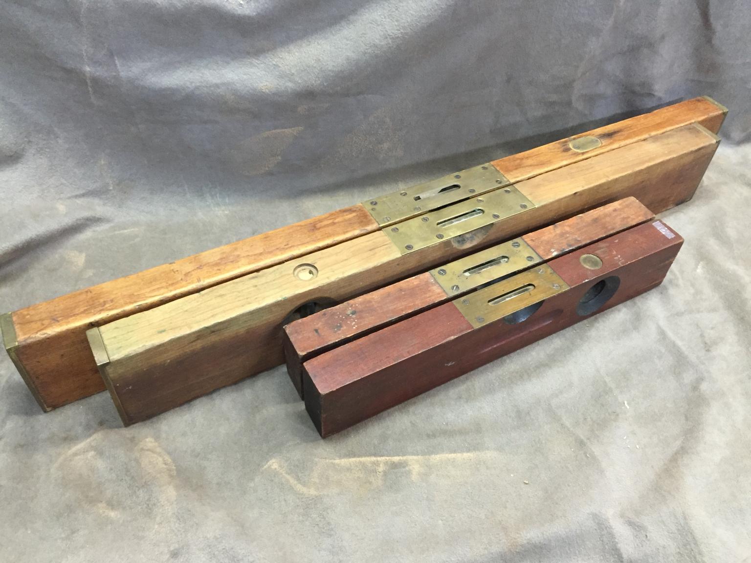

  1. The level collection I purchased has several levels from different time periods. One of the ways to tell when you are looking at old Wooden Level or for that matter any old Stanley tool, it is good to check the Trademark. Bob Kaune has a web page I keep bookmarked on my iPhone, iPad and Computer that is very handy to tell right off the time frame a wooden level or plane. Here is a link to his page Stanley Trademarks. So I thought I would share a few of the ones I got with common Trademarks. These all have what is known as the "V" Trademark It has been documented that this trademark was in use on Stanley tools from 1912 to 1918, That puts these right in the area of being or about to be 100 years old. For a wooden level to survive the 100 years and still have the original vials intact says something about them. There were four in the group that I got with the "V" Trademark. The two larger levels have brass caps on the ends and for the most part are in very good condition. The second one from the back is missing a brass cover over the vial port. Another thing to notice is the No 3 and the No 03. If the level had a single number then it is an adjustable level so that is something should happen, you can adjust the vials to put them back to level. If the level has a "0" in front of the number, then the level is non adjustable. I am very fortunate that all of the vials on these are original and in working order. This group is all made of Cherry. So there you have the "V" Trademark levels from Stanley made between 1912 and 1918, More Levels from Patriot Picking to follow...
