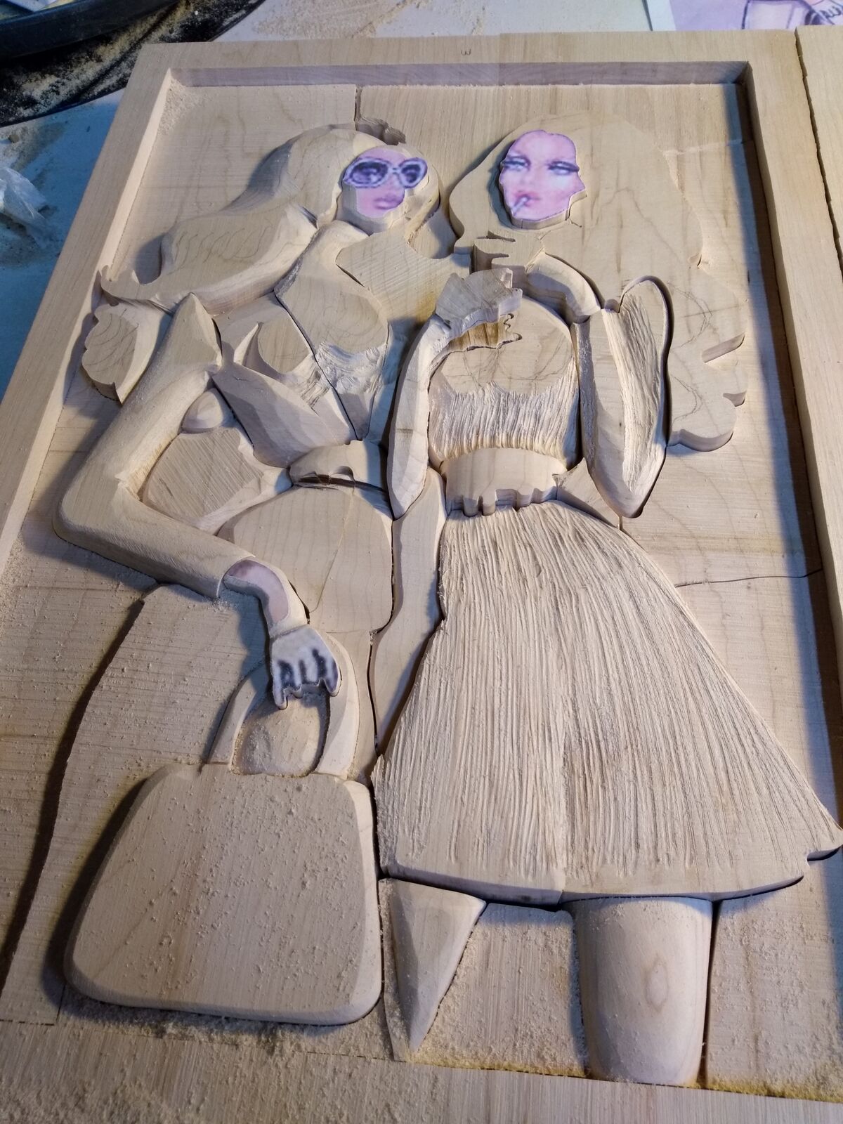

    Carving these 2 girls
    Kinda unchartered territory in more ways than one..... Once I put the pattern on and do the scroll sawing the next step in my carving is to take the 2 girls over to the band saw and cut the tops of many pieces down before I start grinding the wood as my kind of carving saving the wear and tear on the little 1/8" bits and mostly grinding using the 1 x 42" belt sander. Absent minded for I didn't study the picture good enough and didn't even realize the girl on the right side is somewhat set back more than the one on the left...This is the main reason I post many times during the carving episode......so I can sit and try to figure out what I did wrong I also will have to repair the left leg on the girl on the right side of the picture!!! Or maybe I could call her an amputee and add a crutch.... And I don't know what I was thinking when I put the shoulder up in the hair on the girl on the left side. This taking a picture and trying to turn it into a 3 D type of carving just doesn't come out the same as a person wants it to look????? You see I will have a problem on both pictures after I get the hand cut out so it will be up in the air...then I will have her chest to repair and make it like her blouse that wa holding a cold drink with a straw going to her mouth and wife thought is looked like so beer can so no for the preachers house????? Maybe I will run in to something different to show in my learning steps in a day or two. I must have thought the girl on the left side needed 3 boobs for this is what it is looking like I started out to do???? Another thing is I cut the girls in to too many pieces to start with and since then I have already glued a bunch of them back together........
