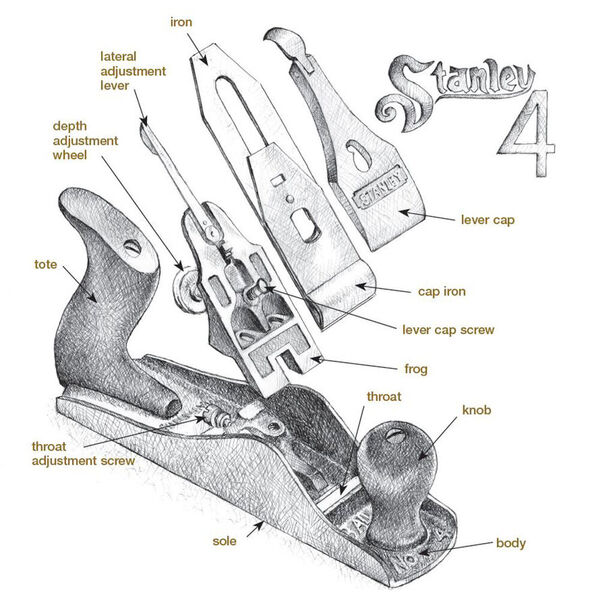

Hand Plane Parts Diagram by Woodcraft.com
Hand Plane Parts Identification
