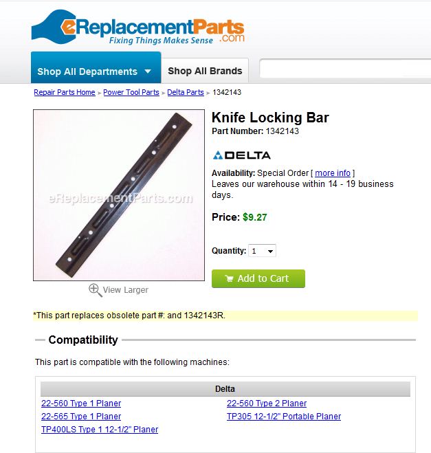

A friend of mine has severely bent the stiffener on his Delta planer and can't seem to locate one.  I told him I would put it out here for you guys to see if any help can be found.
Model Delta TP305
Type 1
Serial 021227
SM5061
He told me he could find the part, orders it, and then several days later he gets an email that says they are sending his money back because the part isn't available.
Any help for him would be greatly appreciated.

Fred,
I'll look around and see what I can find.
Ebay may be a source.
Larry

Gene - The parts breakdown calls it a "Knife Locking Bar".  It is the bar that locks the knife in the rotating head.
Cause?  Picture Oak, cutting into the grain, a little too much initial push, chip instead of cut, chip gets jammed into the knife so hard that it breaks the knife and completely bends the stiffener out of shape.  Been there, done that myself.
Larry, good thought, will give it a try.
Fred

Fred is that what they are calling the Knife Locking Bar?
John Moody
Site Administrator
John Moody Woodworks
Yes, John - that's exactly it.  Thanks for the help.  I'll ask him if he has tried this outfit.  Right now he is an offshore oil rig out in the Gulf of mexico.
