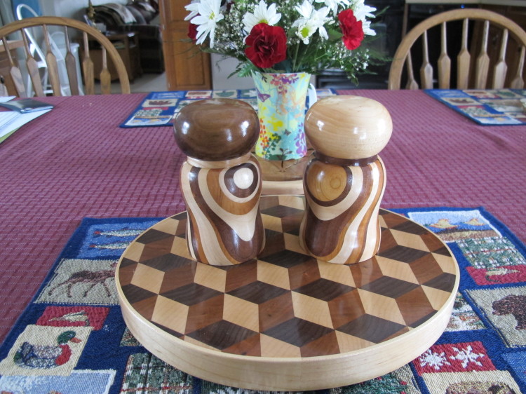

Last Wednesday’s review of the Easy Wood Tools had a sneak preview of a couple of salt/pepper grinders. I thought I would give you a look at the build, this week.

I built the blanks from Walnut, Maple, and Cherry. The salt grinder has a maple top and the pepper grinder a walnut top, clever right!

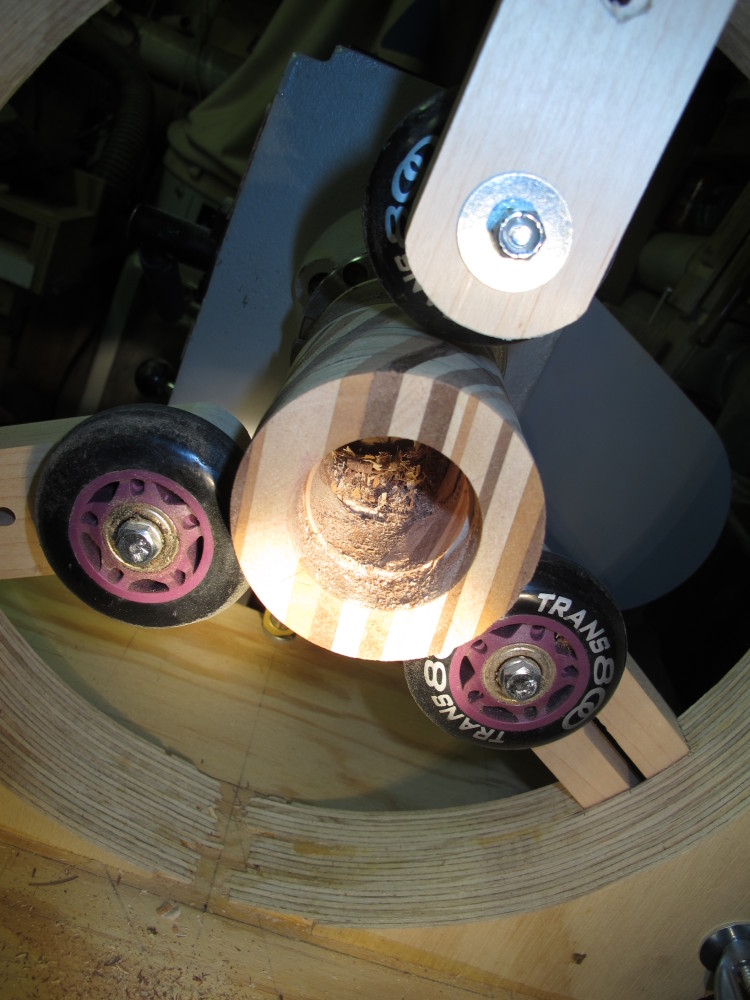

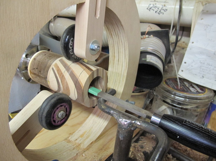

ning-img-1657-17723-75.jpg?width=750
Before creating the top tenon and parting off the top, cut the groove to capture the lower mechanism. I used the steady rest to control the sideways pressure created by the grooving tool. This groove must be precisely located with reference to the end of the grinder body and the 5/8†deep, 1 ¾†diameter bottom hole. The locking tabs of the bottom mechanism must snap into this groove during assembly.

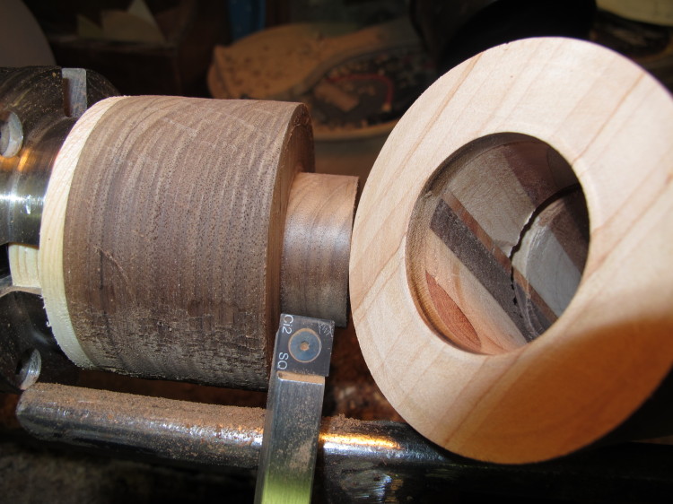

ning-img-1651-17723-48.jpg?width=750
Top with tenon parted. The groove is visible in the body of the grinder.
ning-img-1664-17723-11.jpg?width=750
I found, during the assembly phase, the grooves need only to be about ¼†deep. My grooves are closer to 3/8†deep. This does not affect the operation but it does limit the overall shape by reducing the wall thickness at the groove location. I do not like the overall shape of these grinders. They are not graceful. The height and bottom diameter design does keep them from toppling over on a dining room table. I can picture the Rube Goldberg effect of tall skinny grinders when someone bumps the table- grinder fall, hits spoon handle that flips into the air slinging turkey surprise onto the ceiling- not a pretty sight!

After filling and testing both, Mimi is thrilled with her "belated" Christmas present. As for me, I like the idea of having the option of a range of grinder sizes from a single mechanism.
