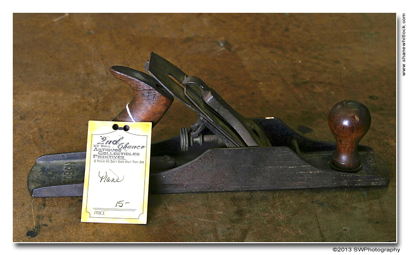

Right away I spotted a couple of way-overpriced No. 5's and a few beat up block planes. I also found a nice 45 that made me choke when I looked at the price. Feeling a little bummed cause I didn't have a whole lot of money in my pocket I decided to leave, that's when I spotted another plane hiding in the middle of a bunch of junk on a shelf ... A Stanley Bed Rock Type 6 605½ C. It was dirty and rusty and a little abused but there was no major damage and no cracks in the body. Best of all I had enough money for it. I gave the cashier the $15.00 for it and headed for the shop.
It's a nice sized plane and feels good in the hands. It's 15" long and 2¼" wide with a corrugated sole, which I like.

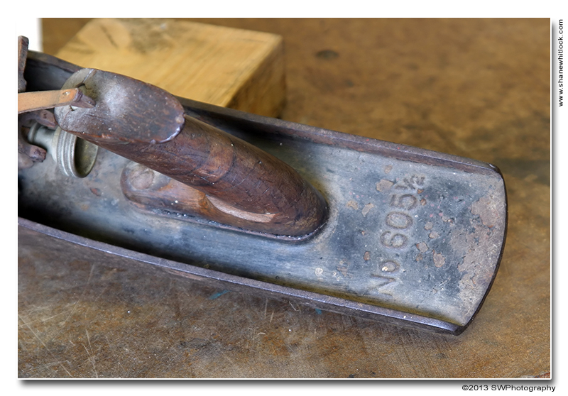

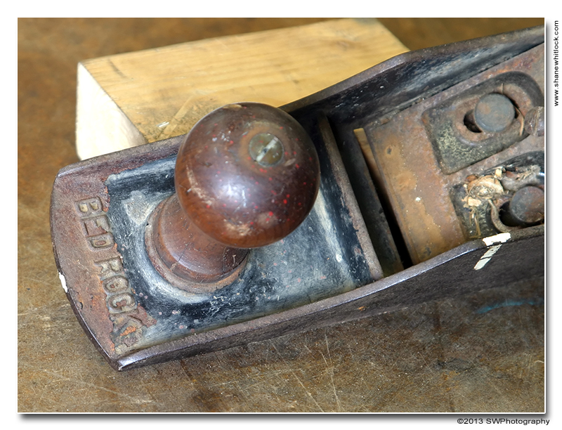

Here's a couple of pics before I started restoring it.
I striped it down and threw the body, frog, lever cap and cap iron in the spooge tank for the night. This got rid of all the rust and most of the japanning. I finished cleaning it up with a wire brush.

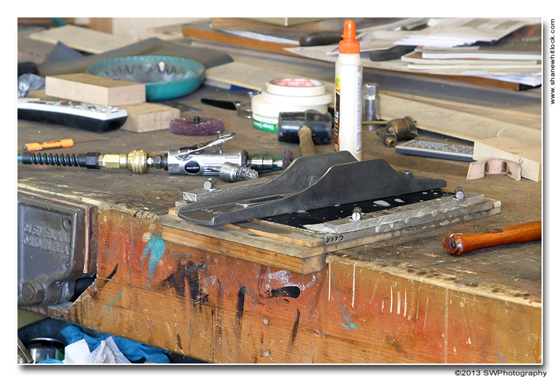

Next I lapped the sole and sides of the plane starting with 220 grit wet/dry and ending with 8000 grit. This gave the sides and sole a nice mirror finish. I also sharpened the blade using the "Scarey Sharp" system using the same grit papers.
This is a jig I made a few years ago out of 1/2 aluminum to hold the paper nice and tight. It's probably not dead flat but it's close enough and I have lapped a lot of planes with it.

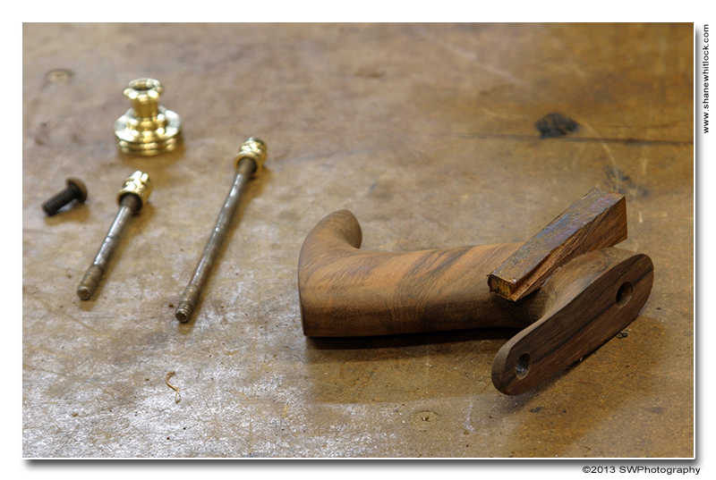

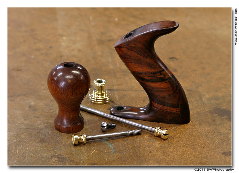

IMG_1804.jpgThe tote had broke near the top and was repaired sometime long ago. It was ugly but structurally sound, so I did a little filing, filling and sanding and it turned out looking pretty nice . It was also cracked in the middle so I spread it apart as much as I could without breaking it and worked some glue into the crack. The worse part was another break near the bottom of the tote that had a large chunk of wood missing on one side. You can kinda see it in the third pic above.
I took the two pieces and filed the mating surfaces flat, drilled and dowel it and glued it together. After the glue set up I took a file and filed the side where the chuck of wood was missing and fit a piece of rosewood in it.
After the glue set up I filed and shaped it. I was pretty happy with the way it turned out. I gave it a couple coats of shellac and rubbed it out. The patch blends in pretty good.

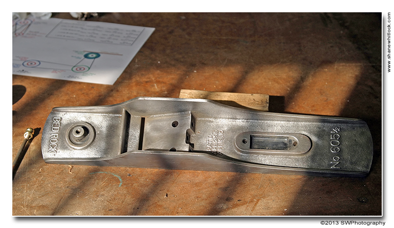

The end results.
Good looking plane for 15 bucks :)
