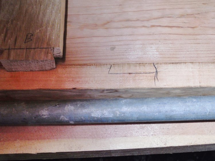

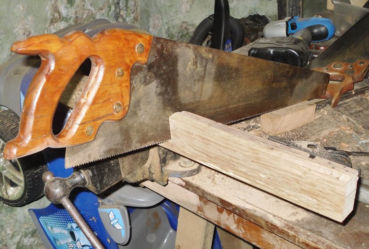

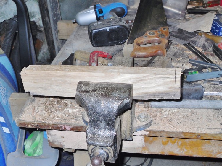

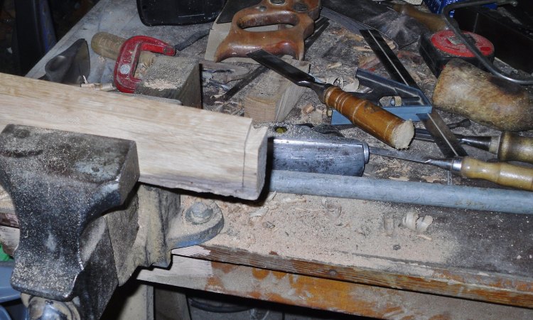

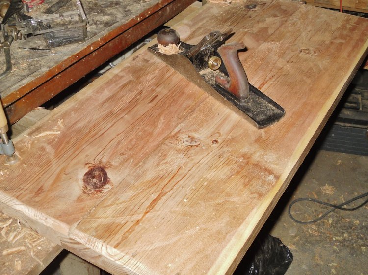

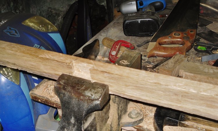

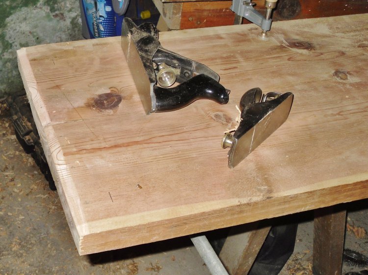

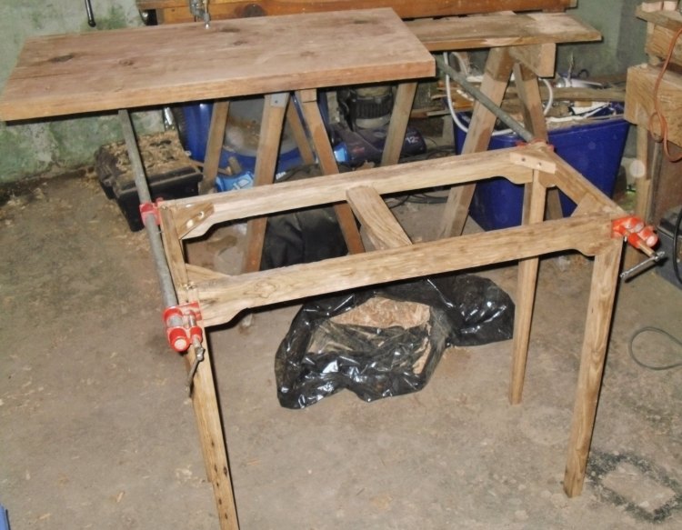

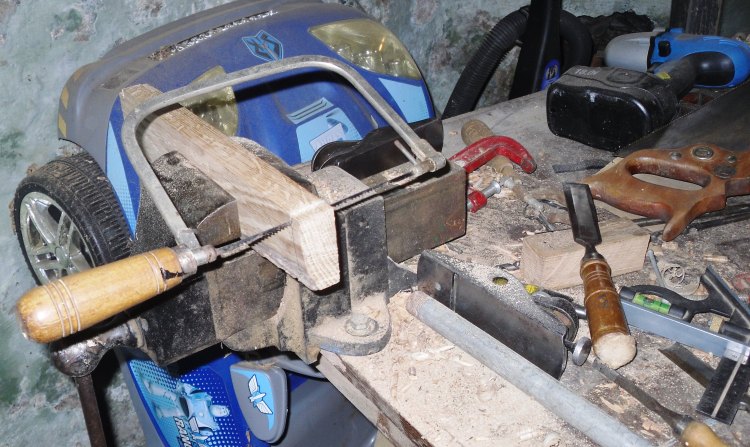

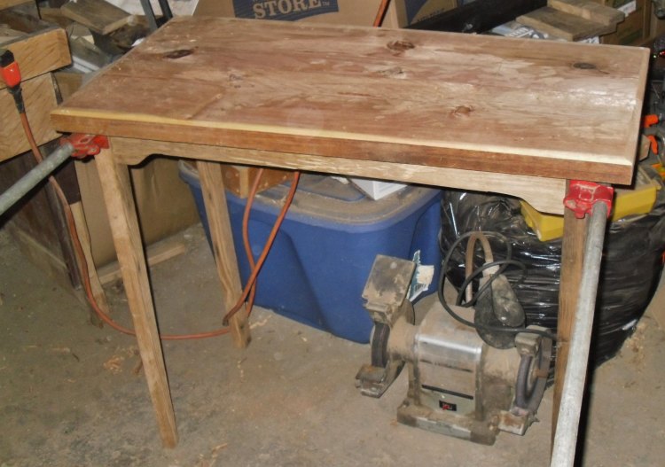

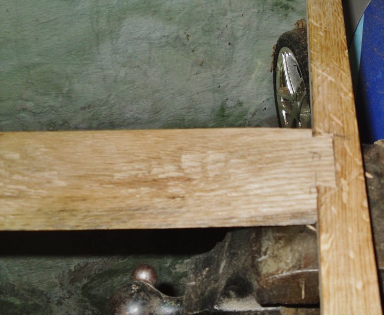

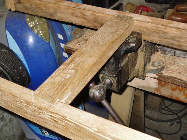

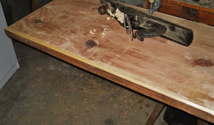

February 4, 201313 yr comment_17520  Had to saw some scrap down to lengthThat is, Hand saw to length.   Needed to make a stretcher from the front apron to the back one.   I was going to hand cut a dovetailSo,I had to lay them out, using an old router bit as a "template".  A little saw workThen chop down at an angle to make a dovetailwearing that old chisel out.  Ok, next I laid out ON the aprons where the dovetail would goUsing the dovetail itself.  Next, more chisel workChecking as i went for fit.  Got both sides done, time for a final fitting (note: I left one apron in the vise)A couple taps with a hammer, to seat it, rotate this aroundand both are now fitted.  I left this together.    I needed a way to stand the legs up.That way, I could glue up the end aprons, and add the corner blocks.   The top in the background was next.Plan was for Beveled edges.  How does one bevel an edge?   With a handplane, or two.  Biggie does the rough work, block does the clean up.   I beveled both ends firstthen the longer front and back ones.  Needed a bit longer plane, though. Still used a block for clean up. I also did a little more smoothing to the topusing a Union #5A ( Stanley 5-1/2 size) to work over the top. I HATE knots!  I will go back over this again, with a small smoother plane. I want to leave some plane markings in the top, for a "Hand-made" look.  One more chore before i quit for the nightSince Igor is still on strike, I get to do the clean up.  I also set the top on the base, just to get an idea of how it will look..Clamps will be gone tomorrow.   Not looking too bad??? Planer? I'm the 'planer', and these are what I use... Report
February 4, 201313 yr comment_17523 Lookin' good! Love those beveled edges and, especially that dovetailed stretcher.Your style of work and commentary is refreshing. No fussiness, no mystique, no outlandishly expensive tools or material.BTW, did you ever determine the species used for the legs and aprons?I'll bet Igoretta Jean, Igor's half sister, wouldn't mind the color of the walls. Gene'The true soldier fights not because he hates what is in front of him, but because he loves what is behind him.' G. K. Chesterton Report
February 4, 201313 yr Author comment_17522 Legs and aprons are a white oak.   Top is Pine. You think I have been watching Roy Underhill too long????Planer? I'm the 'planer', and these are what I use... Report
