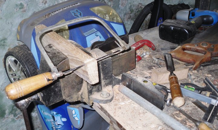

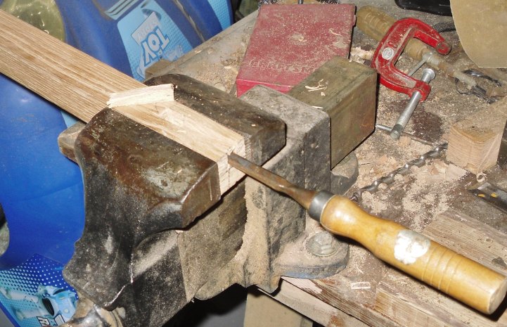

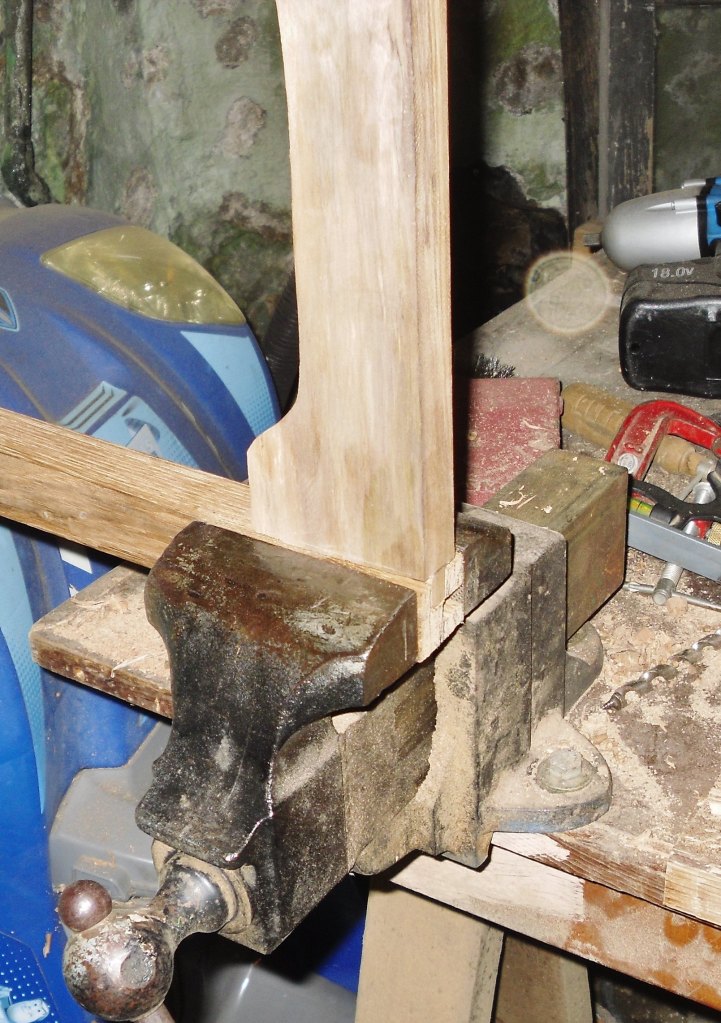

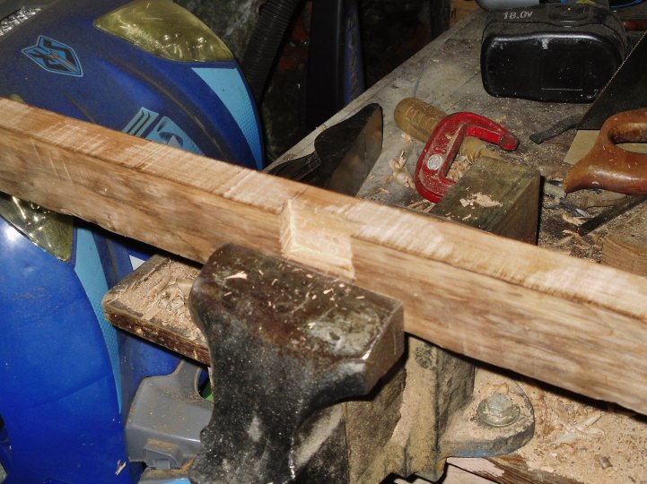

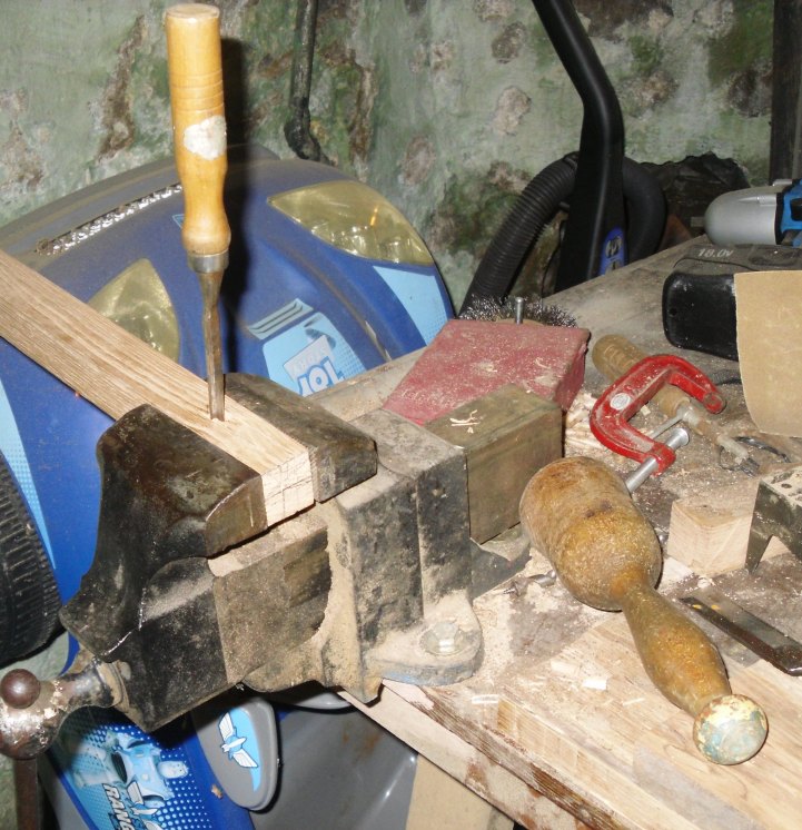

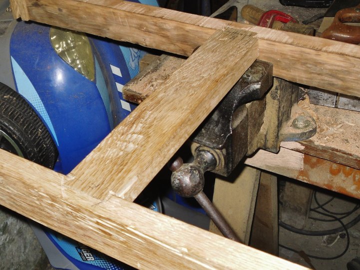

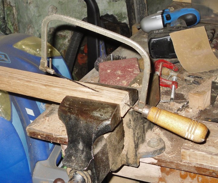

  Tried the Drill press route.    Bit would try to follow  the leg's grain.   After the drilling, I would still have to clean things up with a chisel or two.   Took too long. Same problem with a square hole.   Don't have the $$$ for a powered Mortiser.  So,  I mark out for a mortise that goes to the end of the leg.   A coping saw makes two kerf cuts to define where the sides are. I chop a small square hole at the bottom of the mortise.  I take the same chisel, poke it into the top edge, and a whack or two pops the waste out.  Usually takes two such "Poppins".   Then i can just pare until a decent fit happens.   Might take 10 minutes per mortise.   Counting test fits.

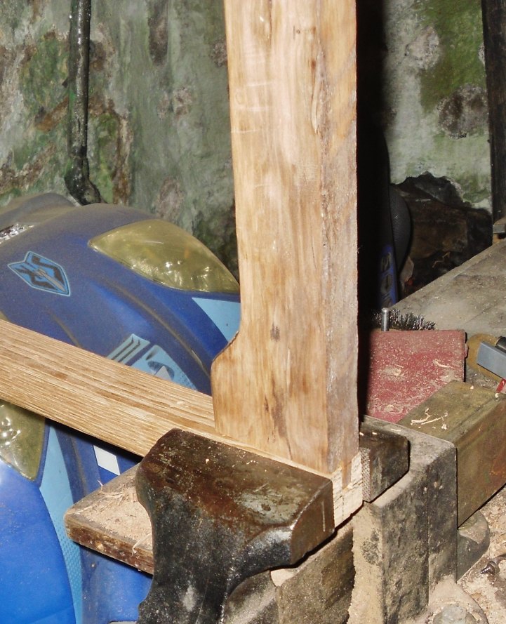

Tenon works:   i lay out where they go, again with a nice dark line.  I then saw down to the depth I need, at the shoulder.  I then grab a chisel, the wider the better.   A couple whacks to pop off the waste, and then pare the tenon smooth.   Rotate to the other face, and repeat.    Rotate to do the next area.    Learned this trick from Roy Underhill.    Chisel the waste off, instead of sawing it.    Seems to work fairly good.
This is a mortise right? a stopped   rectangular hole that does not exit the piece from any side?
How do you get a coping saw do do this?  Got Pics?

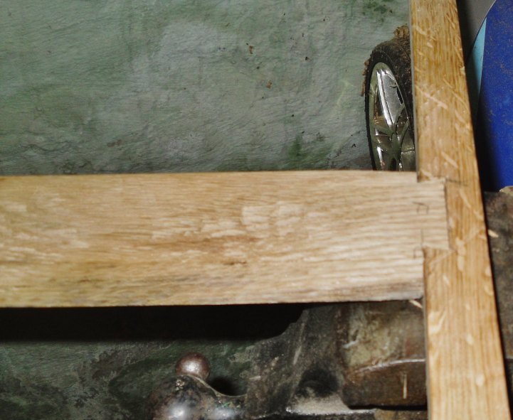

 As requestedning-sdc14249-17434-38.jpg?width=721The cutning-sdc14250-17434-89.jpg?width=721The Chopning-sdc14251-17434-81.jpg?width=721Pop out the wastening-sdc14253-17434-9.jpg?width=721Test for fitning-sdc14254-17434-5.jpg?width=721rotate and repeat.    I also used just a chisel on two jointsning-sdc14269-17434-24.jpg?width=721And a coping saw and chisel for the other halfning-sdc14262-17434-84.jpg?width=721Coping saw saws straight down, that chisel lying there comes in at an angle.    Result?ning-sdc14268-17434-49.jpg?width=721A Dovetail to hold the stretcher.   Needed a matching one on  the other endning-sdc14270-17434-34.jpg?width=721These are sitting there, without any glue used.
