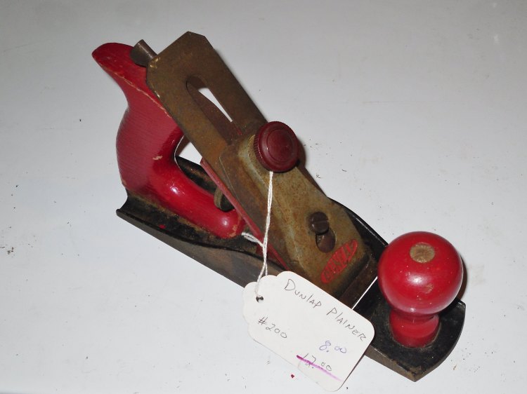

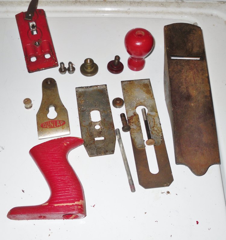

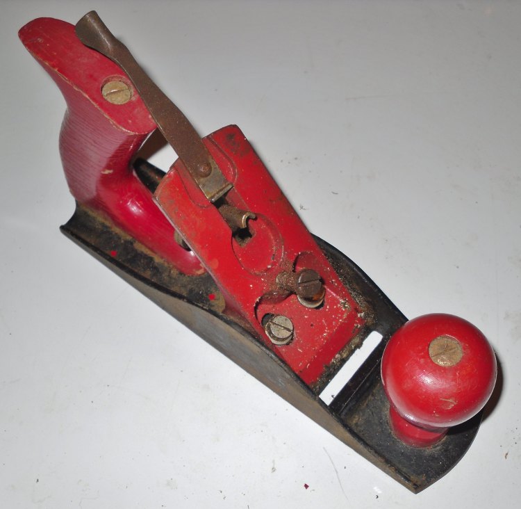

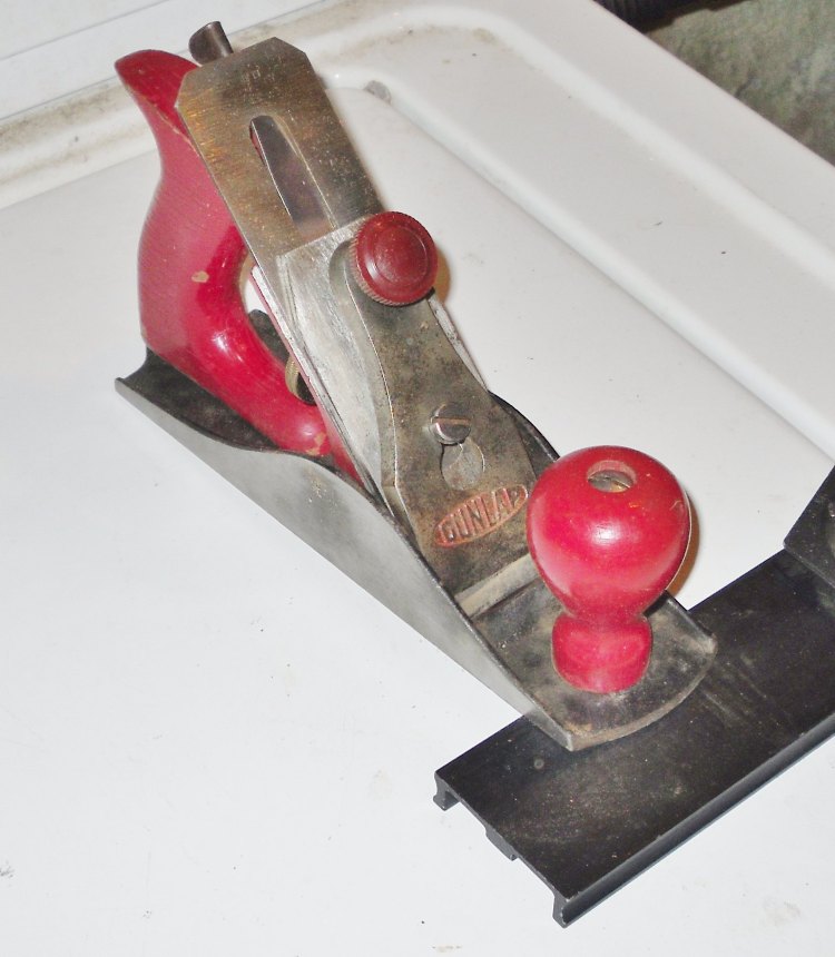

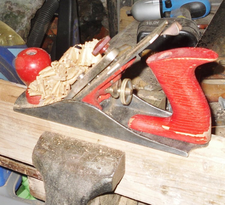

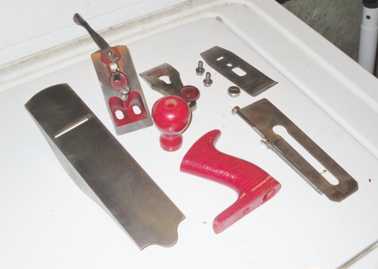

 followed me home today.   A little scroungy looking. ning-sdc14287-17338-7.jpg?width=750Lookig a litle sad, was even put on sale.   Took it home, and looked this #3 Dunlap overning-sdc14286-17338-70.jpg?width=750Looks like someone liked the colour RED!   Tore it down the rest of the wayning-sdc14288-17338-65.jpg?width=750Pretty, ain't it?   Ran a few of the flatter parts over the beltsander.    The others got clamped up, and sent to the wire wheels on the drill  press.   Even the Brass got a shine.   ( I don't even have any BRASSO) ning-sdc14289-17338-63.jpg?width=750Starting to look better.    Worked on the iron until it was nice and sharp.   Stamp on it says Made in West Germany.   As for the chip breaker.     Too longer then the iron, just to get the two to match up.  Sole is now flat, and the sides are clean.   I will leave the handles alone, for now.   Put things back togetherning-sdc14295-17338-6.jpg?width=750Logo will get a touch up of red.   Got some oak for a test trackning-sdc14291-17338-43.jpg?width=750I think we have a "Keeper"???

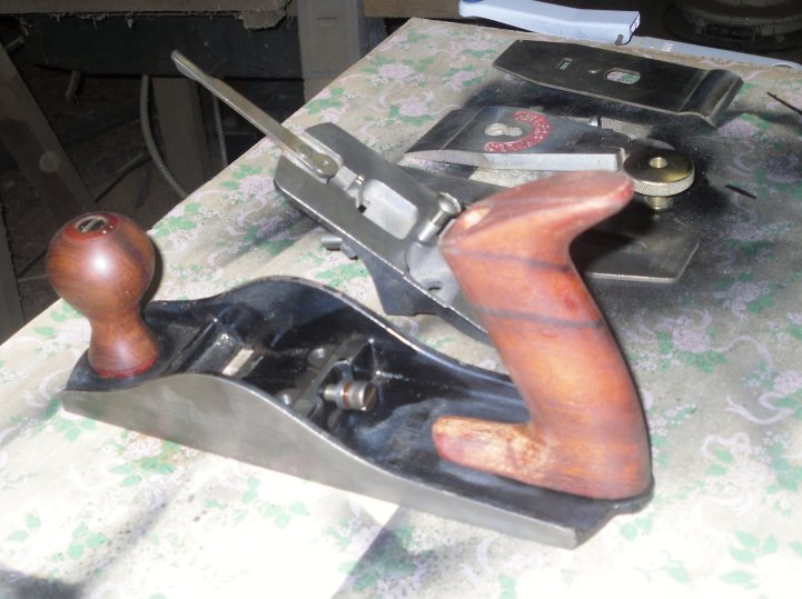

Millers Falls went from Cocobolo to this "other" wood for their "grips".    I had a #9 last year that i stripped of the old, THICK finish onning-sdc12655-17339-90.jpg?width=721Maybe the #8 will look like this?
