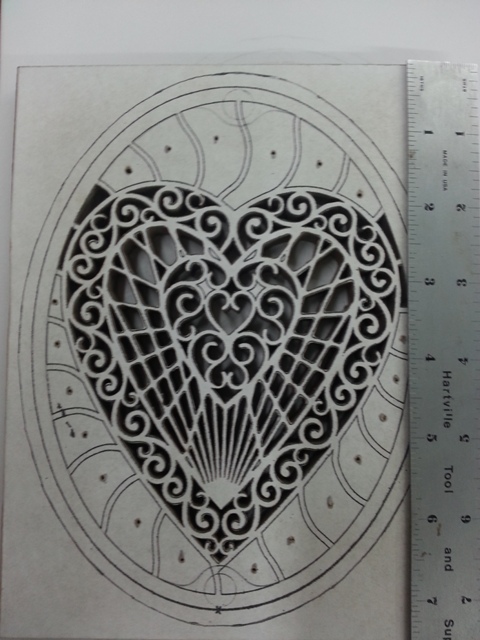

Ok guys and gals here is what I'm looking to do and I'm looking for ideas. I am cutting out the lid for a box that is a fretwork Heart. I want to take this project to the next level and do something different. I'm wanting to fill all the cutouts with a redish or pink material. Sorta like a leaded glass effect. My first thought was acrylic resin but I don't really want to fool around with resin plus the resin will shrink after cured and will pop out so I don't think that's an option.
The cut out area will have a thin backer under the lid. One idea is to pack all the voids with embossing powder or a powdered material and then flood the powder once packed with CA glue.
I've used embossing powder to fill voids on ink pens but those are usually small voids or bands. I've thought of stone dust but that can be very expensive considering the size of the voids around the perimeter of the heart. The lid thickness is 3/8". (see pic)
The lid is walnut and after the material has dried then I will sand the lid so the wood has no overflow and then apply a wipe on poly as long as the poly doesn't react to the CA glue.

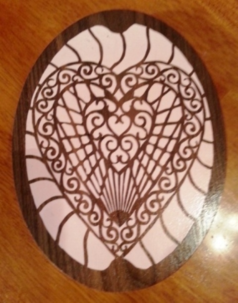

Thanks for the idea Greg. I hadn't thought about Inlace so I checked it out and I will have to try that on another project but while I was looking at the tutorials Steve provided, I saw his tutorial on using Polymere clay to fill in scroll fret work. After further research I found that Polymere clay is actually a fairly quick medium to work with. After conditioning the clay you push it into the voids then cure it in the oven at 275 deg F for 15 minutes. Remove it from the oven and allow to cool and then sand the clay flush to the woods surface and apply finish. I'll post pics when it's completed. Thanks again Greg for giving me the direction.

Thanks Greg. I picked up some clay at Michael's yesterday. I do have a backer glued to the fret work so that isn't a problem.
After further reading on various blogs I did find one that discusses the use of polymere clay with wood. The shrinkage usually comes into play when the wood isn't completely dry and as the wood is heated it will shrink as moisture is cooked out and it causes separation of the two materials. By pre-baking the wood at 225 deg any moisture is removed. The walnut I am using has been sitting in my shop for over a year so it's pretty dry but I will pre-bake it just to be safe.
Another tip I found is to pre treat (after drying) an application of liquid clay provides a bonding agent between the clay and the wood then press the clay into the voids and bake.
Another tip is to over fill the voids and after curing sand the clay level with the wood which removes the shrinkage factor in it's thickness.

Thanks Dragon for the great idea however I went with polymer clay and it worked very well and was easy to apply. I may have to try your bondo tip on another project.
