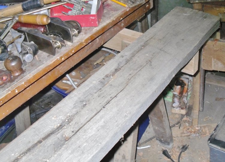

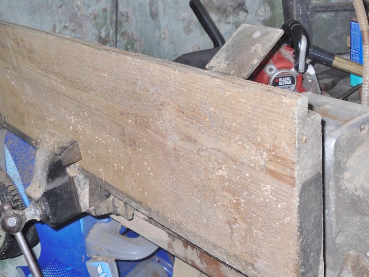

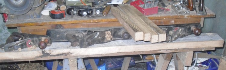

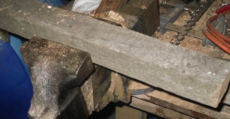

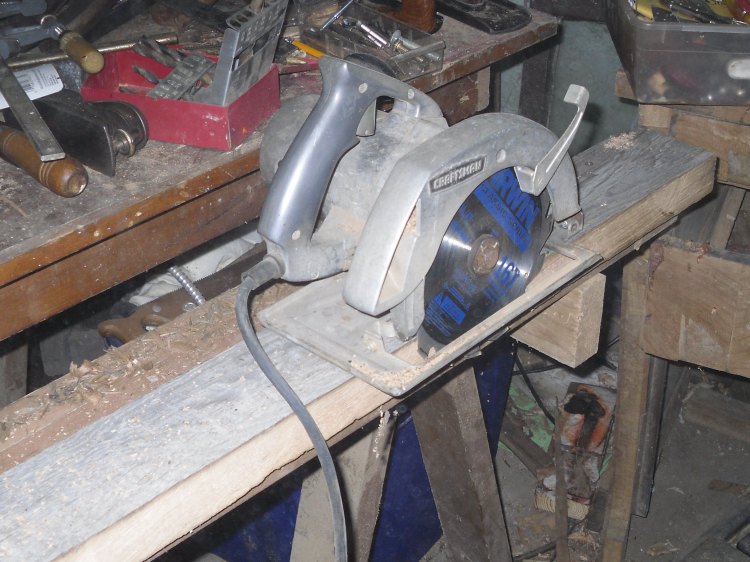

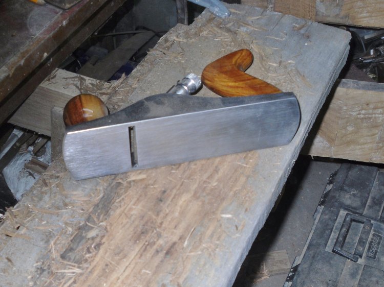

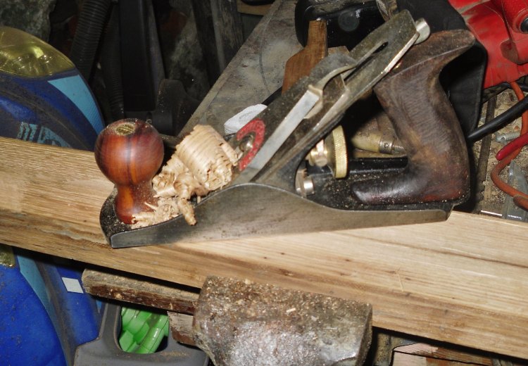

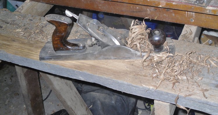

   Rounded up a couple old planks, one pine from a waterbed, the other......ning-sdc14348-16803-63.jpg?width=750underneath all the dirt, might be some oak, at least that's the rumor going round.    Needed to scrub all that junk off, just to rip a blank or two off the good parts of this....."thing".    Tried a small scrub plane, going at right angles to the grainning-sdc14350-16803-79.jpg?width=750It was working, but was taking too long.   Went and got the bigger scrub planening-sdc14351-16803-50.jpg?width=750going at it at the diagonals.    Made short work of the mess.  Used a pair of 2" long screws to hold the plank in place, since clamps would get in the way of the "Table Saw" i have to usening-sdc14355-16803-54.jpg?width=750hey, it is on a table, and it is a saw, right?   I ripped a blank from this side, turn the plank around, and ripped a blank off the other good side.    I left that junky stuff in the middle alone.  Each blank was cut down to size, about ~19" or so.     Needed to plane away the saw marks on one facening-sdc14354-16803-87.jpg?width=750and then work over the other three faces, because they were in needning-sdc14356-16803-72.jpg?width=750Don't you think?     Wound up using about every plane in the shop, size-wise. ning-sdc14358-16803-88.jpg?width=750Several #5 Jack planes, a #6 small jointer, and a small smooth plane.    I did try the old #8c Jointer out, but it was just too long.    I also got a small block plane out,  just for the touch ups.    Anyway, legs are now milled, awaiting the mortise and tenon work.

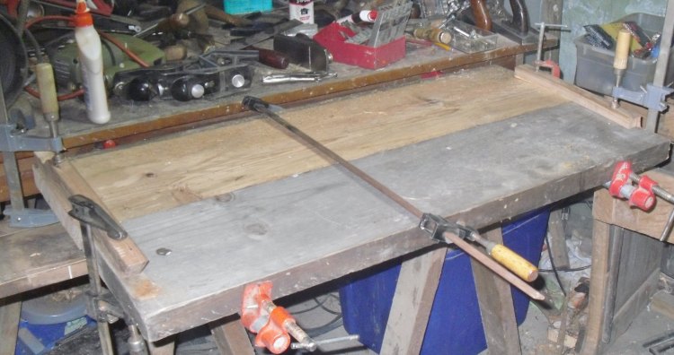

 Next, that Pine plank.    At 72" long, i could get to boards just under 36" long.  They had that Rabbet joint on one edge, againning-sdc14359-16803-96.jpg?width=750So, I had to run a jointer down the edge, until each rabbet match the other.   Had to modify the "Bench" a bit.   Seems my pipe clamps have too long of a pipe on them.  Grabbed a Forstner bit that was just a little bigger than  the 1/2" pipe.    Drilled through the side of the main bench in two places.  Slid the pipe clamps into placening-sdc14361-16803-97.jpg?width=750and clamped up a table top.  i added a couple cauls to keep things  from bowing up.    Give a day or so to cure out.     Next up/  Tenons on aprons.    Stay tuned...

Getting the top out of the clamps today.
