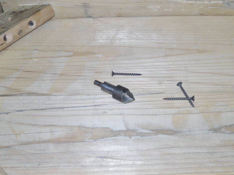

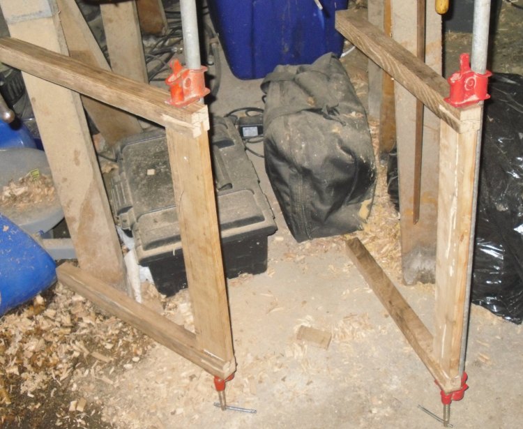

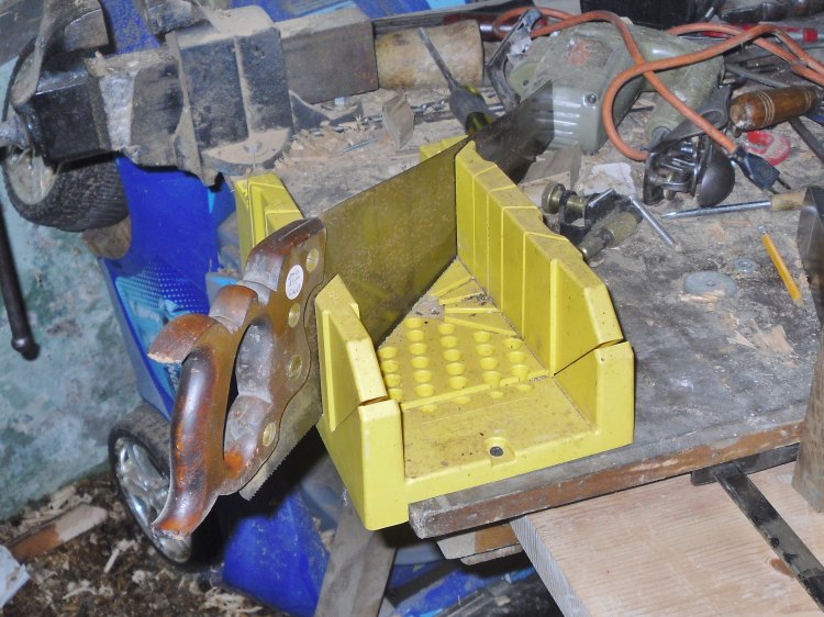

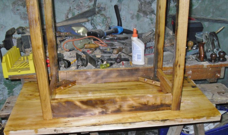

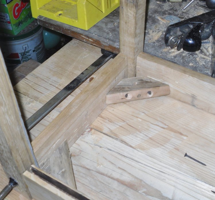

 Ok, when last we saw this little table, there was a few things in the clampsning-sdc14387-16604-10.jpg?width=750Got these out of the clamps today, and dry fitted the rest of the parts.    I needed to cut four corner blocks, so i "fired up" the NEW Mitersawning-sdc14388-16604-42.jpg?width=750Hey, it is new to me.   Atkins panel saw, to boot.   Anyway, got the four blocks cut  and drilled.  Needed to counter sink the screws on the blocksning-sdc14391-16604-72.jpg?width=750This bit is used in my drill press.  The screws are for attaching the base to the topning-sdc14390-16604-93.jpg?width=750through these slotted holes.   I just drill straight through, then rock the drill back and forth to make a slot.   Got the top centered within , maybe, 1/2"  of centers, close enough.  And scrwed the base down.   Time to BLO the bottom areas, before I stand this table up.    Have a can of Poly Gloss to apply after the BLO dries.  A look at the bottom of the Table, all BLO'd upning-sdc14392-16604-84.jpg?width=750No, that is NOT blotching on the apron.   The grain is going in every direction at once.   The darker areas are in fact end grain!!   Imagine that one.  Same with the back apron.   Both were resawn from the same rafter.   I  didn't BLO the edges, as I need something to hold onto as I flip this now assembled table over.    Next up?    Maybe a bit of final smoothing on the top's top, and then some finish?

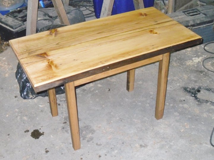

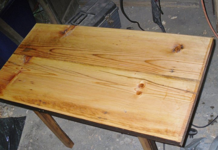

Got the top covered in BLO, and found a crack in the top.     Not too bad a thing, just being holding up a TV, anyway.    Might even be a "Character Point"  sort of thingy.ning-sdc14393-16606-25.jpg?width=721Crack is just on the viewer's side of the center line.    Again, no big deal..  Might have been a "Lurker" doing itning-sdc14396-16606-22.jpg?width=721Verrry IN-ter-rest-ink?

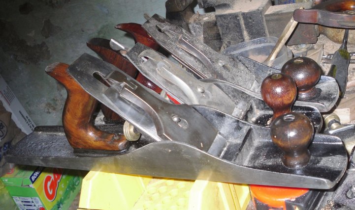

 Have added one coat of Poly Gloss to the tablening-sdc14400-16605-60.jpg?width=721And gave a few handles a touch upning-sdc14399-16605-80.jpg?width=721They were starting to look a little bedraggled...
