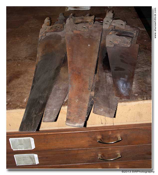

My wife picked up several old hand saws a few years ago from her work.  Over the last couple weekends I have been working on restoring a couple of them.
As ya can see they are all in pretty rough shape and all with busted handles. I was originally going to make a handle for a Disston No. 12, which is the smaller saw on the far right, but changed my mind after I made it and decided to put it on the No. 7, which is laying under the No. 12.
The No. 7 is the first model that Disston ever sold, sold from the 1840s to the 1920s, and judging by what's left of the handle this one is one of the early ones.

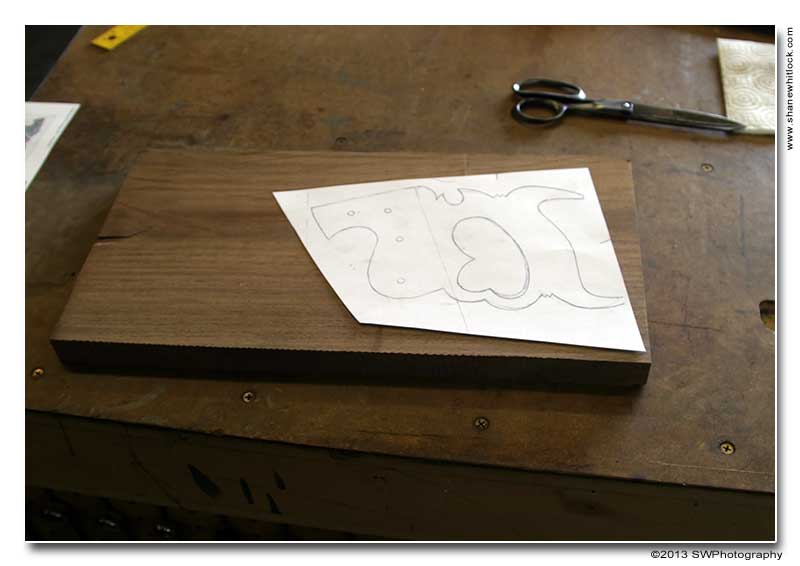

IMG_1843.jpgI used my 36 inch band saw to saw a 1¼ inch slab out of the piece of Walnut that has been drying in my shop for the last 20 years.
I used what was left of the No. 12 handle to draw out a pattern on some paper and then glued the paper to the wood.

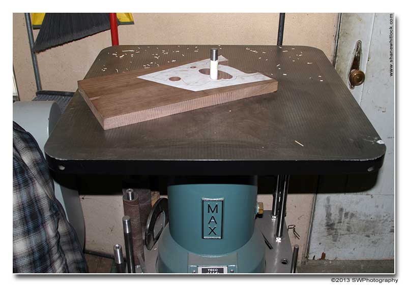

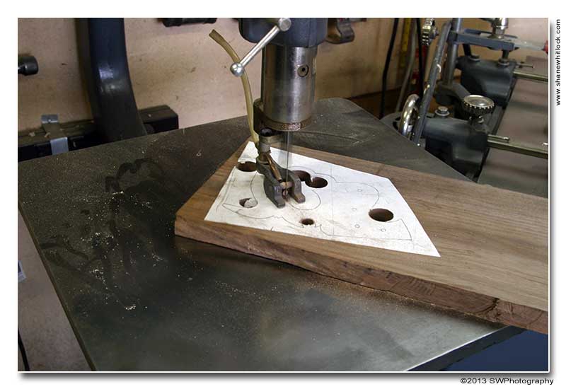

IMG_1856.jpgNext I drilled out some holes and used my Boice Crane scroll saw to cut out the pattern.
IMG_1859.jpgI then used my Max spindle sander to clean it up.

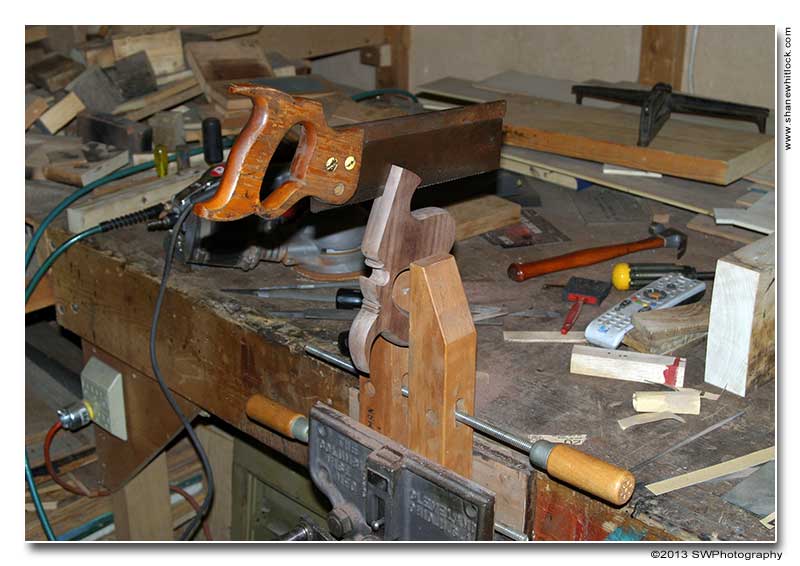

IMG_1862.jpgNext I mounted the blank in a vise and used a small Disston No. K1 back saw to saw the kerf for the blade. I then used various rasps and files to finish shaping the handle.

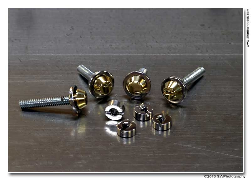

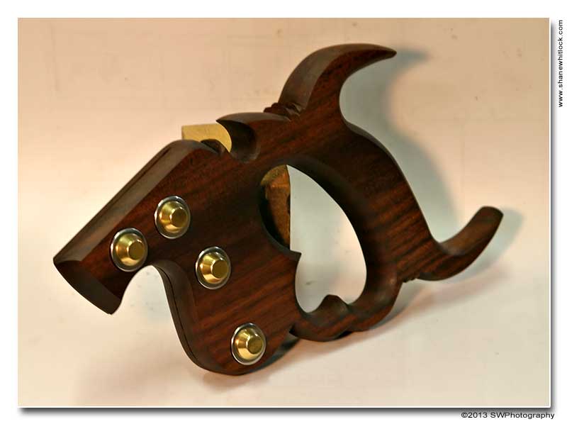

IMG_1867.jpgThe saw nuts were in bad shape and the medallion was also missing so I decided to use my South Bend lathe to make a new set of domed or coned nuts.
conenuts.jpgNuts shown mounted in the handle.

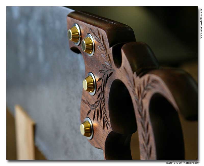

IMG_1880.jpgFrom here on out I kinda got lazy on the pics, but I carved the wheat pattern in the handle and gave it a couple coats of boiled linseed oil followed by a shellac finish and then buffed it out to a satin finish.

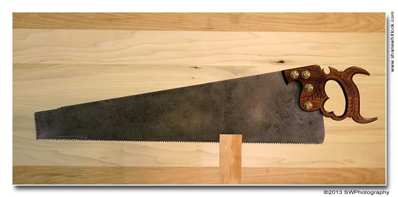

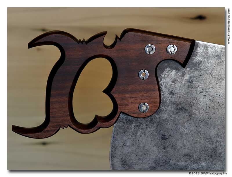

Here it is all finished.

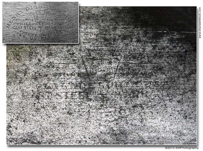

IMG_1935.jpgIMG_1933.jpgIMG_1920.jpgThere wasn't much left of the etching under all the rust, just enough to barely make out what number of saw it is. The pic in the upper left corner of the image below shows another etching from a No. 7 on The Disstonian Institute.
IMG_1844.jpgThe blade is 27 inches long so at some time in its life someone must of cut it down from a 28 or 30 inch saw. whoever did it did a very good job of it.  I shaped the teeth for a rip cut and matched the 5 ppi teeth.
