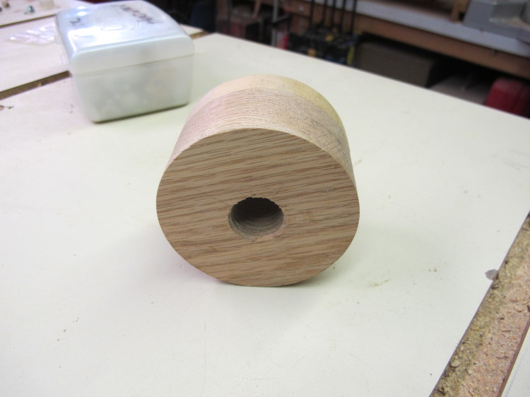

So what is the problem? Well, the faceplate diameter may be too large or too small for your project. You may have several projects in the works and changing the faceplate, during the turning process, can introduce off center errors- this is especially true if you have several homemade lathe jigs. Your project may not lend itself to mounting with the faceplate screws.
The solution- make your own wooden faceplates. It is easy and relatively inexpensive.
ning-img-1807-16463-83.jpg?width=750

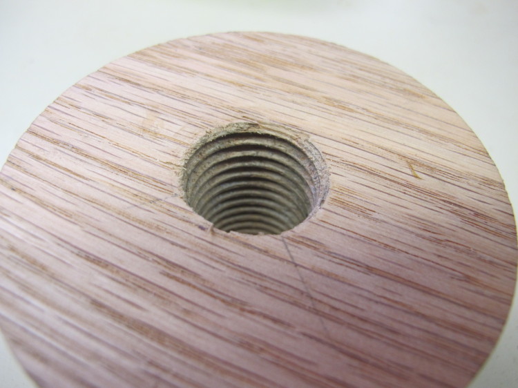

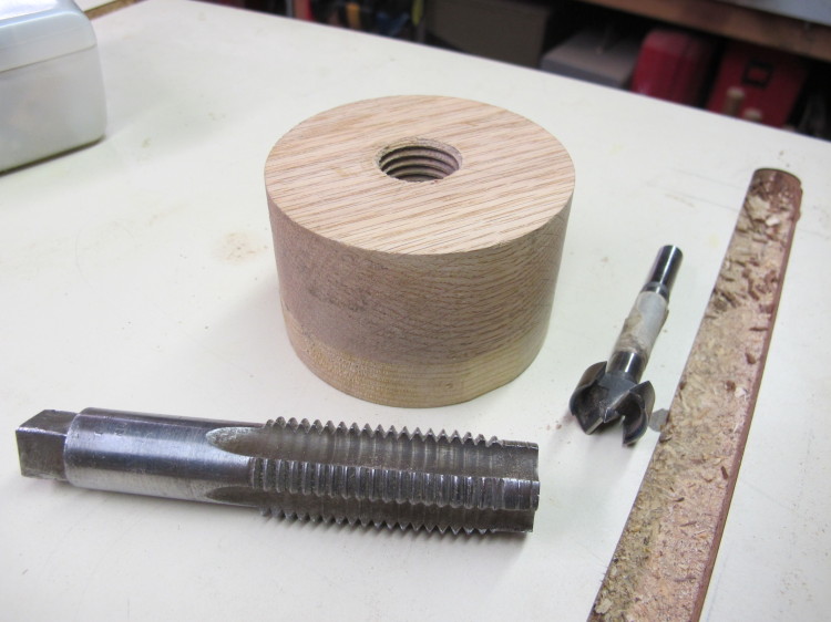

My lathe has a 1†x 8 spindle so I needed a tap to match. I went to a local machine shop and they had some used, dull taps. For a couple of bucks, I was on my way! Checking the Forstner bits, I had a 7/8†bit which gave a 70% bite- perfect for wood! Taps for headstock spindles can be purchased from Woodcraft- http://www.woodcraft.com/product/2020109/19445/beall-spindle-tap-1-x-8-tpi.aspx
ning-img-1809-16463-33.jpg?width=750
My recommendation, for a faceplate, would be a hardwood. The pictured one is Red Oak. I was surprised how well it took threads. Just a tip about threading wood- my first attempts were to thread into the end grain. That was a disaster- the threads pull out, chipped, and looked terrible. Thread into the edge or side grain. It works much better!!

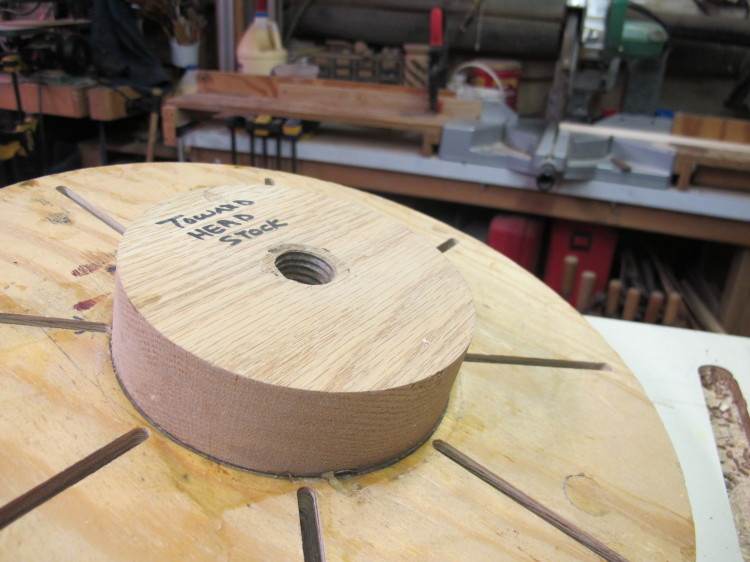

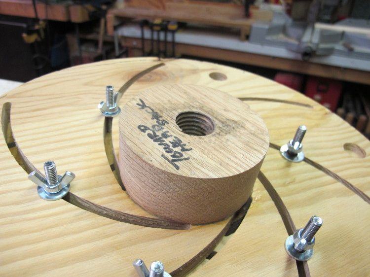

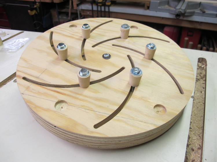

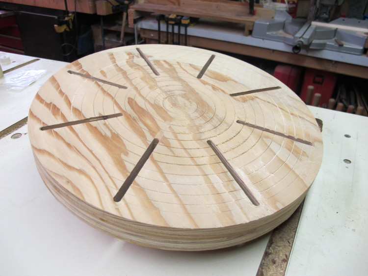

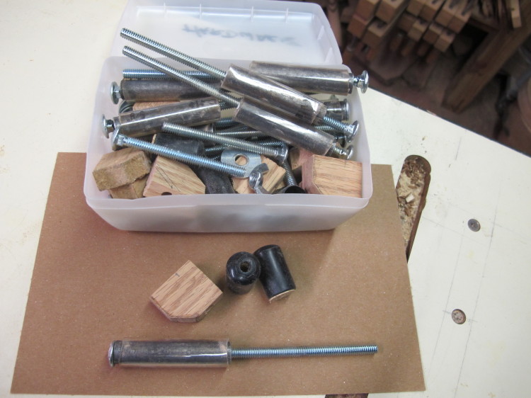

Some other uses of the faceplates-
ning-img-1800-16463-73.jpg?width=750
ning-img-1803-16463-56.jpg?width=750
ning-img-1802-16463-24.jpg?width=750
ning-img-1805-16463-62.jpg?width=750
The above picture shows a shop made, Longworth turning chuck. Here is a link to how you can make one- http://blog.woodcraft.com/2012/04/how-to-make-a-longworth-chuck-with-ron-thompson/. The Longworth Chuck is very handy for holding a wide range of symmetrical turnings. By changing the “holding†hardware, to can adapt just about any size/shape project.

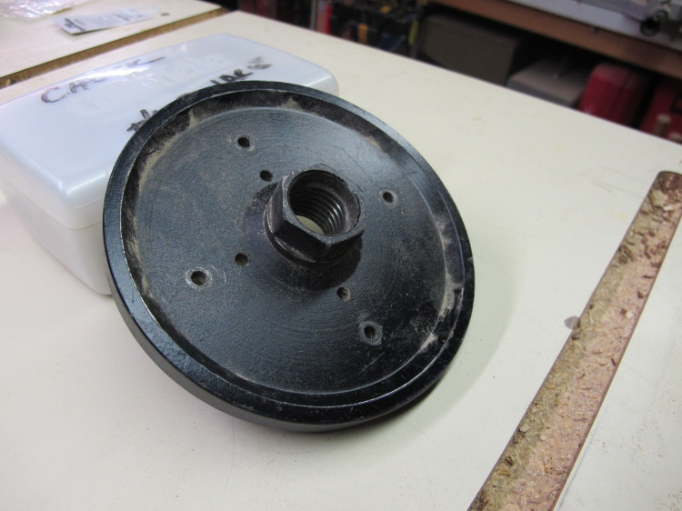

One final note- with ANY faceplate type of turning, PLEASE purchase one of these
ning-img-1811-16463-49.jpg?width=750
http://www.woodcraft.com/product/2021098/24738/antilock-lathe-spindle-washer-1.aspx
Don’t ask me how I know!
