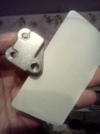

I've suffered similar fustrations with the DeWalt (which I stopped using because of the aggravation from blades slipping out). If you are thinking of the newest Delta saw, then you should know that that saw, the DeWalt, and the Excalibur all have the same type of blade holding design. (Some of the older Deltas had a blade clamp,  which I've heard most people love, but some don't.)
  IMHO, the design used by the new Delta, the DeWalt, and the Excaliber needs improvement. They all use a "floating disc" at the end of the blade holding screw. They like the concept that the disc should not rotate as you tighten the screw, with the notion that it prevents the "hockey stick" bend at the end of the blade. I find that it doesn't quite succeed at that. I think the first task to master is to successfully hold the blade, then engineer a means of not bending the blade. (As it is, the current blade holder design does neither task that well, although it might not be the fault of the floating disc idea.)  Here is the problem as I see it:
ning-bladeonlygoeshalfwayin-smaller-1638
In the picture I am holding a blade holding assembly and pushing a card into the blade slot. As you can see, the slot for the blade allows the blade to only enter to the middle of the retaining screw's hole. So at most, half of the "floating disc" at the end of the screw is holding the blade, and only the front half at that. IMHO, the slot for the blade should be deeper. As I see it, since the end of the screw pivots/floats, the use of only the middle to the front makes it all too easy for the blade to slip out. I picture it as squeezing on the edge of a watermelon seed to send it flying. And as I also see it, a slightly deeper slot for the blade would let the blade be held against the back of the slot using the back half of the screw's disc. I think this would have less tendency to let the blade slip out, as the blade would actually be confined to the back wall of the slot.
So if you are an experimenter/gambler, you should use a band saw, scroll saw, or cutting disc to deepen both upper and lower blade slots by equal amounts. I don't know if the other side of the blade holding slot would need any modification, ie where the fixed set-screw is that is opposite the floating disc. I also don't know if the slot should be deepened for the back of the blade to be all the way at the back edge of the floating disc, or halfway back... I just feel certain that it should be further back than at the midpoint.

I have been an Excalibur user for about 5 years now.  I also had the trouble of the threads stripping out.  I solved the problem by drilling and tapping a new hole in the holder and installing a standard 1/4 20 bolt.  This has not failed in well over a year.
that being said, I recently had my saw reconditioned by Ray Seymore.  The new style upper blade hole is supposed to be much better.  Only time will tell.  The lover holder is still the same design as the older models like Delta uses.  Again, time will tell as to whether this one strips out.

Just had a lllooonnng talk with Ray. One question I asked was about the clamp only being deep enough for half the blade. He said it has to be that way because if you go past half, the tightening screw will force  the blade against the back of the clamp and to twist it down causing it to loosen the tension so you think it has slipped before you start. he said they've tried cutting the slot deeper with no success.
 I thread my blade from the bottom up and have been taking the tension out of the upper arm by pulling gently down on the upper thumb screw. I am now trying to use my middle finger to pull the arm down while using my right thumb to softly tighten the thumb screw.  Good sawing!!!

Just to keep the wording accurate: the slot is only deep enough to let the blade be held by the front half of the disc at the end of the screw. So as small as that disc is, only the front half has any chance at all to hold onto a blade under tension. I suppose if Ray tried it, he would know if deepening the blade slot is an improvement or not. I can't envision that "twist it down causing it to loosen the tension", but I did envision that "forcing the blade against the back of the clamp" would add retention. Perhaps the twist means that the opposing setscrew or something in back of it does need some change to go along with the deeper slot, but something needs to be done. Ray said he's heard about blade slippage for 30 years. And I say that it's about time blade holders held blades at the tension we need. Yes?  I'm not picking on Ray or Seyco...I don't have an Excalibur... I mean for ALL scroll saws... I stopped using my DeWalt because of this issue, bought a used Hegner that had blade holding problems, too, and now an RBI Hawk that also has issues w/blade holding. We want the blade to be a certain tension, especially when cutting harder and/or thicker woods... what the heck is with blade holders not being able to do that for us?
