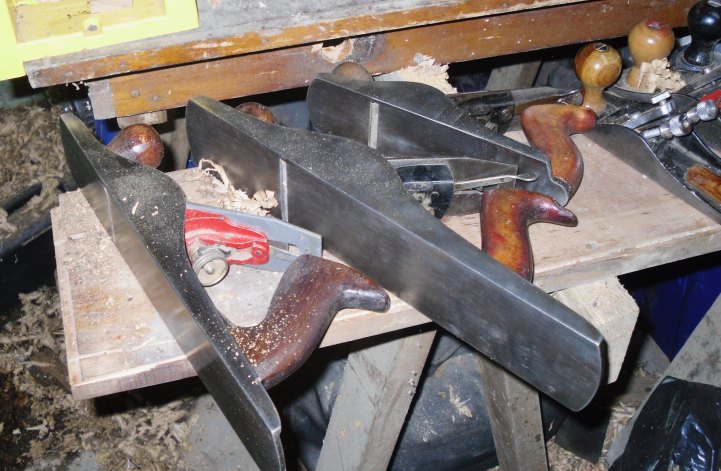

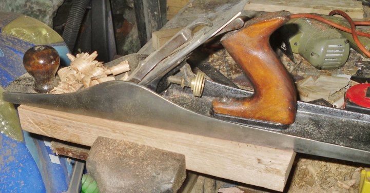

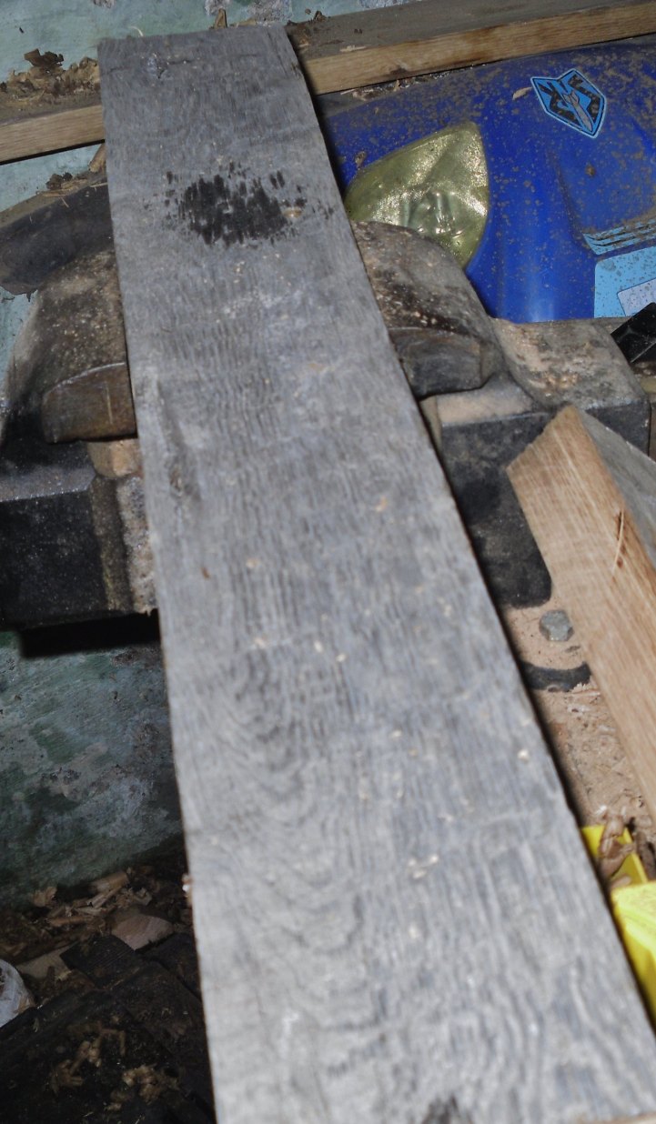

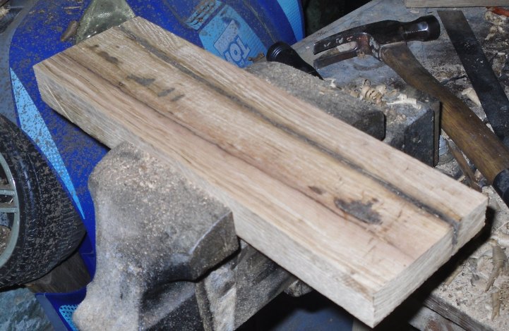

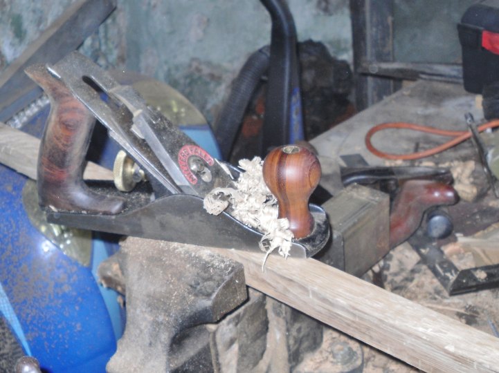

 Got a little work done tonight.   I had that old, nasty Oak plank, about 5' long.  was a bit long to work on.   I cut it down into a couple 25" long slabs.ning-sdc14446-16222-89.jpg?width=721This is actually the "Good" side.      The other side is...ning-sdc14448-16222-23.jpg?width=721not the prettiest on the block.    Cut one in two, a second time.  I thought I can make some 12" long leg blanks out of it.ning-sdc14454-16222-55.jpg?width=721Note that big old plane?    i used it, and a couple others, to flatten this plank down ning-sdc14456-16222-89.jpg?width=721Working on the face of the board.   The idea was to level things out until it all looked the same.   The #6c is listed as a small jointer.    It also does "Flatwork" like panels.     Long bed, wide iron.    Set it a little deeper than Goessemer Shaving setting, and hog away.     When the blank looked goodning-sdc14457-16222-16.jpg?width=721I flipped it over and cleaned and leveled the other face.  I had to use a square to check for the level of the face.  Got a little bit of a slope, and had to re-level it.   Hogged it off in one spot a bit too long...   As for some of the other planes in use tonightning-sdc14455-16222-26.jpg?width=721( left to right) a #5 Jack plane, did some rougher work,   a Union #5a ( Stanley #5-1/2 size)  also worked on some of the face grain.   Next is a #3 Smooth plane.    Checking for "high spots"  left by the "Bigs".     The little scrub plane didn't see much work tonight.   Bench wobbles, and walks around while I was using the planes.     That little scrub would have had the bench a-dancing all over the place.

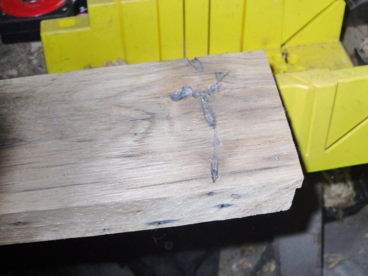

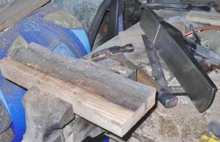

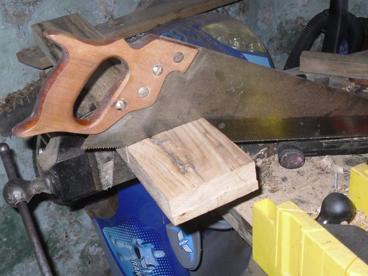

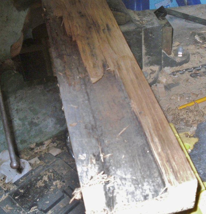

 I might have to get rid of some of itning-sdc14464-16220-71.jpg?width=721Buried in that area are about four nails.   Time for the crosscut sawning-sdc14467-16220-97.jpg?width=721I have already dispatched one bad area, anyway.   Saw  is my Hybrid saw.

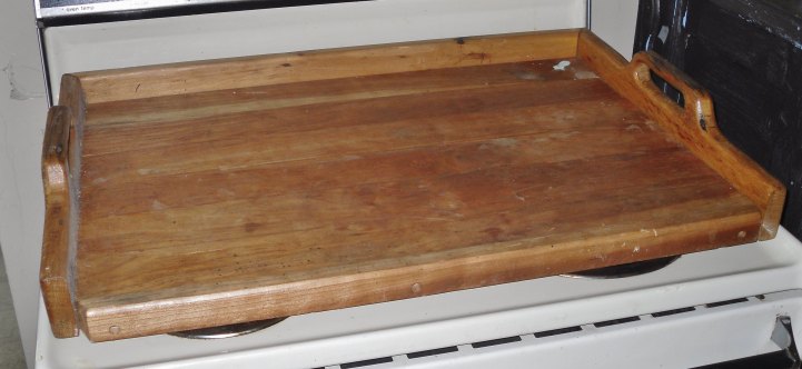

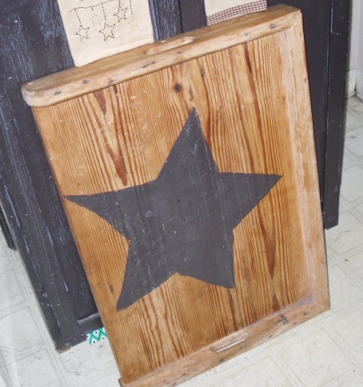

Ah yes, the Tray i will be making this base for?ning-sdc14470-16219-82.jpg?width=721White oak ( almost QSWO) rails around a Black Cherry field.    This is where these tray were to go, when the stove was NOT in use.   Kept things on the stove top that way.     I have two of these traysning-sdc14471-16219-42.jpg?width=721But i think the second one can just be kept for "stove duty".  The fancy one can be used if someone wants to sit up in bed, maybe a Breakfast tray thing,  or just a reading table, with space for the coffee cup.

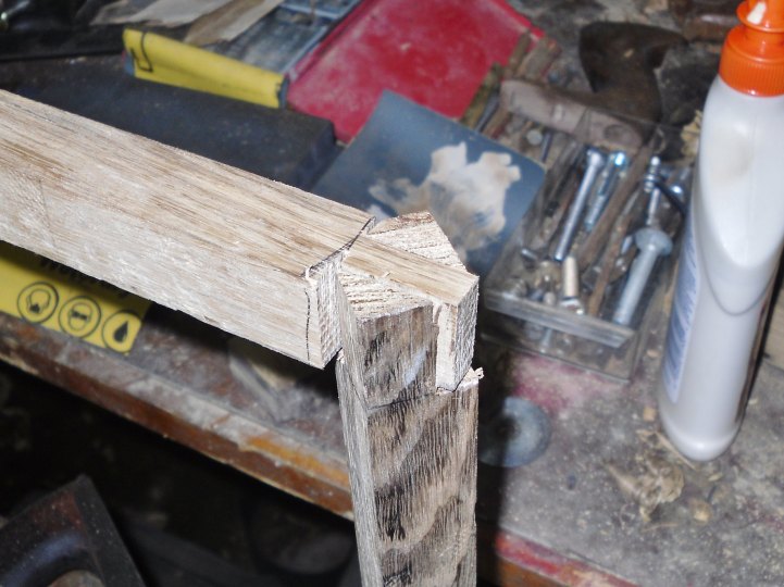

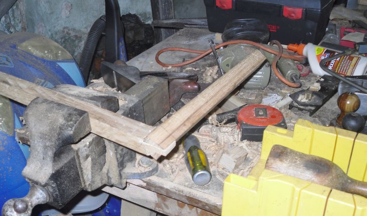

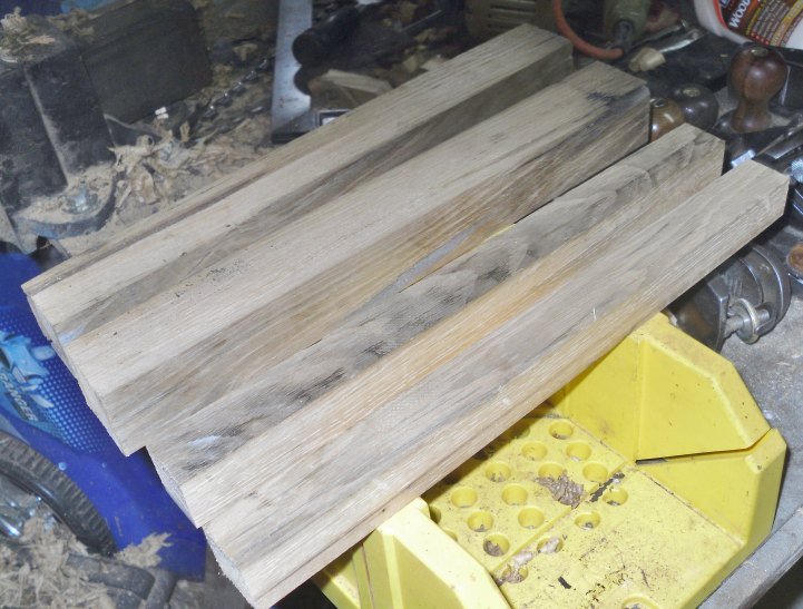

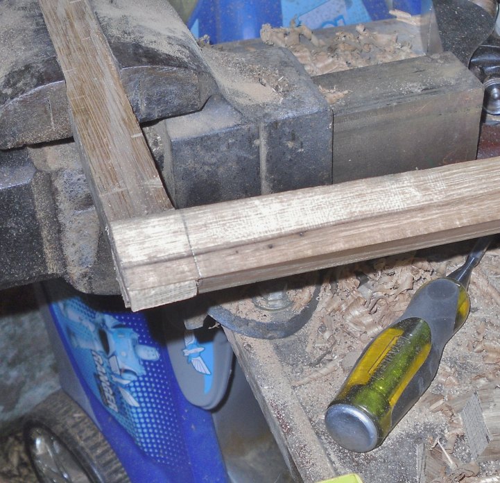

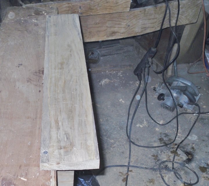

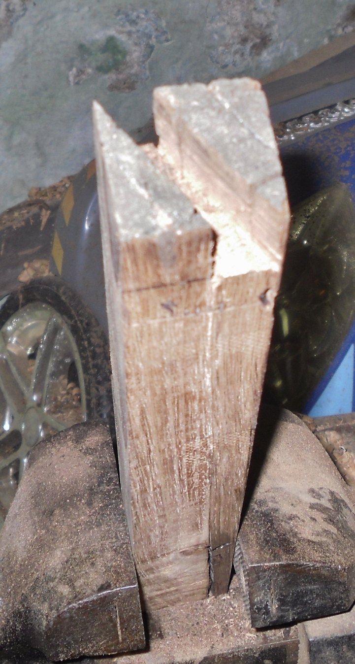

 Ok, got down to the Dundeon Shop this afternoon.    Got four leg blanks ripped, and saw marks removed.ning-sdc14474-16217-31.jpg?width=721Two skinny ones for the front, the fat ones for the back.   Set a board on the "saw Bench" to rip a pair of railsning-sdc14475-16217-45.jpg?width=721Saw on the floor is my rip saw.   There isn't any room down here for a tablesaw.    Got two pieces ripped, and then planed the saw marks offning-sdc14476-16217-3.jpg?width=721Yes, that vise does leaves marks, but they come off during the finishing steps.    Set up to do angled bridal jointsning-sdc14477-16217-94.jpg?width=721Chisels, saws, and mallet.   Coping saw did a lot of the work.    Started to fit the skinny leg firstning-sdc14478-16217-44.jpg?width=721then I moved to the other end of the rail, to fit a fat leg.ning-sdc14480-16217-5.jpg?width=721Ugly thing, ain't it?     Finally got both ends looking at least presentablening-sdc14481-16217-98.jpg?width=721I'll use the rail as a pattern to make the other rail cuts.   As for the fat leg jointning-sdc14482-16217-74.jpg?width=721Still needs a little bit more fitting up.     Once the two leg assemblies are done, I'll make an angle half-lap joint to join the two units together.    Then I can think about attaching this to the tray.     Might take awhile....
Wasn't a good day down there today.   Things kept fighting the entire time.    From saws vibrating in the kerf so bad they bind, to stuff trying their darnest to drop onto the concrete floor.   I picked up that one skinny leg five times.    Finally stomped back up the stairs, and camped out at the computer for awhile.     Got cooled down, and started to think things through a bit.     Went back down and glued the first  assembly up.     Then started a little different way of cutting bridal joints.

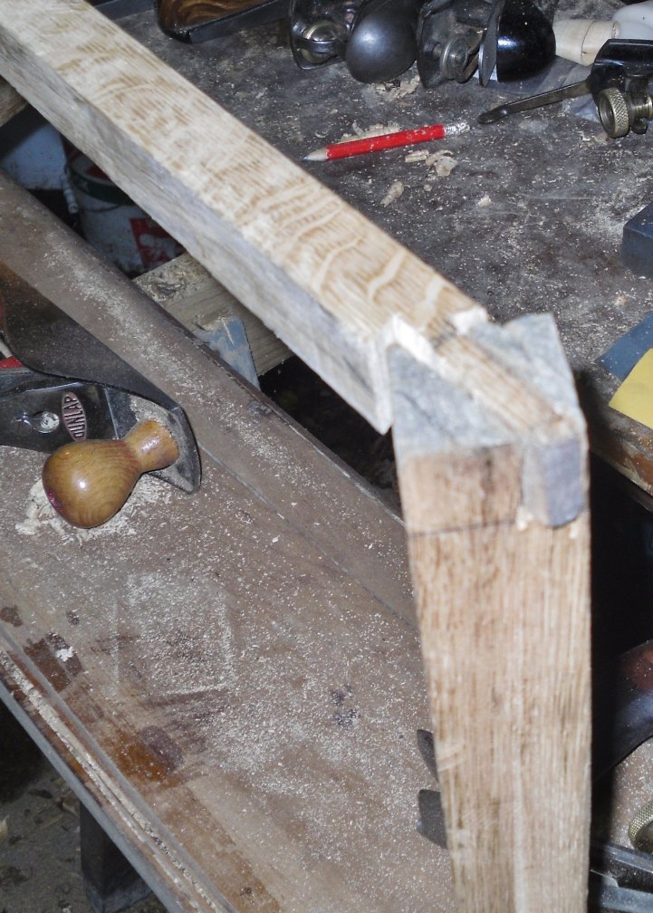

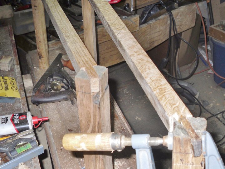

Still used a saw, a 20" long panel saw ( used two of them, in fact) and a chisel.    Instead of trying to be fancy-schmancy with the "Cope & Stick" on the joints, I went with a more squared off look.   ning-sdc14485-16216-21.jpg?width=721Second one is sitting there as a dry fit, no glue added.   Legs are still at an angle, but all else is cut square.   ning-sdc14483-16216-80.jpg?width=721Once these two joints are glued up, I can go back and round things off as needed.     Still have the make a half-lap joint, to joint the two assemblies.    And, an angled one, at that.    Might need to sharpen one of the panel saws....

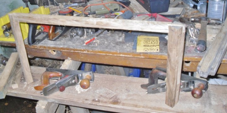

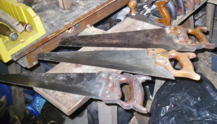

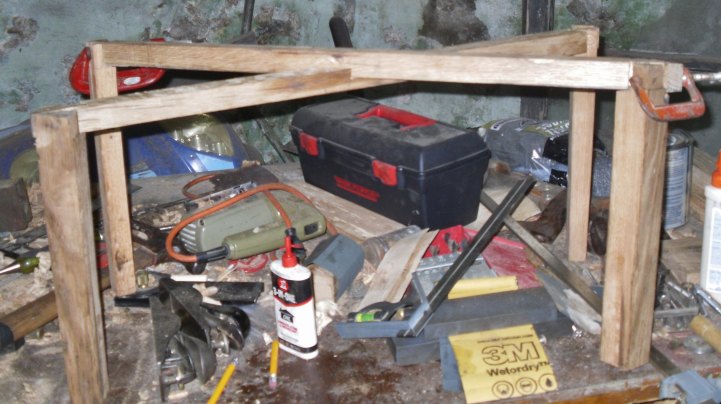

Update:   The other assembly is in the clamps, and a start on the half lap joint is done:ning-sdc14487-16215-73.jpg?width=721And, a look at what I use for saws around here:ning-sdc14488-16215-43.jpg?width=721The two "bigger" saws are a9 ppi Atkins Panel saw, and My Steigo-Disston Hybrid saw @ 11ppi.    That pointy thing  is a mixed bag of teeth, they get bigger the closer one gets to the handle.    Might have been sharpen one or two times too many?   Saw the half lap down to half way through.    Pop the waste out with a chisel, pare smooth.    When the other assembly comes out of the clamps, I cut the other half of the lap joint.    Beltsander to round some edges that stick out.
 Update:    Second half of lap joint is sawn.      Waste has been pared away.     Glue and clamps applied.    Just waiting results to come in.   Will need four holes drilled and counter-bored, for the mounting screws.    One leg is a little crooked, but usable.
