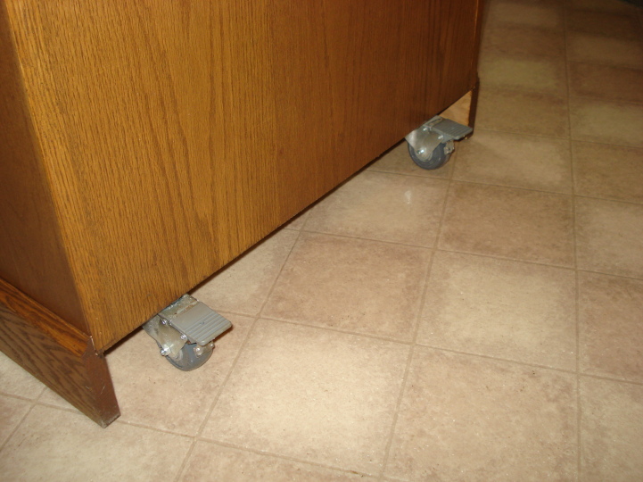

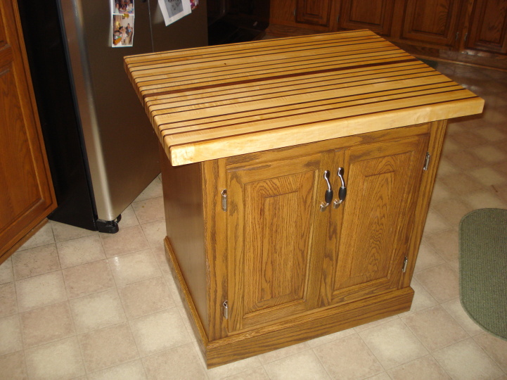

March 4, 201313 yr comment_16204 I used ones like this (grey wheels) under the roll about island/butcher block/cabinet. http://www.woodcraft.com/product/2001989/33703/212-caster-double-lock-swivel-plate-with-4hole-mounting-338-tall.aspx I removed the locks from the front two as they where not accessible after installation. These are rated at 130 lbs each. Lew Kauffman-Wood Turners Forum HostTime traveler. Purveyor of the world's finest custom rolling pins! Report

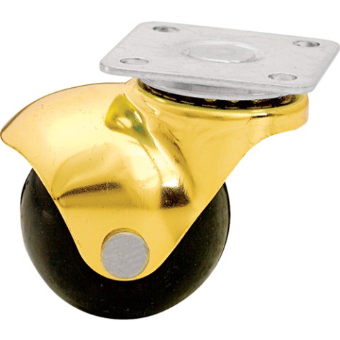

March 4, 201313 yr comment_16203 Ron I would recommend using urethane or rubber wheeled casters. Plastic wheels can mar flooring. Unless your cabinet is going to weigh 300 lbs or more I'd think 2" would be overkill. The caster in the pic has a wheel that's 1-9/16". I have a supplier here where I get all my casters for shop projects and they are very good on prices. This caster is from Rockler but there are many out there that have a stem or plate mount. I've always preferred plate mount over stem mount because of their strength. http://www.rockler.com/product.cfm?page=2314&rrt=1 www.thepatriotwoodworker.com Proud Supporter of Homes For Our Troops Report

March 5, 201313 yr comment_16196 Not sure, Ron. It's all 3/4" oak- some ply, some solid. The top is 1 1/2" thick. It has 2 full extension shelves. Over 100 lbs for sure. Plus, inside there's a big and little food processor, a cast iron dutch oven and misc. electrical small kitchen utensils.Lew Kauffman-Wood Turners Forum HostTime traveler. Purveyor of the world's finest custom rolling pins! Report

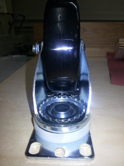

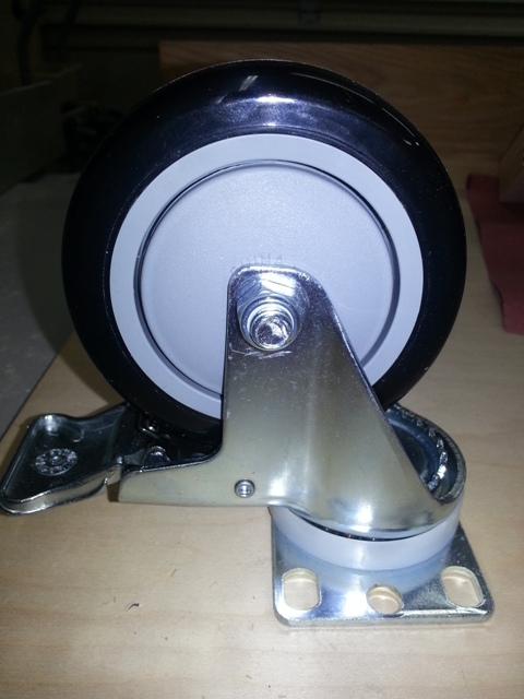

March 6, 201313 yr comment_16192 Cliff I bought a set of casters yesterday with the caster & wheel lock. Not sure of the manufacturer, they're made in Taiwan. I bought these from a company "John W. Negus Co." here in Portland. I've been buying from these guys for years and never had any problems with any of their products They have the same style caster with the wheel & caster lock with wheels from 2" up to 8". You can get them from Granger, Woodcraft, and many other retailers as well. In the pic Lewis posted you can see the same style caster on his island and it has a double lock as well. In the pics you can see the caster toe lock has teeth that engage with teeth on the caster base. www.thepatriotwoodworker.com Proud Supporter of Homes For Our Troops Report

March 6, 201313 yr comment_16190 I'm not sure Ron. They're an import but no band name stamped on them. I can tell you they are well made. They have ball bearings for the wheel & casters, all the wheels are concentric and the fit & finish is great. I was on the process improvement team at my work for several years and I've used these same type wheels on many of the carts and platforms that we built for our engine, prop, accessory and sheet metal shops and we've had no failures and believe me we've put them to the test. I can see If I can find the manufacture's name and get back to you. A set of 4 was $43.00 but these have a 4" wheel and the smaller wheel set is much cheaper. Cheaper than other suppliers. www.thepatriotwoodworker.com Proud Supporter of Homes For Our Troops Report
