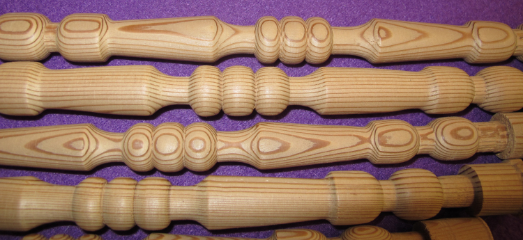

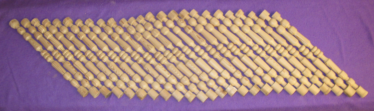

A former student, of mine, and then teaching partner gave me some pine boards he removed from his home during a renovation project. His home predates the Civil War and over the years has served as a tavern, boarding house and farm. Although the pine was not original construction, it is obvious from the grain and width, it is very old. I spent the last couple of days getting some spindles made for a crib project, which will be for him. I imagine he will be a grandpa one of these days.
ning-img-1846-16084-48.jpg?width=750
ning-img-1849-16084-51.jpg?width=750
I can't decide if the spindle, when installed, should have the straight grain or cathedrals facing out.
Anyway, I turned these spindles using primarily the skew chisel. Started with square blanks. Rounded to the finished diameter, cut the "balls" and rounded ends, and the tapers with the skew. Did use a spindle gouge for the cove cuts and a parting tool for the end tenons.

I see some flaws Lewis...no just bugs on my screen LOL. Those look fantastic. I cant wait to see the finished product. I'll look at the videos a little later when I have some time. Thanks for posting your awesome work!
