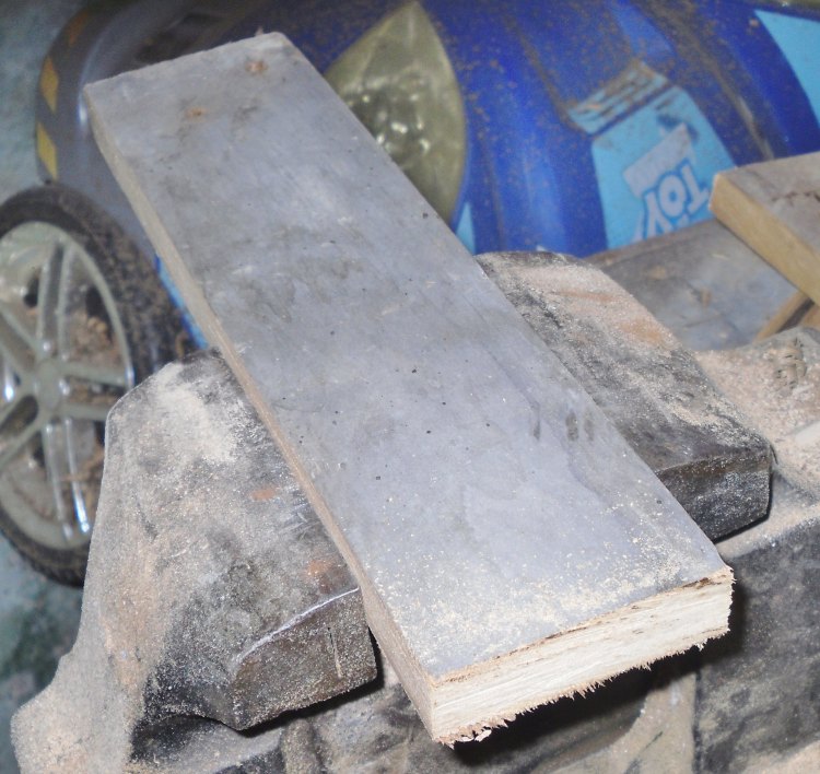

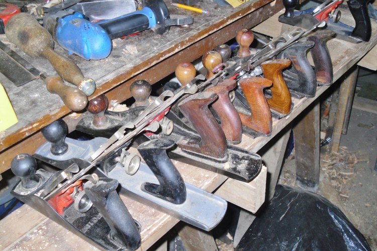

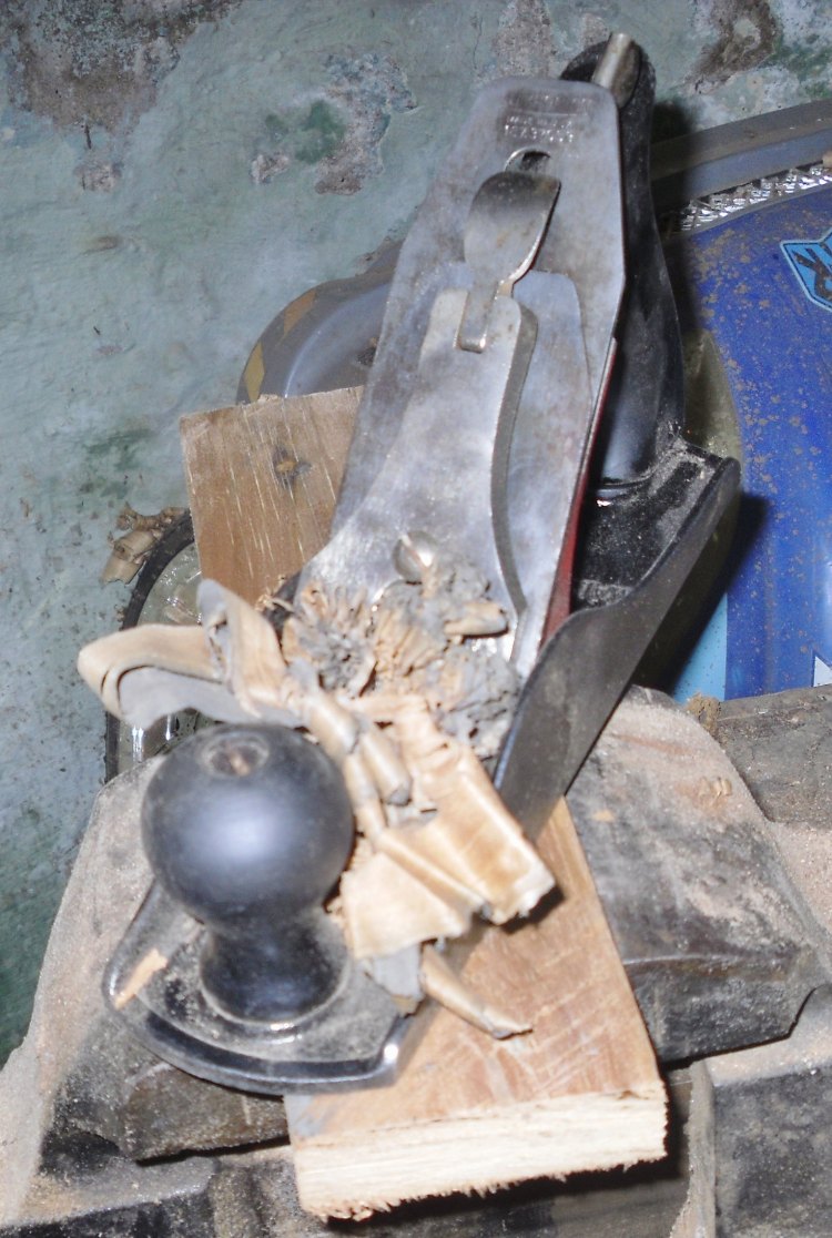

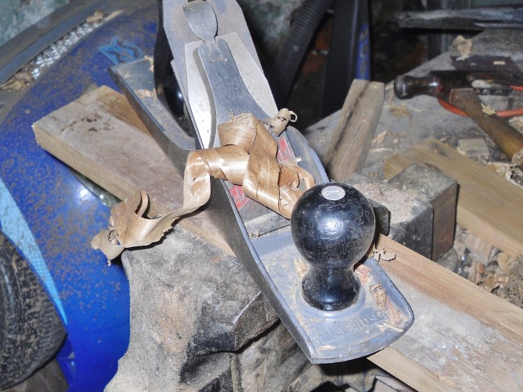

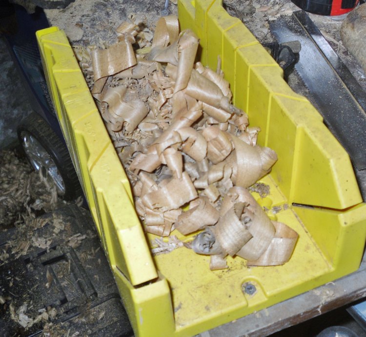

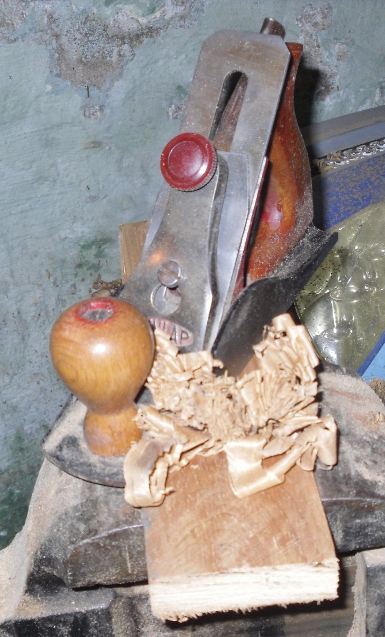

 Went to try out a couple planes on some Pine.    It was to give them a break from all that oak the other day.   Had a couple 1x4s that were a bit weatheredning-sdc14495-16039-64.jpg?width=750Just a bit.   Decided to clean them up, by first using a Jack planening-sdc14501-16039-99.jpg?width=750Mr. Bailey was waiting on a sharpening, so a Handyman was used.  Same 2" wide iron, just a different name on the lever cap.   It did a decent job of making shavingsning-sdc14502-16039-2.jpg?width=750on all four sides of the pine boards.   Got things cleaned off. Now what?   Oh yeah, maybe smooth things out a bit?ning-sdc14496-16039-4.jpg?width=750This is a "Companion" #4,  sold at Sears, made by Stanley on the same line as a Handyman #4.    I used the Companion because I can set it to take a finer shaving than the Handyman #1204.   A few swipes revealed a knot of grain on one end.    I think I have the right plane for "Knotty Wood"ning-sdc14498-16039-30.jpg?width=750West German ironed Dunlap #3.    Also sold by Sears, almost the same time frame as the Companion line.     This one, however was made with a "York Pitch" in the way the iron is tipped forward @ 50 degrees, instead of the normal 45 degrees.    Seems to like working on strange grain areas.   Iused a few other planes today, just to find out who was needing a trip to the sharpening centerning-sdc14503-16039-78.jpg?width=750That #5 Bailey needs it, and the Union #3.    There is a Handyman #1204 hiding at the top of the picture.  Hiding?  Because it needs sharpened the worse.     Just one big happy Family...
