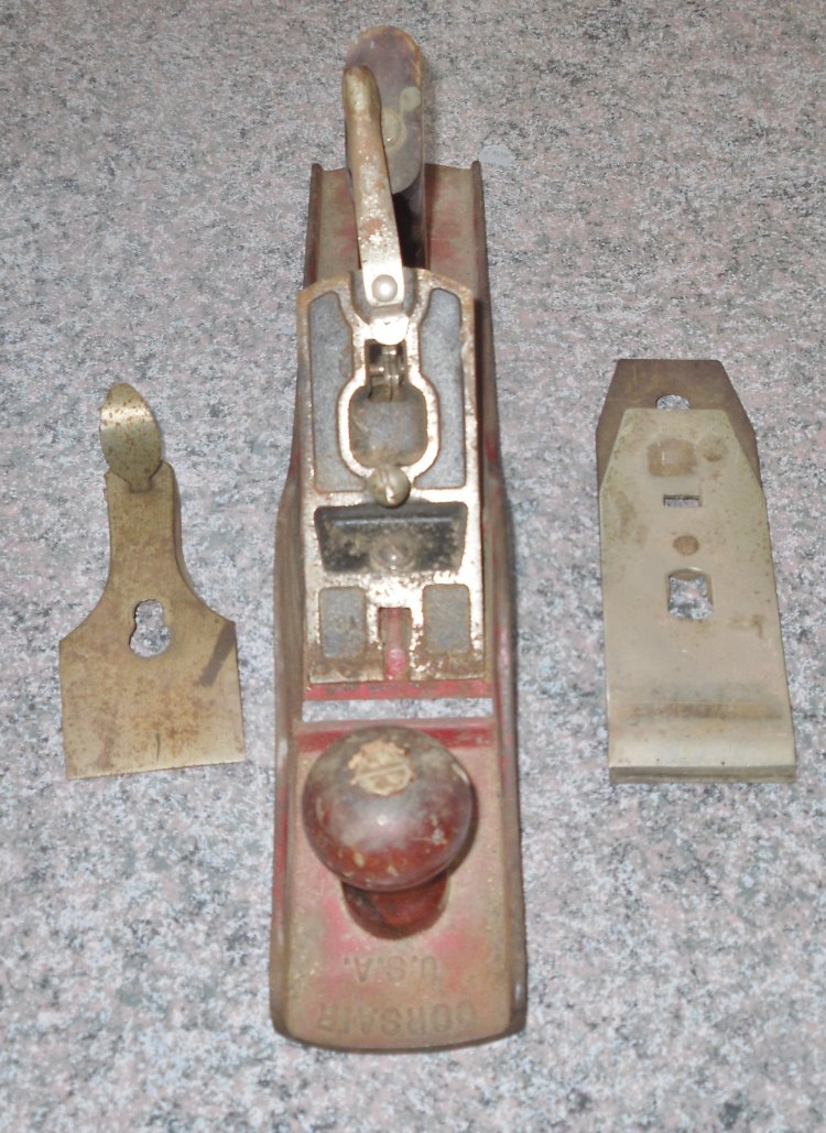

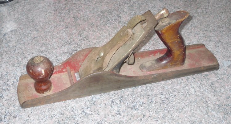

March 9, 201313 yr comment_15969  Is NOT off to a good start.   One store had a little #3 sized plane, by Worth.    Bottlecap adjuster and all.  And, they wanted almost $18 for it?    Pass. Restore Store had five handsaws, most were worth somewhat less than the $5 they wanted for it. Pass. Another place:  One could smell the rusties on the way in the door.  kept looking, high and low.  Hmmm, I can smell it, where is it?   Ah, hidden on a bottom shelf!a RED jack plane.   Made by/ for Corsair.   $8 out the door.  Brass adjuster wheel, real wood handles.  Took it apart when I got back to the shop:I never have seen a frog with a single bolt holding it.   But, there it is, a single bolt.   There is not much wiggle room either, it slides just a little bit, back and forth.  The iron has a Stanley "Clipped corner" logo, on the back side, not out front where it can be seen.   I sharpened the iron, and flattened it a bitLength is 13-3/4" long.  Iron is 2" wide.  I might finish stripping the handles, and add a coat of red paint to the body.  Might be headed for Ebay..... Planer? I'm the 'planer', and these are what I use... Report

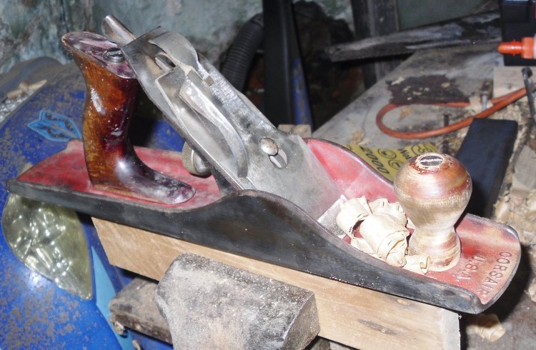

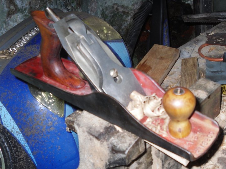

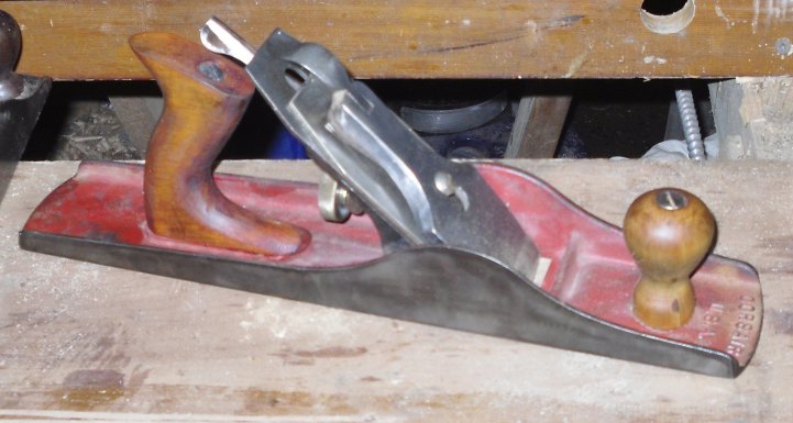

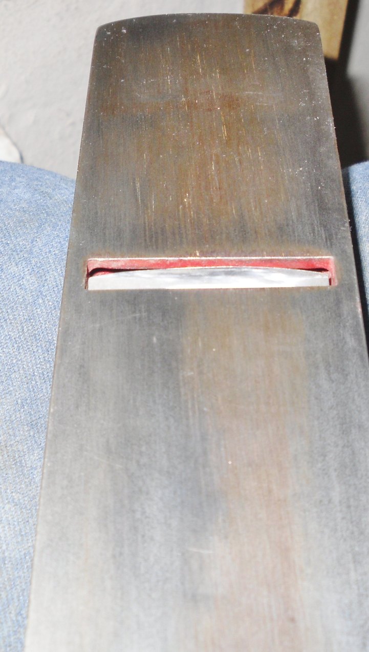

March 12, 201313 yr Author comment_15971  I have a couple more on the way, LOL.  Anyway, Got the handles cleaned off, and a new coat of BLO added to themiron has an 8" radius camber on it, now.   Took it for a test drive on some OakMaking Moxxon Curlies.    Needs a new coat of red paint, yet.    Then it can take it's place with the others.. Planer? I'm the 'planer', and these are what I use... Report

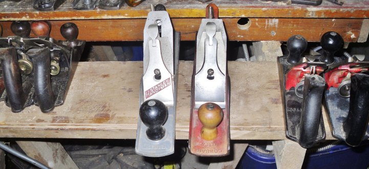

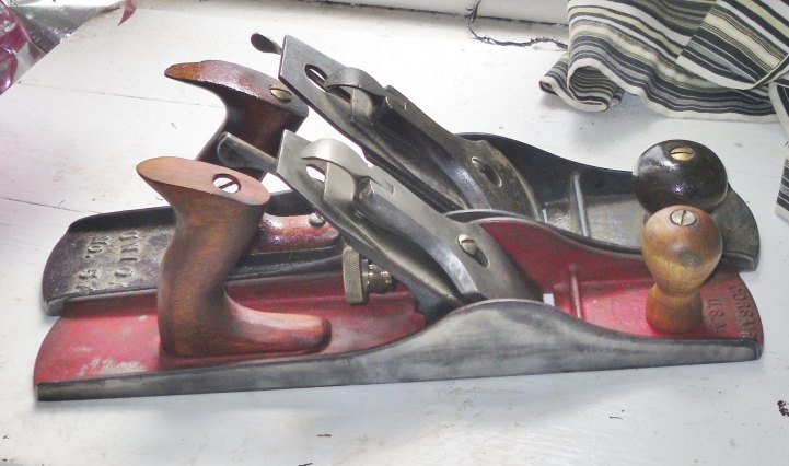

March 13, 201313 yr Author comment_15970  Iron has been cambered upAnd the newest Jack Plane has been "Chillin'" with the oldsters About a 1907 Union #5A, a #5-1/2 sized "Super Jack" plane.  It is set up more as a smoother. Planer? I'm the 'planer', and these are what I use... Report
