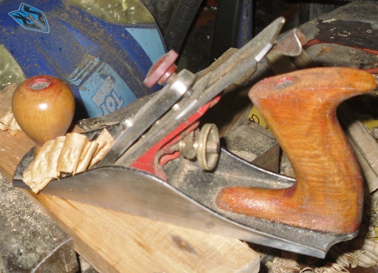

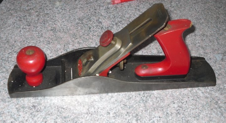

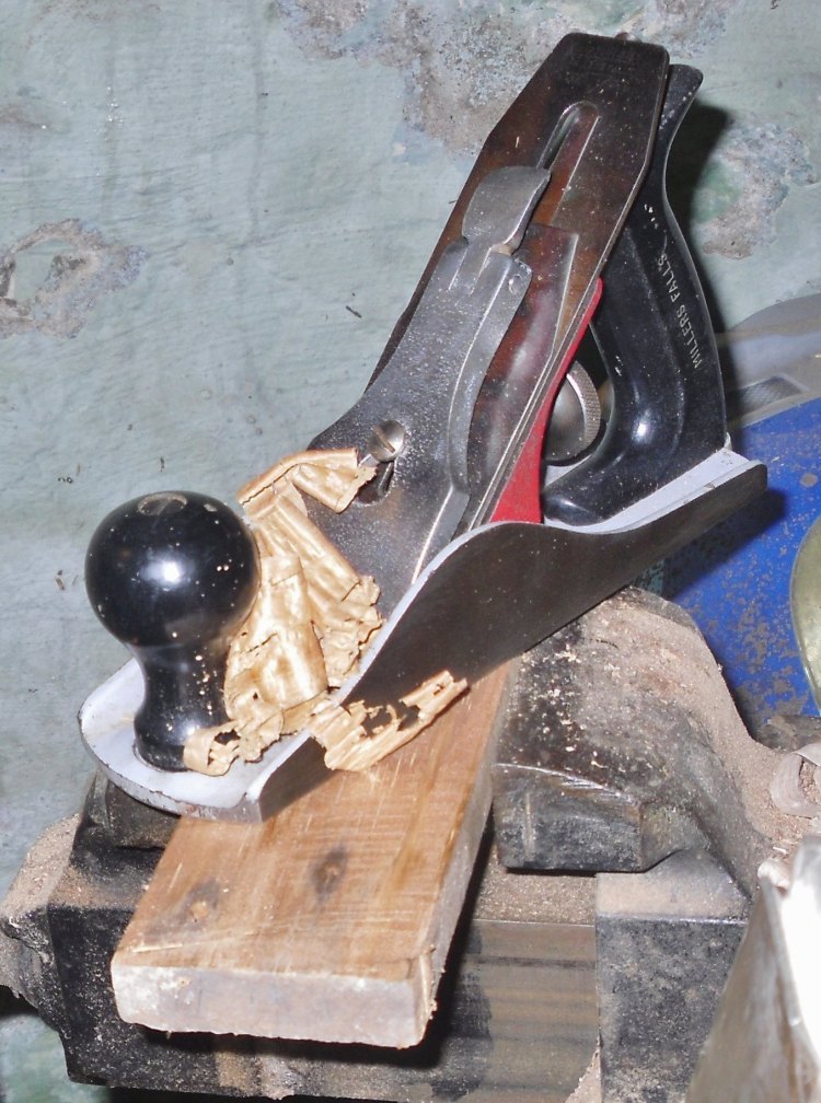

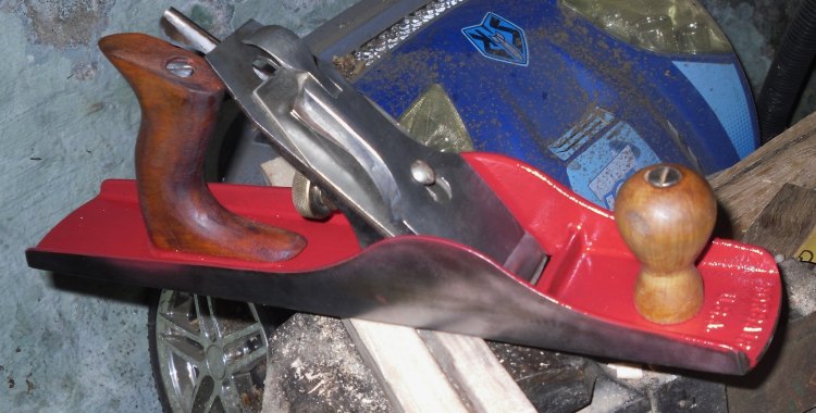

March 17, 201313 yr comment_15642  The Corsiar #5 jack plane now has a sharp, cambered iron, ala Chris Schwarz.   It also has a fresh coat of Barn RED paint on the base castingRemember, this was just an $8 rust bucket. Next: A Millers falls "V" line plane, all sharpened up, and ready for workSome squirrelly grained Pine.   No chatter, just nice, easy to cut shavings.   Not even hard to push along, even.   Ok, one last plane, for nowMy $8 York pitch Dunlap #3.   Once the iron was sharpened up, makes nice shavings, with very little effort.    I do have it's bigger relative on the way.   Looks the same, just in a Jack plane size. $15 for it, though.     jack plane prices, i guess.  Just won a Millers Falls #9 tonight.   Be here late next week. It is the same size as a Stanley #4.     Just something about those M-F planes I like.    = Planer? I'm the 'planer', and these are what I use... Report

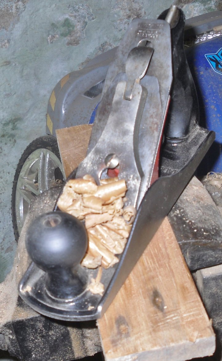

March 17, 201313 yr Author comment_15645  Chatter marks on that Pine board came from a Companion #4 I was also working on.It had issues of where the chip breaker and the iron were meeting up at.   Allowed quite a bit of wood chips to get stuck between them.   Took awhile to get things to mate together better.    Hole where the CB's bolt came through had a ridge from being threaded.    Ground that flat.    Edge of the CB needed bent just a hair, and regound to meet the iron, without any gaps.    Chatter is from the frog not be set right.    Had it too far forward. Since moved it back a bit.  May be heading to Ebay????? Planer? I'm the 'planer', and these are what I use... Report

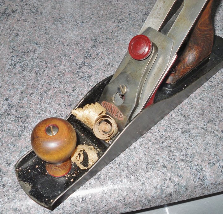

March 18, 201313 yr Author comment_15643  The Dunlap #5 is now doneand making some curlies.    Looks a little better than when it came in the door?What is with all these RED handles?     Was there a Marine stationed in the wood shop where all these planes came from? "Paint it Red, and a Marine will fall in love with it" sort of thing?  Red handles, and Red frogs, sheesh.... Planer? I'm the 'planer', and these are what I use... Report
