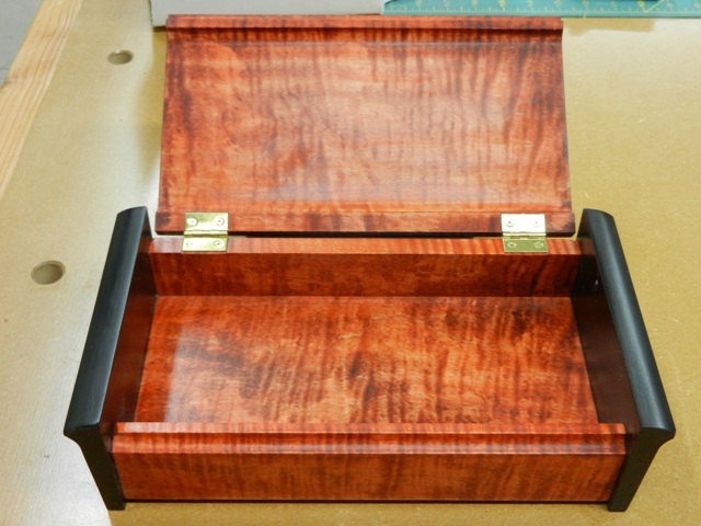

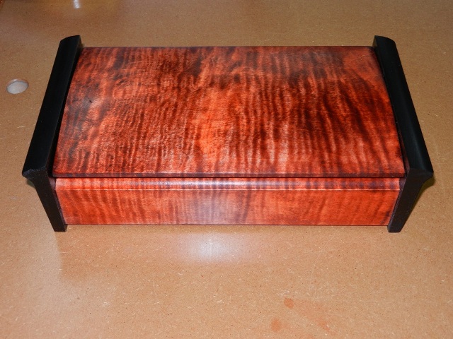

I used dye for this quilted maple jewelry box but I mixed it with denatured alcohol. You can mix it with water but the alcohol dries faster. As far as raising the grain, I wiped the box with alcohol and that raised the grain and then I sanded and applied the dye. The finish came out very smooth. I think dye comes out more even. I wish I had used it on my roll around tool cart and I wouldn't have had a blotchy finish.
I really like the evenness of the color on that Maple.
Mike did you spray the dye or wipe on or how did you apply it?

John I used a foam applicator and allowed the dye to sit until I was satisfied with the shade and wiped the excess off. I suppose you could spray it but wear gloves and cover anything you don't want dye on.

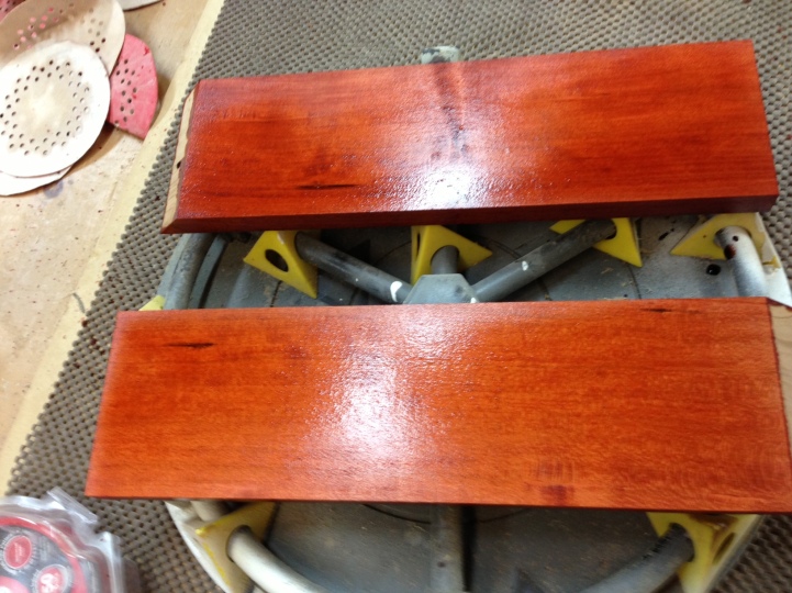

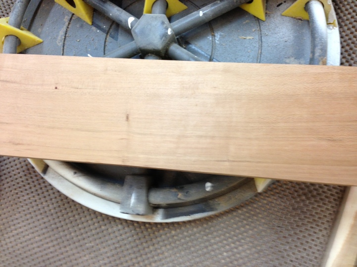

Well I had a couple of boards I had sanded and raised the grain on with DNA. I brushed on some of the Antique Cherry Red Dye tonight on the Cherry boards.
Here is one of the boards prior to the dye.
ning-beforedye-15602-5.jpg?width=721And here are a couple of the boards with the dye brushed on. I'll take a shot in the morning when it dries.
ning-afterdye-15602-97.jpg?width=721I mixed the dye with hot distilled water last night and let it sit all night to cool down. I did use a stirring stick to mix up the dye after it was put in the water. I put in half the water, then added the dye, put in the rest of the water and then stirred.
So in the morning we will see how it works out.

Lookin good John! It'll dry in about 20 minutes and you'll be able to see how it looks before morning if your up still up, I love the color so far!

It has a pretty deep color to it John. I think I am going to really like it. Can't wait to see it dry and with the Shellac and Varnish on it.

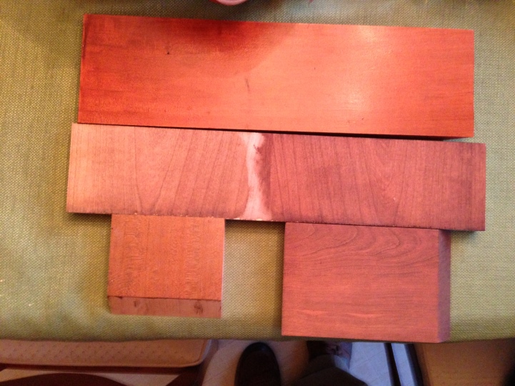

Looks like I am going to have to change the color on the pulpit. The Cherry it a little too red for the place it is going. I have found out that everything that is in there is a dark oak stain. It hurts me to color cherry to look like oak.
Here are a couple of sample colors
ning-sample-15598-56.jpg?width=721The top board is the dyed cherry.
The board in the middle is the Cherry plywood and has a Chestnut stain on the left and Dark Mahogany on the right.
The two smaller boards at the bottom are solid cherry with the Chestnut on the left and the Mahogany on the right.

You definately have to put Jacobean on it!!! :-)
