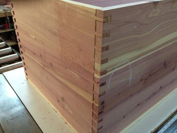

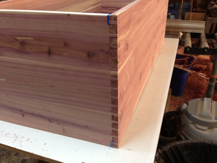

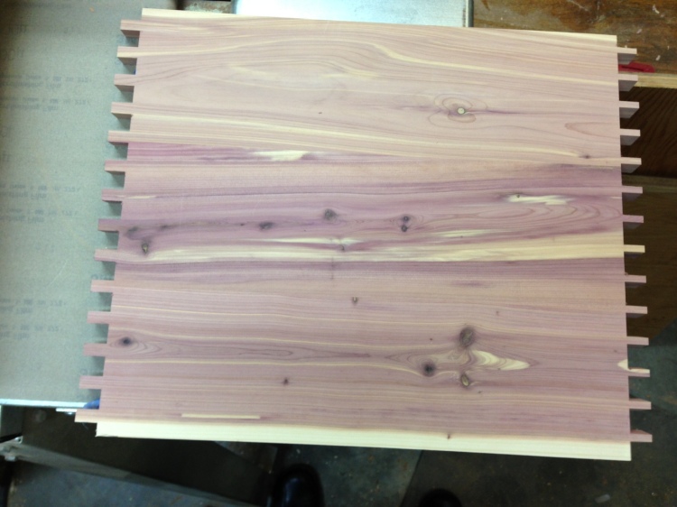

March 18, 201313 yr comment_15590 So this weekend I was working on several projects, which right there is a problem. But I was routing some dovetails in the panels for a new cedar chest. So after running them through the drum sander, they were ready to cut the dovetails in the ends. Usually I will chalk the corners so I make sure I have the chalk mark toward me and thus the tail will be cut in the correct direction. So here I am on the last panel using my dovetail jig just routing away. I got all of the panels done and was in the process of doing a dry fit when I realized, Houston, we have a problem. So this corner and the one on the other side look good, nice fit. This corner fits, but what's the matter with that other side? When I flipped the panel I turned it instead of rotating it end for end. So the tails are cut in different directions. So I will be gluing up another panel and focusing on re-cutting these. I guess I'll make a smaller chest and cut these off one end and make another end that size and use that way. Just can't do it on the one I am working on. Oh well it happens. John Moody Site Administrator John Moody Woodworkshttp://www.johnmoodywoodworks.com Report
