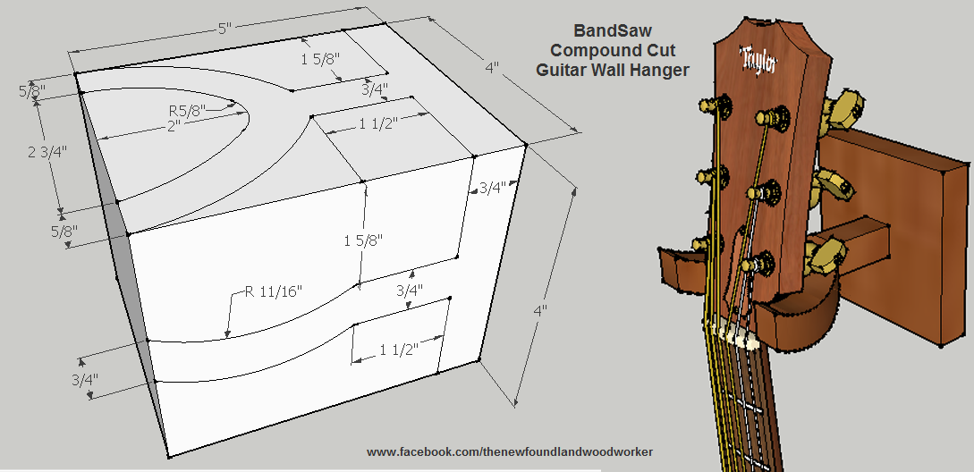

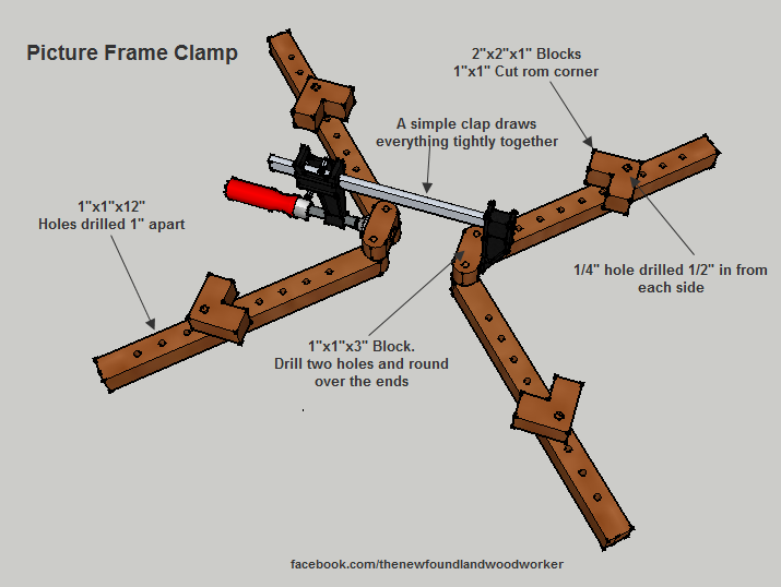

March 19, 201313 yr comment_15545 Hey guys/gals, I have created a couple of free plans that I thought I would share with you. One is a Picture Frame Clamp. The second is an Original - It's a Guitar hanger. You can buy these in music stores but I though, as long as I am a woodworker, I can make one. Here are a couple of sketcup drawings. Hopefully they interest you. Kind Regards, Michael and Matthew Agate (Newfoundland Canada) Report
March 19, 201313 yr comment_15556 Cool!I really need to make that frame clamp. The one I have uses all-thread and wing nuts. It's a real pain to adjust.Thanks!!Lew Kauffman-Wood Turners Forum HostTime traveler. Purveyor of the world's finest custom rolling pins! Report

March 19, 201313 yr comment_15554 Great clamp, and a nice, innovative guitar hanger. Thanks for posting them.Gene'The true soldier fights not because he hates what is in front of him, but because he loves what is behind him.' G. K. Chesterton Report

March 19, 201313 yr comment_15552 Thanks for posting Michael & Matt! I really like the frame clamp and can put it to good use. I'll have to add that to my list.Thanks again!www.thepatriotwoodworker.com Proud Supporter of Homes For Our Troops Report

March 20, 201313 yr comment_15549 The guitar hanger will come in at the perfect time. I am working on new music stands and such for our Church. This can be adapted for the guitars and bass at out church. Thank yo so very much.Wayne MahlerGod bless and protect our troops that serve so we can be free. Report
March 20, 201313 yr comment_15547 nice guitar hanger!! that goes in my TO DO file.That clamp kinda looks like it's in the way though, lol Report
March 20, 201313 yr Author comment_15546 All depends on the clamp you use Perhaps a C clamp could be efficient  dragon1 said: nice guitar hanger!! that goes in my TO DO file. That clamp kinda looks like it's in the way though, lol Report
