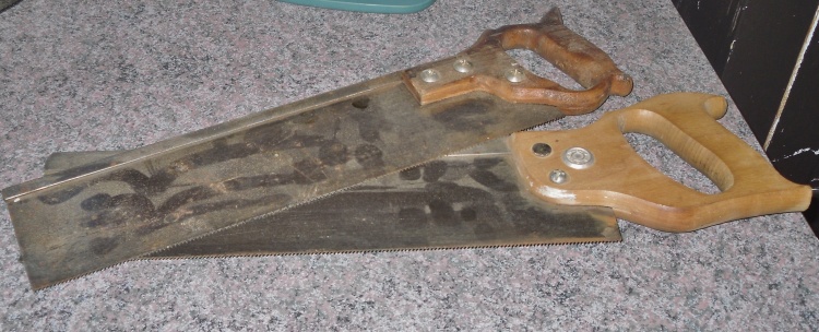

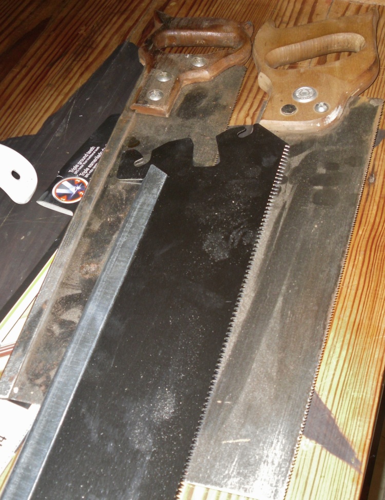

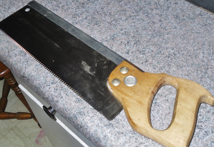

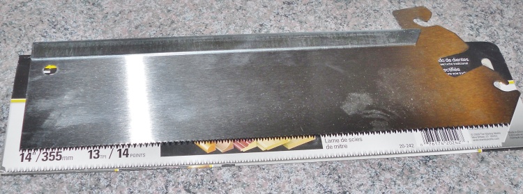

Ok, went out to a couple stores today, mainly for sanding belts.    Spotted a "Project" laying on the bottom shelf.    Now, first a look at the worst saws I have:ning-sdc14606-15446-69.jpg?width=750Pretty things, ain't they.    Duller than a cold butter knife, too.    And the Project?ning-sdc14607-15446-45.jpg?width=750 A brand new, handleless saw blade!  Needed a bit of trimming down, though. ning-sdc14608-15446-54.jpg?width=750Had to decide which saw to restore.    After that, remove the handle from the bad blade, use it as a pattern to trim down the new blade.   Over to the grinder, and grind away what wasn't staying.     Hey, the blade costs a whopping $6.     I could afford a little blue here and there.   After I liked the shape, and things cooled down,  over to the drill press, to burn a couple old drill bits.    One learns real fast how sharp a bit is, when drilling saw plates.     Got the three holes drilled, anyway.     Installed the handle back on the new blade.    Scrounged three bolts, and called it done..ning-sdc14609-15446-34.jpg?width=750Medallion says "DISSTON" USA    Might be from the HK Porter years.    Old handle, meet a new blade.  Took just about an hour to do.
