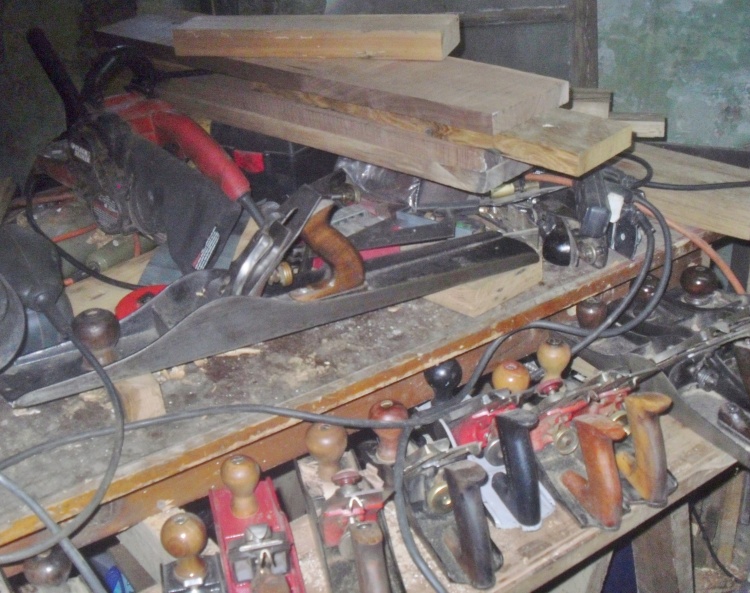

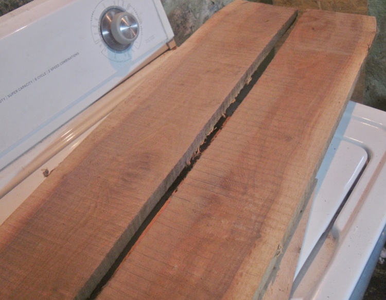

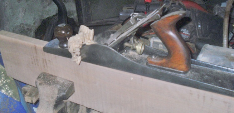

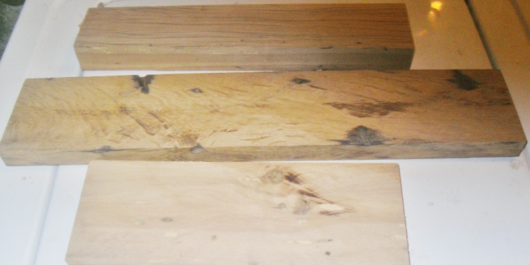

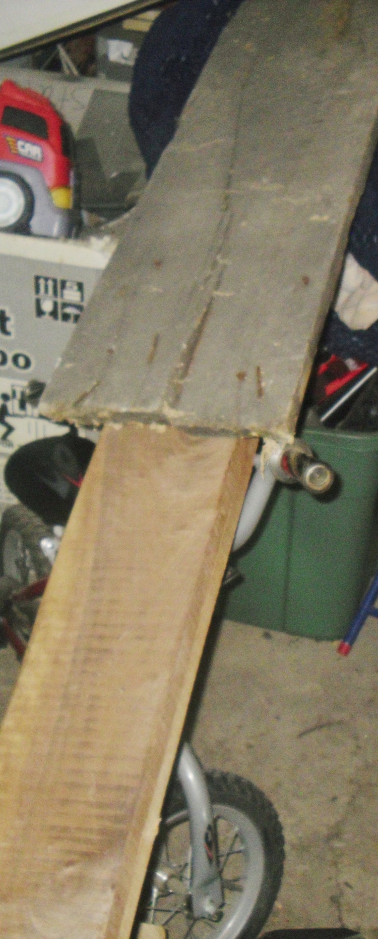

March 30, 201313 yr comment_15036  Seems I have some "Good wood' in the shop, for a change.Black Walnut.   4/4 by 6" by 90" long.   Cut from the same log, no less.  I have three blanks cut from one of these planks.    about 30" long.    Might get a fourth one, if the top blank needs some more width. Planed the edges, trying to get a good glue joint area readyA re-built DE6c did a lot of the work.   A smooth plane cleaned up afterwardsStacked the three blanks to one side, along with some "secondary wood"Secondary wood?  Oh yeah, got a few pieces of that as wellLook good on this face?Some of those black marks are nails.  I also brought home another plankAbout a 1 x 10 by 48".   Maybe a dozen cut nails in it, and a nasty looking split.    Resawn into some braces?      Out of sight/out of mind?   I still have a few leftovers of oak sitting around, as well.    Thinking maybe a table out of Walnut, maybe some oak accents?  My version of "Sketchup" is called "My Brain Cell".   Thats right, "Cell"!   it is about all that is left to work with on these things.   Trying to decide whether to face plane all the blanks for the top first, or glue it up and THEN face plane. Don't have much of a "planer" in width.    But i think those #6 fore planes would work just as well.   There are a few knots lurking in the walnut, so that york pitch #3 will get it's chance at those. Stay tuned, this might get to be fun.... Planer? I'm the 'planer', and these are what I use... Report

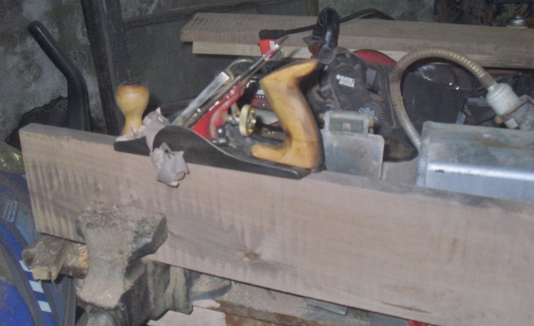

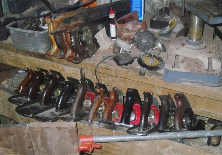

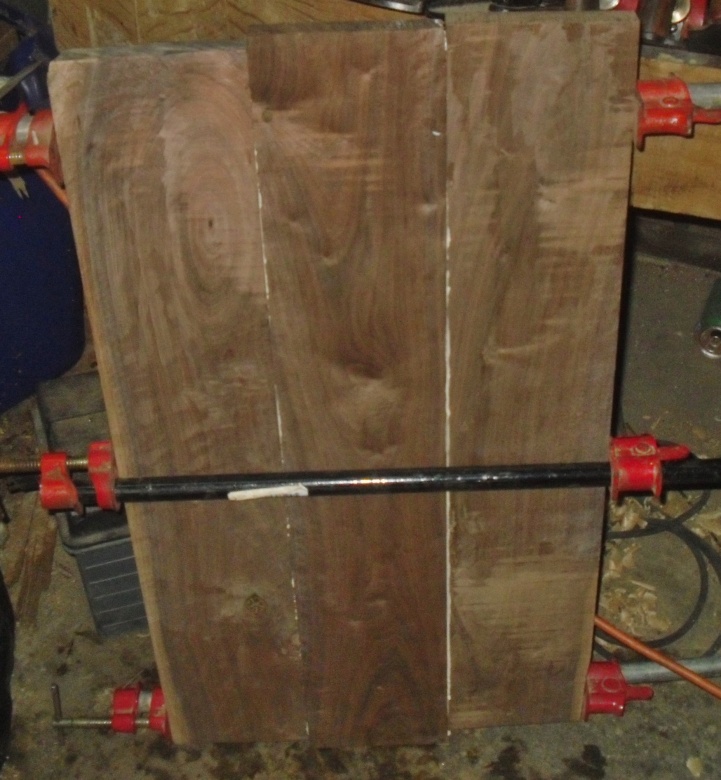

March 31, 201313 yr Author comment_15042 Lew: the trick is to get them back off, before she sees them, LOL Ok, got three blanks halfway planed smooth, and edge jointed.    Time for a glue up?Hey, I said "Halfway " right?   Ok, as for the ends, Brain Cell is saying something about a gentle curve being cut on the ends?   Will let this panel sit until tomorrow, then a little more work on it.   Right now, since it is "Breaktime" in the shop, most of the toys, er, tools are put awaySomething about "Red Frogs"?    And, to think, there are two more Red ones upstairs.... Planer? I'm the 'planer', and these are what I use... Report

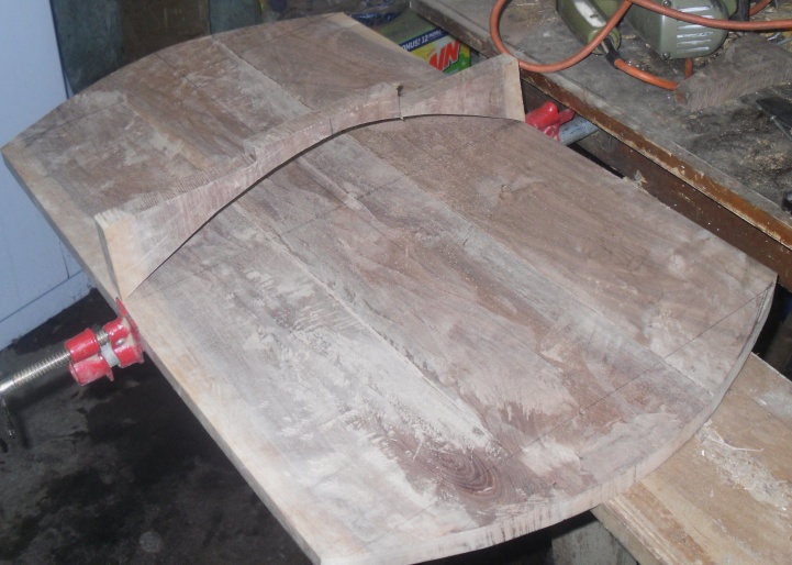

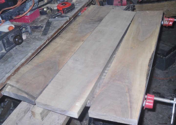

March 31, 201313 yr Author comment_15040 Top is out of the clamps.  Face side is planed smooth.  Underside is a little worse for wear, though All marked up, centerlines drawn everywhere.    That is a cut off sitting there.  Thin piece of plywood & three screws set the curves to be sawn off.   Not even sure what radius it is. Got three more planks to work over, as well.Pretty, ain't they?   Aprons and other parts will come from these.   Might have enough for some legs, as well.. Planer? I'm the 'planer', and these are what I use... Report

April 1, 201313 yr Author comment_15038 Walnut is 4/4 rough.   Getting it down to almost 3/4" thick, once I have things smoothed out.    Still need to get a few parts out of the three blanks that are left.    Trying to build a simple table, from just two planks.    Legs are going to be the hard part.Planer? I'm the 'planer', and these are what I use... Report
