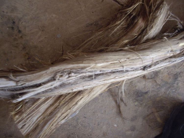

After I innocently commented to my 1/2 bro., while hiking around his area of WY, that I wondered how those huge sage brushes would work up, he cut a large chunk of a trunk for me.
This first picture is what I started with. Nasty stuff!ning-rawsage-14577-77.jpg?width=750

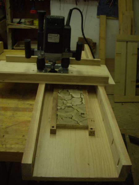

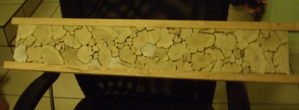

After cleaning it up and slicing the trunk(s) into oysters, they were glued to a piece of 3/8" scrap plywood.
Here is a quickie router planing jig. It worked quite well to level out the oysters.
After planing, the voids between the oysters were filled with turquoise and epoxy. Then the piece was cut to the lengths for the sides of the box.

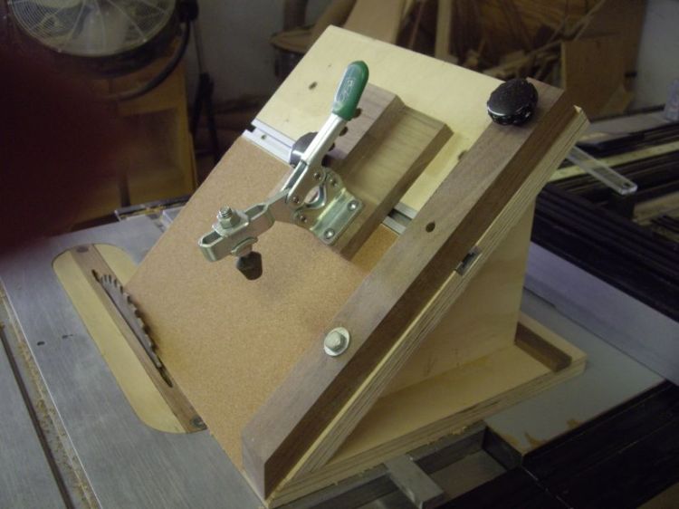

Because I have a Shopsmith with a Jointech Saw Train and router table attached, change overs to allow table tilting for 45s is a royal PITA, I made a jig to allow 45s to be cut without all the hassle. It does a great job, too.
ning-45jig2-14577-86.jpg?width=750

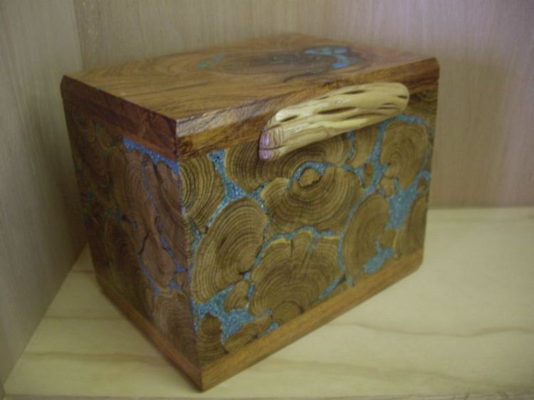

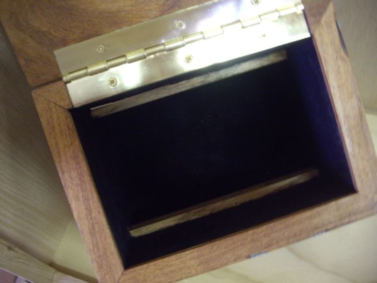

Here are pics of the finished Oyster Box.

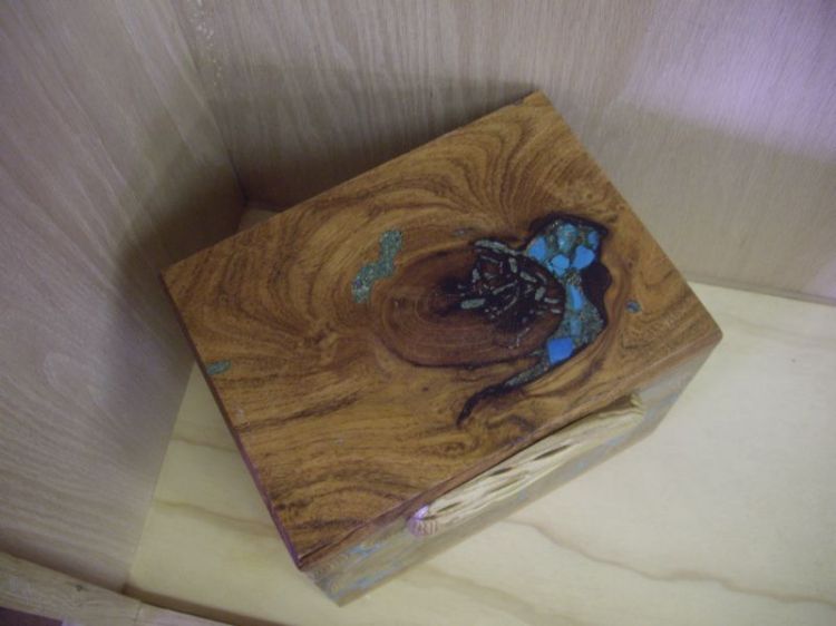

The lid and bottom are mesquite. As is the top of the opened box.

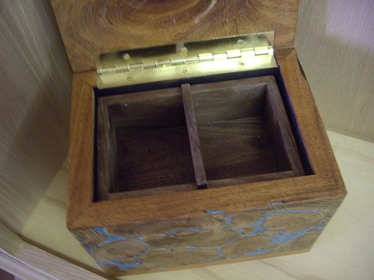

The tray is scrap walnut and the runners are pin oak.
The box measures 8" wide by 6" deep and 6 3/4" high. The box sides measure 3/4" thick. The interior is flocked black.

ning-boxtray-14577-5.jpg?width=750
