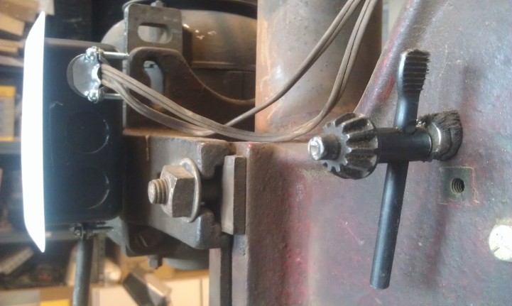

I just did some repair work on this press from my Uncle.  It needed a new drive pulley, belts, and re-wiring.
I re-wired with Jumpers from Motor to new gang / junction box, shortened the cord to remove cracked insulation, and installed a three-prong plug.
The pulley needed some elbow grease - made a puller when the 'easy' option didn't work.  The new pulley is smaller as i intend to run it on the second smallest arbor.
Hopefully the pictures will speak for themselves.

ning-gangbox-14492-93.jpg?width=721This is the gang box with the Jumpers feeding the motor.
