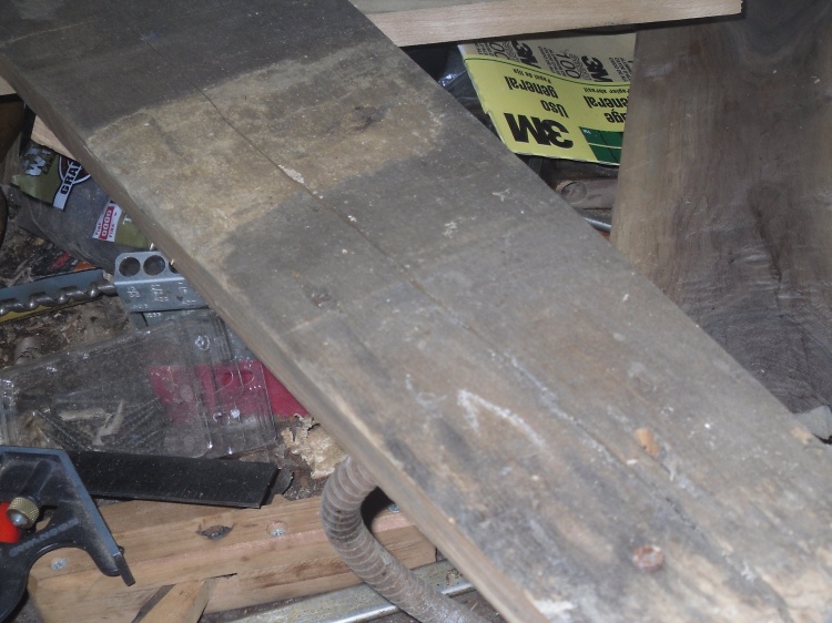

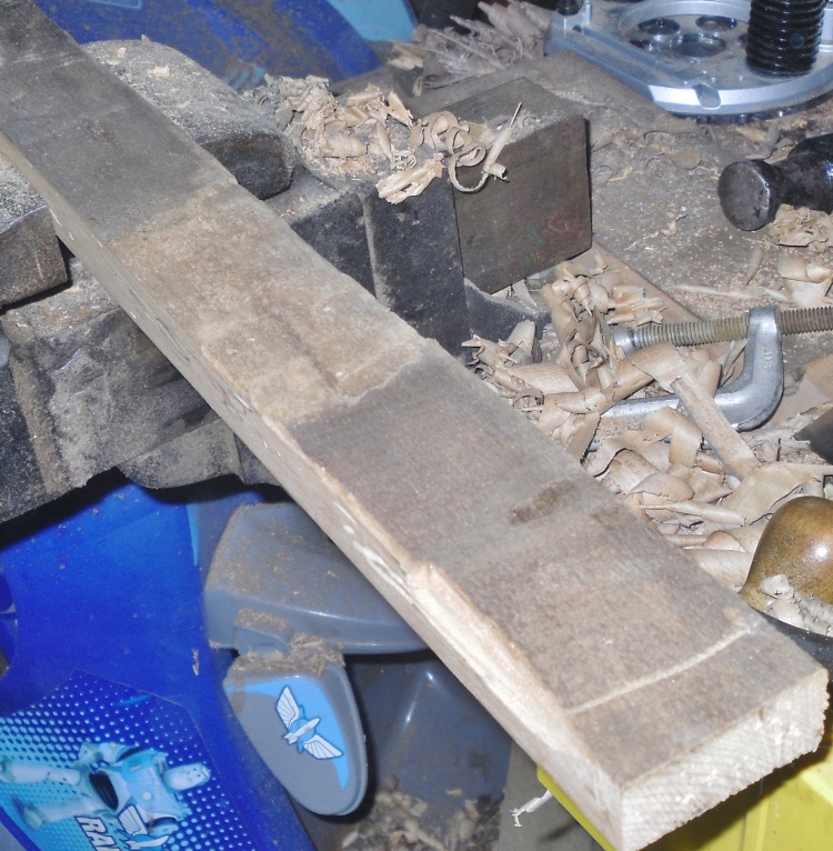

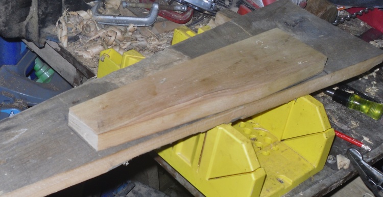

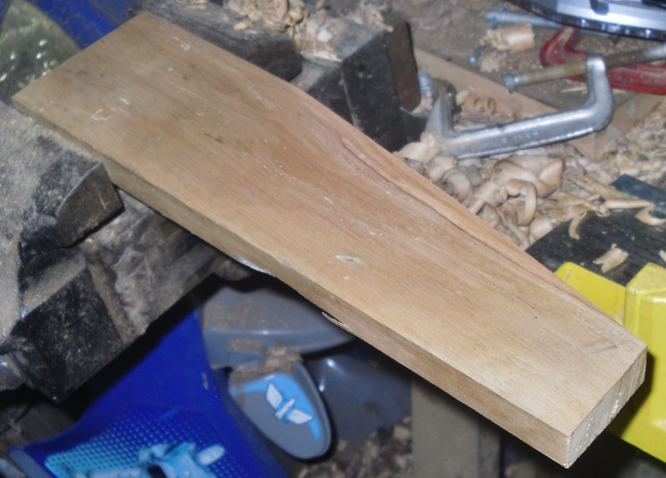

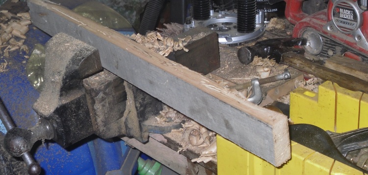

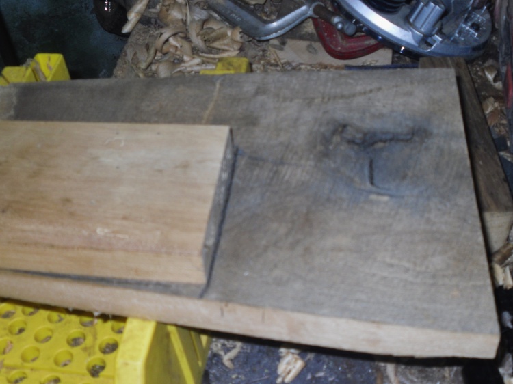

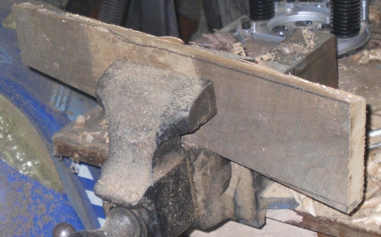

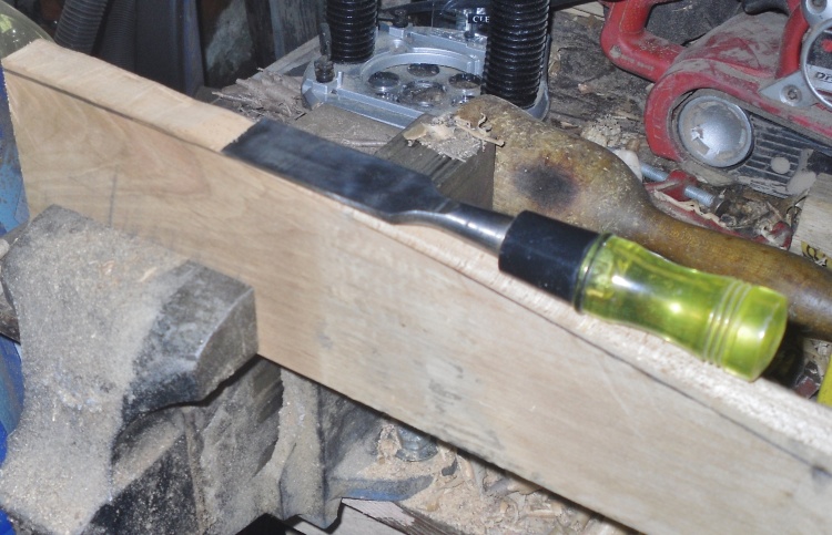

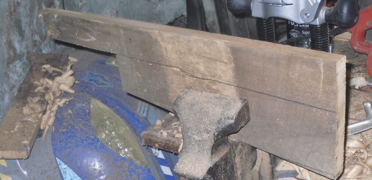

Ok the tasks today:   Sides and front.    I had to chunks of this mystery timber, maybe three pieces could come out of them.    I went from a slab like thisning-sdc14843-14470-72.jpg?width=750ugly thing, to a more "polished" chunk of timberning-sdc14844-14470-63.jpg?width=750Then, I used this piece as a patternning-sdc14845-14470-64.jpg?width=750To mark out the other two pieces.  There was a big,old knot on one end, thoughning-sdc14846-14470-86.jpg?width=750Took a handsaw and got rid of this junk.     Reset the board in the visening-sdc14847-14470-58.jpg?width=750Notice the layout line?    There is a crack that almost follows the line.  So, with a few whacks with a malletning-sdc14848-14470-60.jpg?width=750the other blank for the sides is now ready to trim down to match the first one.    No, I did not throw away that other piece.    These sides have a flat area along the top.  The sloped area is for the lid, then a flat area for the hinges and pencils to go.   To get that flat spot started, I used a mallet and chiselning-sdc14851-14470-65.jpg?width=750here is the flat area marked out.  Part of the slope also needs to be trimmed down,soning-sdc14852-14470-97.jpg?width=750Chop away the waste, almost to the lines. Come back with a hand plane and plane until the line is split.  Did both areas like this.    The faces and all the edges were also handplaned.    I do have a "lunchbox planer, but it is still out in a Pole Barn Shop.    Most of this stuff is too short, anyway.    A look at the plane in action?ning-sdc14850-14470-93.jpg?width=750This Jack plane has an 8" radius cambered iron in it.  It will take down the roughest of the rough in a few passes.  Followed up with a smooth plane.    ning-sdc14857-14470-7.jpg?width=750Both taking a break. As for the "miter box"?    Yep, used it and a "miter saw" to trim things to length.   Now, about that piece that was broken off?ning-sdc14853-14470-62.jpg?width=750Laid out a straight line.    I then had to remove the waste area, and clean the facesning-sdc14855-14470-71.jpg?width=750Roughed off most the bad areas with the mallet& chisel.   Then the two planes took over.ning-sdc14856-14470-10.jpg?width=750Nice?  That light area is a bit of dry rot.    So, the jack took things down until the rot was gone.     Now i had three pieces of the puzzle, time for a Break!ning-sdc14858-14470-50.jpg?width=750Until the next time....

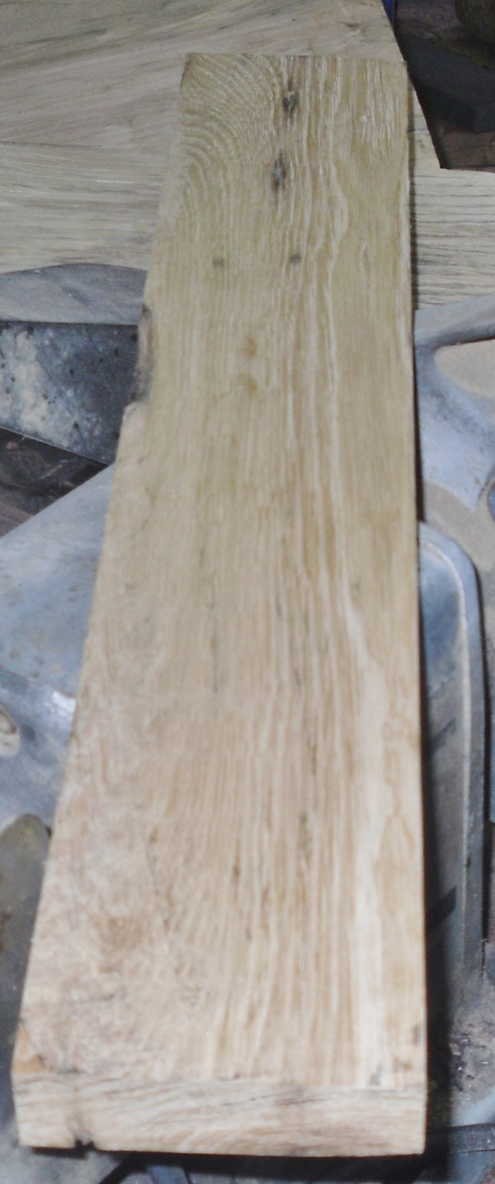

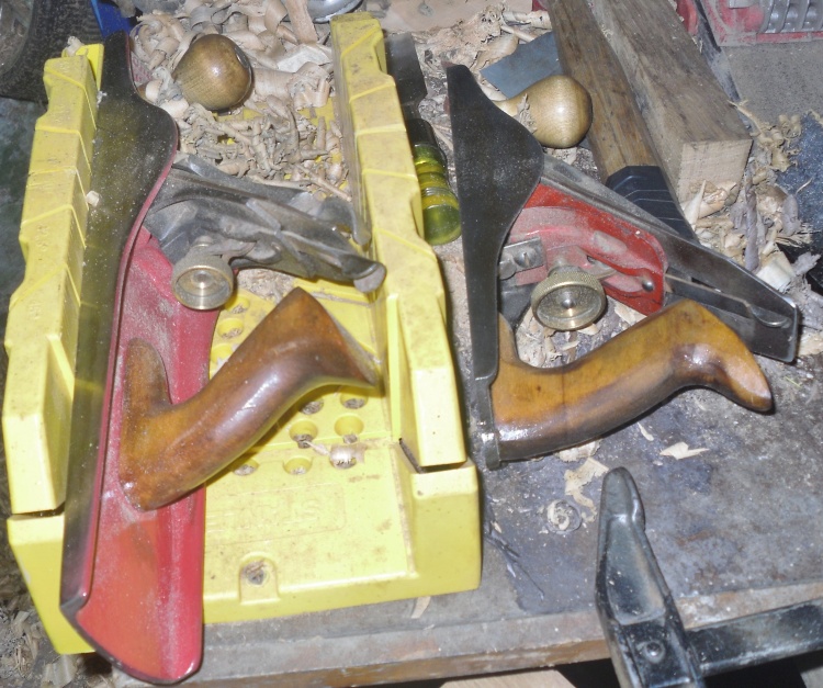

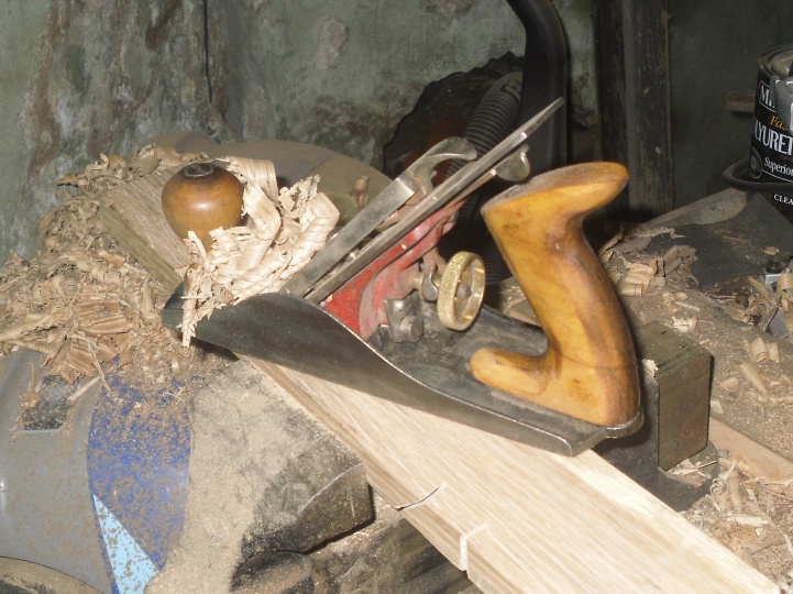

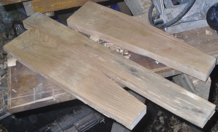

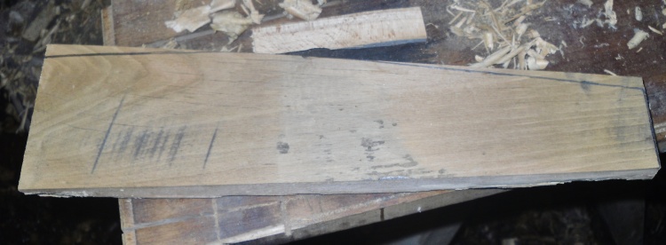

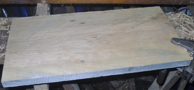

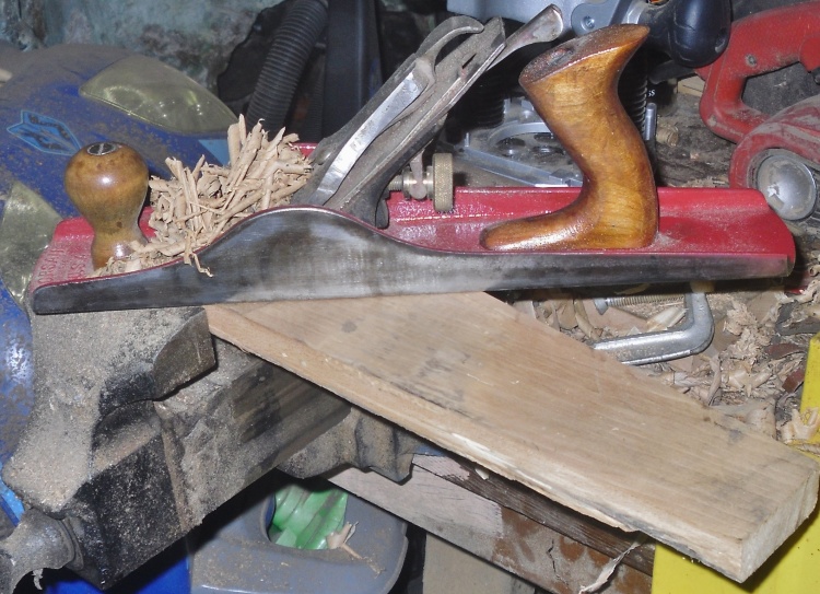

What a fight!  Went a couple "rounds" with a couple chunks of Hickory.    Came out a draw, I think.   Found one plank that was long enough, just too blody thick.    Had to plane it down from 1-1/8' thickness to 3/4" thick.     Put a couple marks in the fingers on my left hand.     But, I won that roundning-sdc14860-14475-73.jpg?width=721Kind of Gnarly?    Funny grain patterns too.     As for the other plank?   It came from the remains of a stool I tried to build.    Piece was cracked almost all the way, so I thought I could just drive a big,old framer chisel into the crack, and rive it the rest of the way.     Halfway there......OW!   Oh, I hit the head of the chisel ok, I also caught the webbing between the thumb and fingers.    Nice blood blister.    Proceeded to plane down the split area, another hole in a finger.   Plane was slipping off the board, and hitting the board again with a finger in the way.    Got one piece donening-sdc14859-14475-39.jpg?width=721At least to the point a smooth plane could work.   Son of a ......got me again!     Ok, board wins that round,  quitting time. As for the fingers?ning-sdc14863-14475-65.jpg?width=721pretty, ain't it?    Total of five marks there, including one that was hit twice.  I did make a mess on the floor, tooning-sdc14861-14475-19.jpg?width=721There is a little "creek" running through the Dungeon Shop!    I guess Igorski needs a drink, now and then.    Shavings soak up the water fast, too.     Time to put away the toys for the night...ning-sdc14862-14475-65.jpg?width=721And try again tomorrow.   Now, where they put that box of bandaids?????

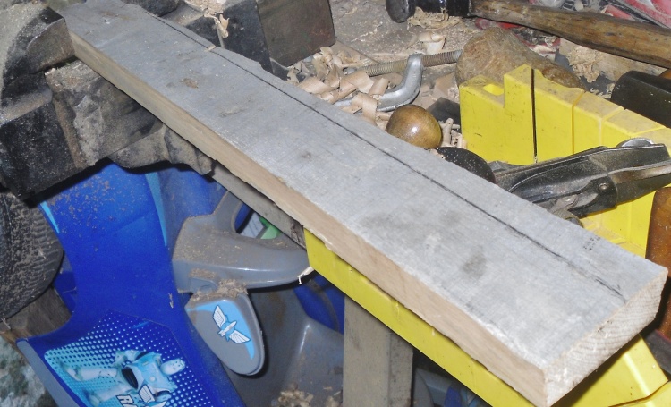

Found another, better chunk of timber today.   Took it out of the window that it was being used to prop the window open.    1x6x24"  qwso!  Took it down to the Dungeon.     Removed two old rusty nails.     Planed both faces and the edges smooth.  At least now, I won't have to plug two square holes.
