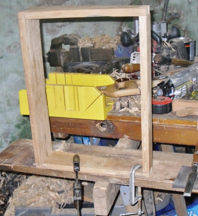

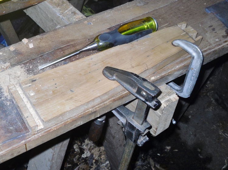

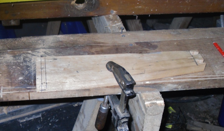

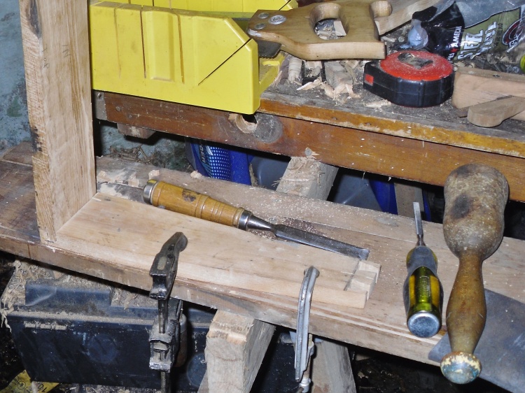

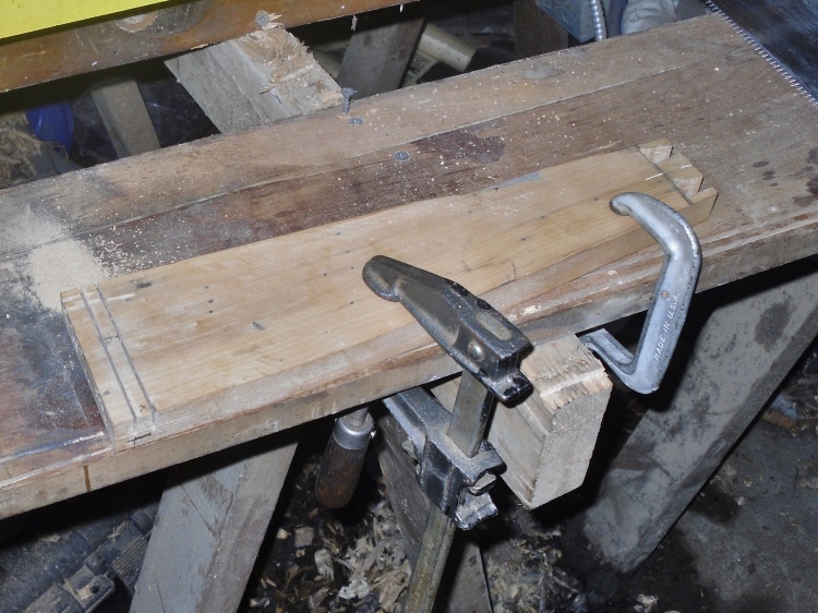

 Ok, I used the rabbet to mark out the locations of the dadoning-sdc14891-14353-65.jpg?width=750( Note to self:  SHARPEN the pencil, first)   Once all the lines in the ash are drawn..ning-sdc14892-14353-78.jpg?width=750I used a hand saw to just split each line.    wanted a little extra wiggle room to work with a chisel.  I can always cut a little more out, if needed.   i added the second clamp, before the saw got started.   I start the saw at the back, and slowly lower the blade until level, while watching to make sure i am still on the marks.  I added a screw in back of the piece, NOT in the piece, just in the bench.    Kind of a way to keep things from moving away from me, during the next stepning-sdc14893-14353-4.jpg?width=750A 1/4" chisel , and a mallet.    Knocked out the waste stuff, and then worked on the fitning-sdc14894-14353-88.jpg?width=750Just a little loose on this one.    Bottom and small corner blocks will help out here.   Repeat for the other side, and tap things togetherning-sdc14895-14353-3.jpg?width=750Progress being made??    This took almost as long to do, as writing this little post.  And, that includes stopping to take a picture or two..
