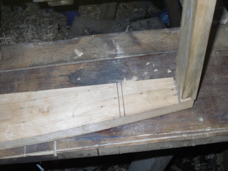

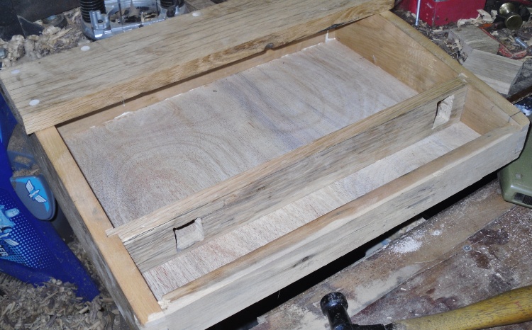

 Getting close to the "Finish Line" now.   Ran the router around the bottom edges to make a recess for the 1/4" Plywood bottom to sit in.     Got informed that a divider was also needed...

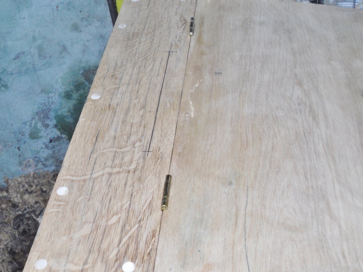

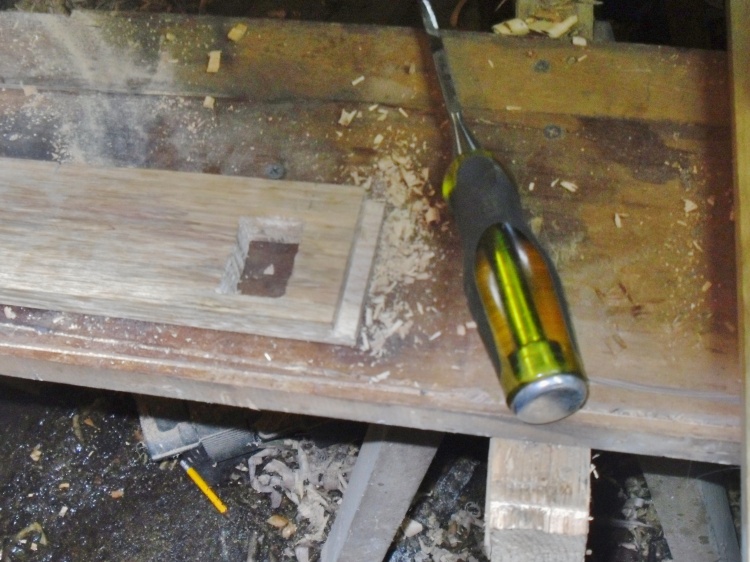

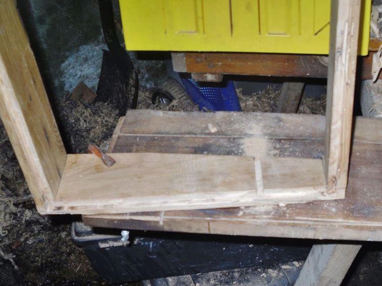

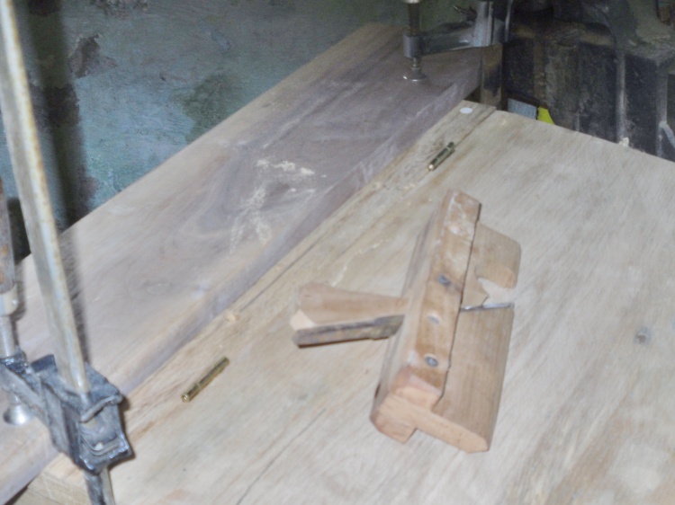

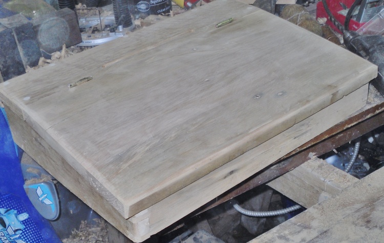

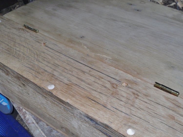

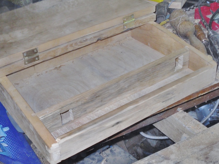

Laid out for a dado for the divider.ning-sdc14906-14274-16.jpg?width=750Then a handsaw and chisel to clean it outning-sdc14905-14274-18.jpg?width=750and then repeat for the other side.   Found a piece of scrap wood that was long enough ( barely) and even had a pair of finger holes already in it.     Cut to length to go in it spot, but needed a rabbet to fit in the dados.   So, more handsaw work, followed by the overworked chiselning-sdc14907-14274-19.jpg?width=750Now comes the fancy part.  Seems the divider was too wide, er, tall.    I marked where it matched the slope of the sides, set the divider in the vise, and planed down to the lines.   Top edge now has an angle to match the sides.  Installed the bottom with a little bit of glue, and a few brads.    ning-sdc14909-14274-27.jpg?width=750Next, the fixed part of the lid.   Installed with screws into counter bored holes, and covered up with plugs.  Like the ply's grain pattern?   I then marked out for a couple of hinges,  cut the mortises with a chisel, and installed the hingesning-sdc14910-14274-33.jpg?width=750Pencil line is to lay out a pencil groove.    Drilled a couple 3/8" holes, until they were just barely startedning-sdc14911-14274-23.jpg?width=750set up a fence to guide the plane alongning-sdc14912-14274-94.jpg?width=750work the plane along until it stops cutting a groove.   Used a rolled up piece of sanding belt to smooth out the plane marks.   open the lid to clean things outning-sdc14914-14274-89.jpg?width=750then close the lid, and add a beveled edge all around, with a block plane, and a sander.   ning-sdc14913-14274-86.jpg?width=750Just about ready for the finish???
Love the pencil groove Steve! Looks like it is a very useful piece of furniture now!
I love the way you share your technique and the pictures. You are doing a great job and I love the hand tool work you are sharing. Way to go Steve.
