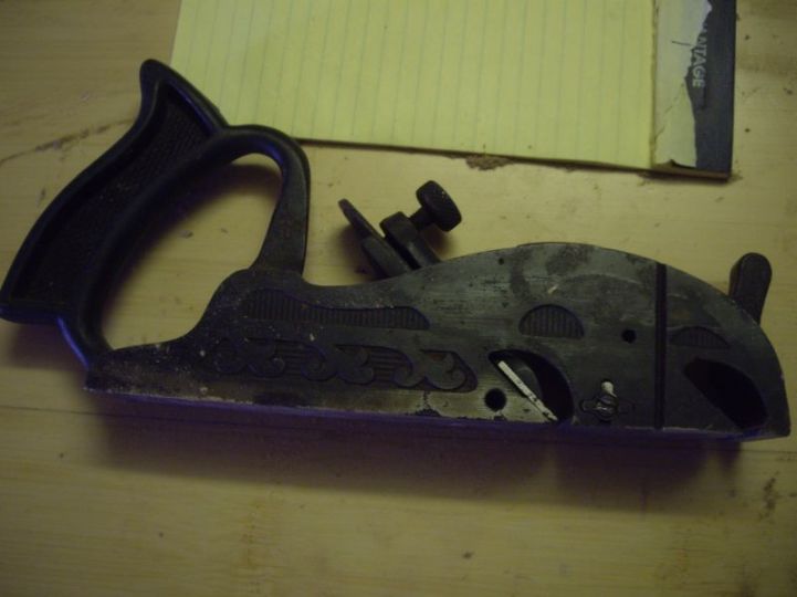

Recently acquired a rabbet plane (I think). It is supposed to have two blades It has one and it's marked Craftsman with sort of a wavy font. No frog for the second blade, either. Also the fence is gone. It's all metal including the handle.
On the right side of the body is a neat scroll pattern in the metal.
Could find no other markings on the body.
I paid too much for it, but I'd like to restore it. Can anyone point me to a place to look for parts?

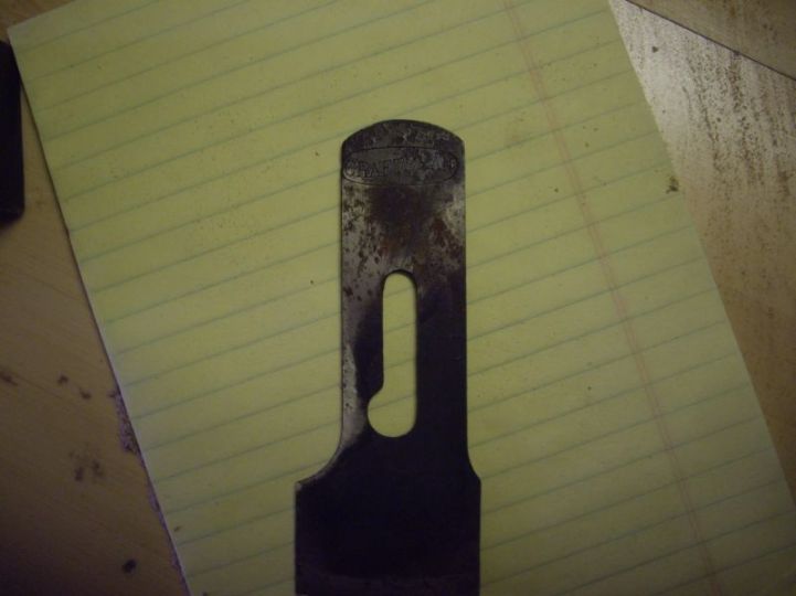

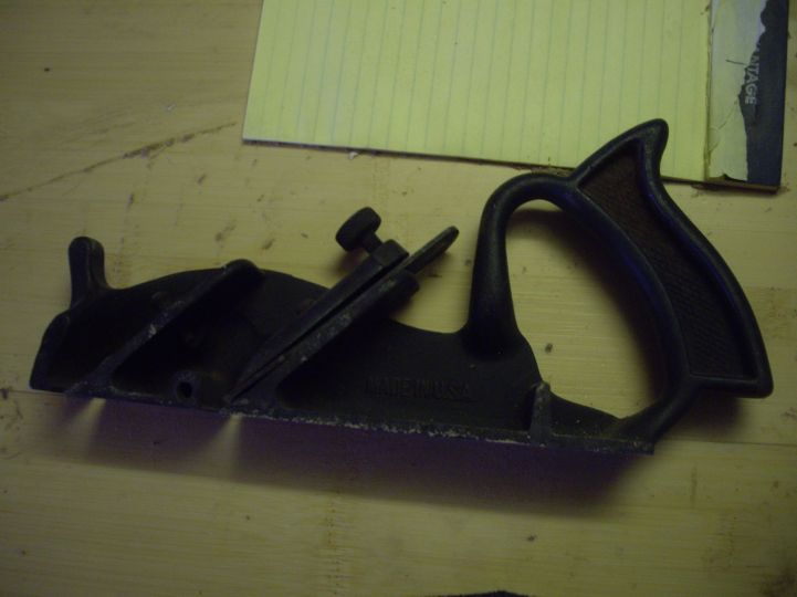

Take a look. Do these help to identify it?
ning-plane2-14195-96.jpg?width=721
ning-plane1-14195-43.jpg?width=721
ning-planeiron-14195-25.jpg?width=721
Gene

Made by Sargent.     A Number #79???
Couldn't see any numbers or lettering on the plane body. Only "Craftsman" on the iron.
I'm assuming the bigger hole is for the fence but, there is no screw (or hole) to lock it in place. The smaller hole is a mystery to me.
Gene
The rod for the fence is threaded, just screwed in place.   A thumbscrew on the fence then locks the fence in place.  Rod goes into the "larger hole".     Smaller hole is for a bolt to lock the depth stop at the depth you want to cut to.   Also a thumbscrew sort of thing.    I have a "Clones" thread going on over at SMC.    One fellow posted pictures of the four "types" of these planes , by who made them.    Looks like sargent had made this for Craftsman.    The one I am expecting Friday ( or so) is by Stanley, and made for Wards.

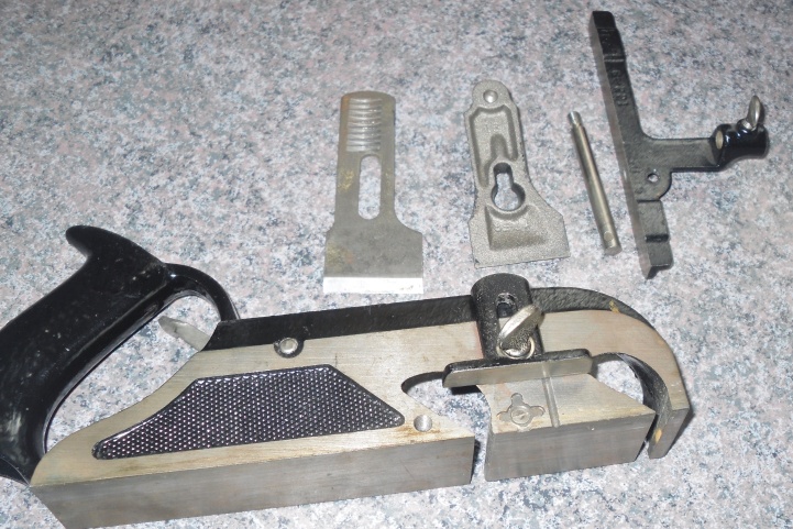

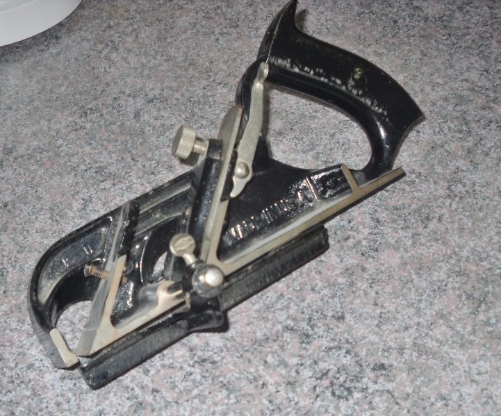

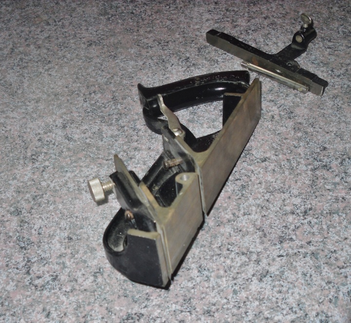

Gene: Here is a little guy, just in from the mail box.ning-sdc14951-14190-64.jpg?width=721This one has all the parts, and is a Stanley made for Wards Master brand.ning-sdc14948-14190-30.jpg?width=721The other side, including the fence. the cutter can be moved to the front spotning-sdc14952-14190-76.jpg?width=721to use as a bullnose plane.   There is a nicker on the other sidening-sdc14951-14190-37.jpg?width=721located right under the depth stop.   One rotates it until it cuts a line, or rotate back to use the plane without the nicker.
Not quite as fancy as yours, though...

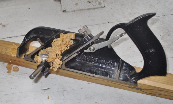

Just got done sharpening the iron a bitning-sdc14954-14189-57.jpg?width=721and this without using the knicker.      That is for going across the grain of a board.  So far, Me likey!
